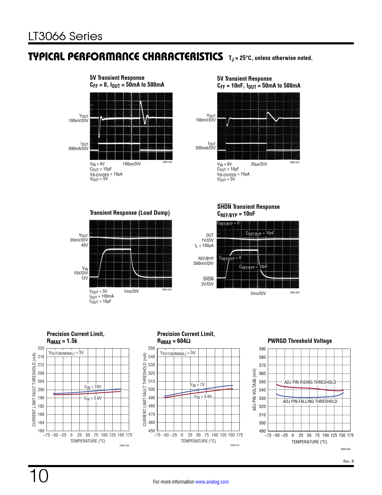

TYPICAL PERFORMANCE CHARACTERISTICS TJ = 25°C, unless otherwise noted. 5V Transient Response. CFF = 0, IOUT = 50mA to 500mA
TYPICAL PERFORMANCE CHARACTERISTICS TJ = 25°C, unless otherwise noted 5V Transient Response CFF = 0, IOUT = 50mA to 500mA
LT3066 Series
TYPICAL PERFORMANCE CHARACTERISTICS TJ = 25°C, unless otherwise noted. 5V Transient Response 5V Transient Response CFF = 0, IOUT = 50mA to 500mA CFF = 10nF, IOUT = 50mA to 500mA
VOUT VOUT 100mV/DIV 100mV/DIV IOUT IOUT 500mA/DIV 500mA/DIV V 3066 G42 3066 G43 IN = 6V 100µs/DIV VIN = 6V 20µs/DIV COUT = 10µF COUT = 10µF IFB-DIVIDER = 10µA IFB-DIVIDER = 10µA VOUT = 5V VOUT = 5V
SHDN Transient Response Transient Response (Load Dump) CREF/BYP = 10nF
CREF/BYP = 0 V C OUT OUT REF/BYP = 10nF 20mV/DIV 1V/DIV 45V IL = 100μA REF/BYP CREF/BYP = 0 500mV/DIV V C IN REF/BYP = 10nF 10V/DIV 12V SHDN 2V/DIV V 3066 G44 OUT = 5V 1ms/DIV 2ms/DIV 3066 G45 IOUT = 100mA COUT = 10µF
Precision Current Limit, Precision Current Limit, IMAX R = 1.5k IMAX R = 604Ω PWRGD Threshold Voltage
220 550 590 VOUT(NOMINAL) = 5V VOUT(NOMINAL) = 5V 216 540 580 212 530 570 208 520 560 204 510 550 ADJ PIN RISING THRESHOLD T THRESHOLD (mA) V V IN = 10V IN = 7V T THRESHOLD (mA) 200 500 540 AUL AUL 196 V V IN = 5.6V 490 IN = 5.6V 530 ADJ PIN FALLING THRESHOLD 192 480 ADJ PIN VOLTAGE (mV) 520 188 470 510 184 CURRENT LIMIT F 460 CURRENT LIMIT F 500 180 450 490 –75 –50 –25 0 25 50 75 100 125 150 175 –75 –50 –25 0 25 50 75 100 125 150 175 –75 –50 –25 0 25 50 75 100 125 150 175 TEMPERATURE (°C) TEMPERATURE (°C) TEMPERATURE (°C) 3066 G46 3066 G47 3066 G48 Rev. B 10 For more information www.analog.com Document Outline Features Applications Typical Application Description Absolute Maximum Ratings Pin Configuration Order Information Electrical Characteristics Typical Performance Characteristics Pin Functions Block Diagram Applications Information Typical Applications Package Description Revision History Typical Application Related Parts
