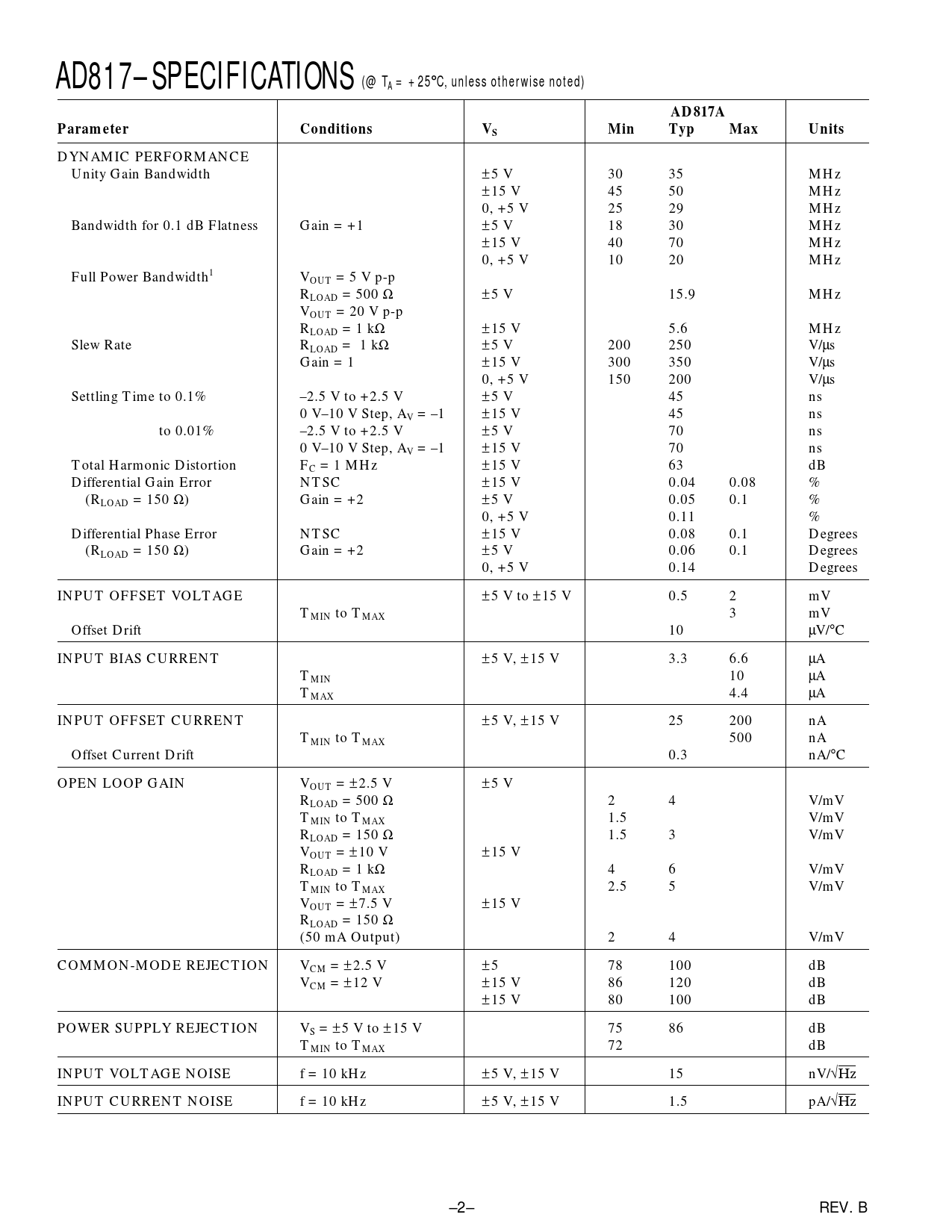

AD817–SPECIFICATIONS (@ TA = +25. C, unless otherwise noted). AD817A. Parameter. Conditions. Min. Typ. Max. Units
AD817–SPECIFICATIONS (@ TA = +25 C, unless otherwise noted) AD817A Parameter Conditions Min Typ Max Units
8
C, unless otherwise noted) AD817A Parameter Conditions VS Min Typ Max Units
DYNAMIC PERFORMANCE Unity Gain Bandwidth ±5 V 30 35 MHz ±15 V 45 50 MHz 0, +5 V 25 29 MHz Bandwidth for 0.1 dB Flatness Gain = +1 ±5 V 18 30 MHz ±15 V 40 70 MHz 0, +5 V 10 20 MHz Full Power Bandwidth1 VOUT = 5 V p-p RLOAD = 500 Ω ±5 V 15.9 MHz VOUT = 20 V p-p RLOAD = 1 kΩ ±15 V 5.6 MHz Slew Rate RLOAD = 1 kΩ ±5 V 200 250 V/µs Gain = 1 ±15 V 300 350 V/µs 0, +5 V 150 200 V/µs Settling Time to 0.1% –2.5 V to +2.5 V ±5 V 45 ns 0 V–10 V Step, AV = –1 ±15 V 45 ns Settling Time to 0.01% –2.5 V to +2.5 V ±5 V 70 ns 0 V–10 V Step, AV = –1 ±15 V 70 ns Total Harmonic Distortion FC = 1 MHz ±15 V 63 dB Differential Gain Error NTSC ±15 V 0.04 0.08 % (RLOAD = 150 Ω) Gain = +2 ±5 V 0.05 0.1 % 0, +5 V 0.11 % Differential Phase Error NTSC ±15 V 0.08 0.1 Degrees (RLOAD = 150 Ω) Gain = +2 ±5 V 0.06 0.1 Degrees 0, +5 V 0.14 Degrees INPUT OFFSET VOLTAGE ±5 V to ±15 V 0.5 2 mV TMIN to TMAX 3 mV Offset Drift 10 µV/°C INPUT BIAS CURRENT ±5 V, ±15 V 3.3 6.6 µA TMIN 10 µA TMAX 4.4 µA INPUT OFFSET CURRENT ±5 V, ±15 V 25 200 nA TMIN to TMAX 500 nA Offset Current Drift 0.3 nA/°C OPEN LOOP GAIN VOUT = ± 2.5 V ±5 V RLOAD = 500 Ω 2 4 V/mV TMIN to TMAX 1.5 V/mV RLOAD = 150 Ω 1.5 3 V/mV VOUT = ± 10 V ±15 V RLOAD = 1 kΩ 4 6 V/mV TMIN to TMAX 2.5 5 V/mV VOUT = ± 7.5 V ±15 V RLOAD = 150 Ω (50 mA Output) 2 4 V/mV COMMON-MODE REJECTION VCM = ± 2.5 V ±5 78 100 dB VCM = ± 12 V ±15 V 86 120 dB ±15 V 80 100 dB POWER SUPPLY REJECTION VS = ± 5 V to ± 15 V 75 86 dB TMIN to TMAX 72 dB INPUT VOLTAGE NOISE f = 10 kHz ±5 V, ±15 V 15 nV/√Hz INPUT CURRENT NOISE f = 10 kHz ±5 V, ±15 V 1.5 pA/√Hz –2– REV. B
