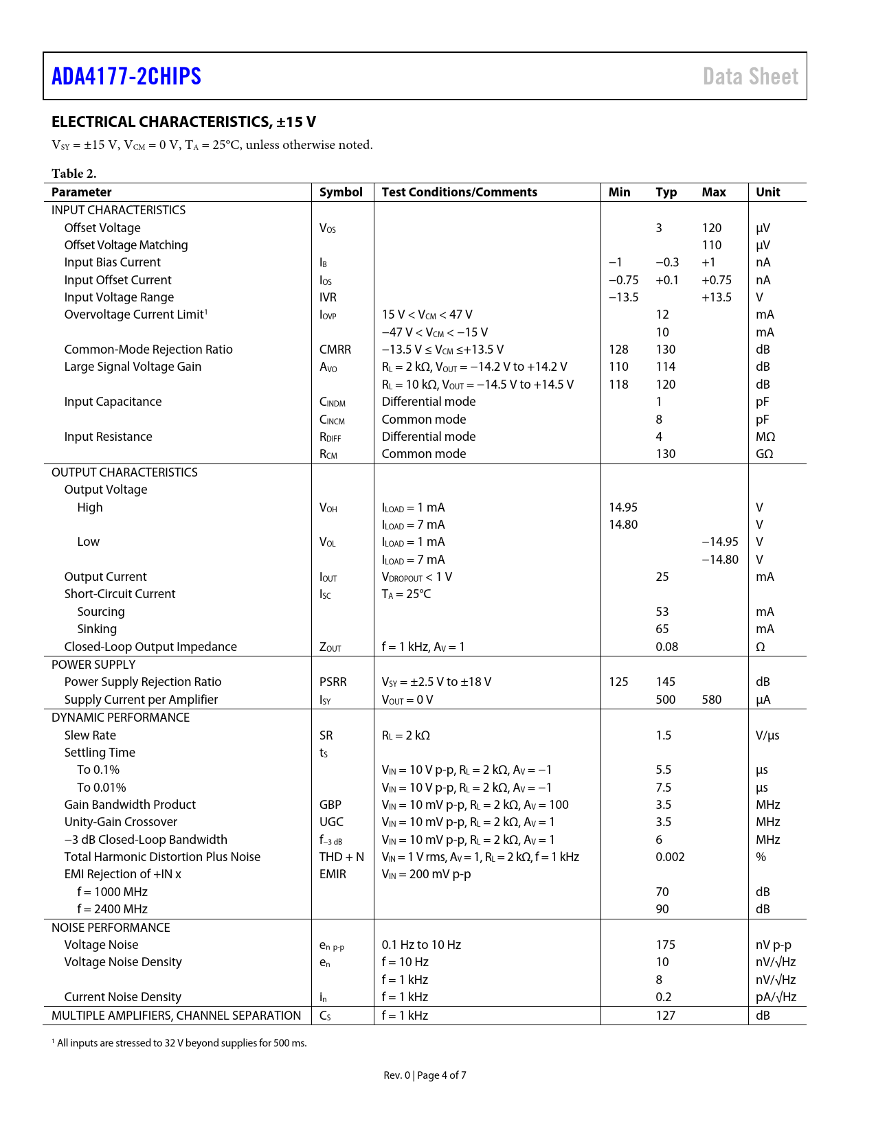

ADA4177-2CHIPS. Data Sheet. ELECTRICAL CHARACTERISTICS, ±15 V. Table 2. Parameter. Symbol. Test Conditions/Comments. Min. Typ. Max. Unit
ADA4177-2CHIPS Data Sheet ELECTRICAL CHARACTERISTICS, ±15 V Table 2 Parameter Symbol Test Conditions/Comments Min Typ Max Unit
VSY = ±15 V, VCM = 0 V, TA = 25°C, unless otherwise noted.
Table 2. Parameter Symbol Test Conditions/Comments Min Typ Max Unit
INPUT CHARACTERISTICS Offset Voltage VOS 3 120 μV Offset Voltage Matching 110 μV Input Bias Current IB −1 −0.3 +1 nA Input Offset Current IOS −0.75 +0.1 +0.75 nA Input Voltage Range IVR −13.5 +13.5 V Overvoltage Current Limit1 IOVP 15 V < VCM < 47 V 12 mA −47 V < VCM < −15 V 10 mA Common-Mode Rejection Ratio CMRR −13.5 V ≤ VCM ≤+13.5 V 128 130 dB Large Signal Voltage Gain AVO RL = 2 kΩ, VOUT = −14.2 V to +14.2 V 110 114 dB RL = 10 kΩ, VOUT = −14.5 V to +14.5 V 118 120 dB Input Capacitance CINDM Differential mode 1 pF CINCM Common mode 8 pF Input Resistance RDIFF Differential mode 4 MΩ RCM Common mode 130 GΩ OUTPUT CHARACTERISTICS Output Voltage High VOH ILOAD = 1 mA 14.95 V ILOAD = 7 mA 14.80 V Low VOL ILOAD = 1 mA −14.95 V ILOAD = 7 mA −14.80 V Output Current IOUT VDROPOUT < 1 V 25 mA Short-Circuit Current ISC TA = 25°C Sourcing 53 mA Sinking 65 mA Closed-Loop Output Impedance ZOUT f = 1 kHz, AV = 1 0.08 Ω POWER SUPPLY Power Supply Rejection Ratio PSRR VSY = ±2.5 V to ±18 V 125 145 dB Supply Current per Amplifier ISY VOUT = 0 V 500 580 μA DYNAMIC PERFORMANCE Slew Rate SR RL = 2 kΩ 1.5 V/μs Settling Time tS To 0.1% VIN = 10 V p-p, RL = 2 kΩ, AV = −1 5.5 μs To 0.01% VIN = 10 V p-p, RL = 2 kΩ, AV = −1 7.5 μs Gain Bandwidth Product GBP VIN = 10 mV p-p, RL = 2 kΩ, AV = 100 3.5 MHz Unity-Gain Crossover UGC VIN = 10 mV p-p, RL = 2 kΩ, AV = 1 3.5 MHz −3 dB Closed-Loop Bandwidth f−3 dB VIN = 10 mV p-p, RL = 2 kΩ, AV = 1 6 MHz Total Harmonic Distortion Plus Noise THD + N VIN = 1 V rms, AV = 1, RL = 2 kΩ, f = 1 kHz 0.002 % EMI Rejection of +IN x EMIR VIN = 200 mV p-p f = 1000 MHz 70 dB f = 2400 MHz 90 dB NOISE PERFORMANCE Voltage Noise en p-p 0.1 Hz to 10 Hz 175 nV p-p Voltage Noise Density en f = 10 Hz 10 nV/√Hz f = 1 kHz 8 nV/√Hz Current Noise Density in f = 1 kHz 0.2 pA/√Hz MULTIPLE AMPLIFIERS, CHANNEL SEPARATION CS f = 1 kHz 127 dB 1 All inputs are stressed to 32 V beyond supplies for 500 ms. Rev. 0 | Page 4 of 7 Document Outline FEATURES APPLICATIONS FUNCTIONAL BLOCK DIAGRAM GENERAL DESCRIPTION TABLE OF CONTENTS REVISION HISTORY SPECIFICATIONS ELECTRICAL CHARACTERISTICS, ±5 V ELECTRICAL CHARACTERISTICS, ±15 V ABSOLUTE MAXIMUM RATINGS ELECTROSTATIC DISCHARGE (ESD) RATINGS ESD Ratings for ADA4177-2CHIPS ESD CAUTION PIN CONFIGURATION AND FUNCTION DESCRIPTION OUTLINE DIMENSIONS DIE SPECIFICATIONS AND ASSEMBLY RECOMMENDATIONS ORDERING GUIDE
