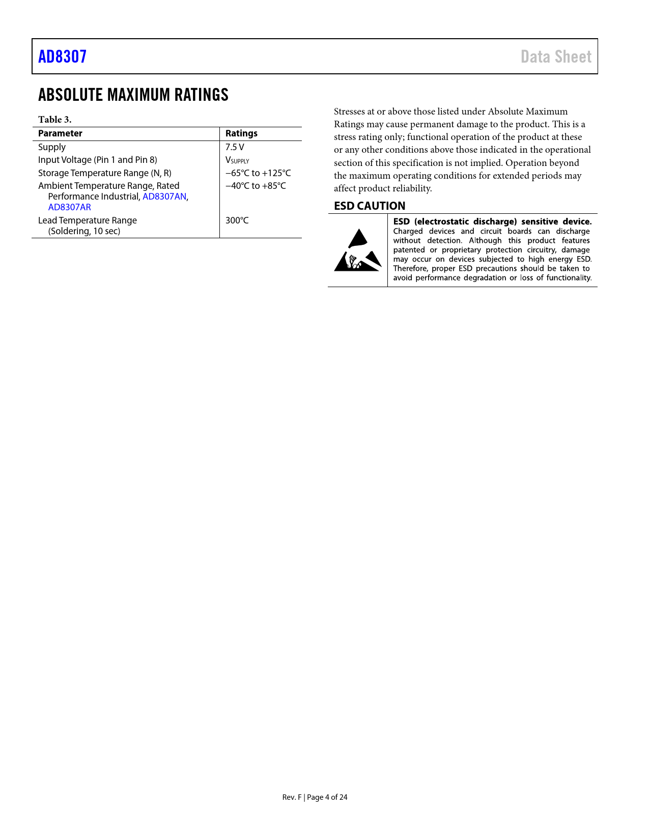

AD8307. Data Sheet. ABSOLUTE MAXIMUM RATINGS. Table 3. Parameter Ratings. ESD CAUTION
AD8307 Data Sheet ABSOLUTE MAXIMUM RATINGS Table 3 Parameter Ratings ESD CAUTION
Stresses at or above those listed under Absolute Maximum
Table 3.
Ratings may cause permanent damage to the product. This is a
Parameter Ratings
stress rating only; functional operation of the product at these Supply 7.5 V or any other conditions above those indicated in the operational Input Voltage (Pin 1 and Pin 8) VSUPPLY section of this specification is not implied. Operation beyond Storage Temperature Range (N, R) −65°C to +125°C the maximum operating conditions for extended periods may Ambient Temperature Range, Rated −40°C to +85°C affect product reliability. Performance Industrial, AD8307AN, AD8307AR
ESD CAUTION
Lead Temperature Range 300°C (Soldering, 10 sec) Rev. F | Page 4 of 24 Document Outline FEATURES APPLICATIONS FUNCTIONAL BLOCK DIAGRAM GENERAL DESCRIPTION TABLE OF CONTENTS REVISION HISTORY SPECIFICATIONS ABSOLUTE MAXIMUM RATINGS ESD CAUTION PIN CONFIGURATION AND FUNCTION DESCRIPTIONS TYPICAL PERFORMANCE CHARACTERISTICS LOG AMP THEORY PROGRESSIVE COMPRESSION DEMODULATING LOG AMPS INTERCEPT CALIBRATION OFFSET CONTROL EXTENSION OF RANGE INTERFACES ENABLE INTERFACE INPUT INTERFACE OFFSET INTERFACE OUTPUT INTERFACE THEORY OF OPERATION BASIC CONNECTIONS INPUT MATCHING NARROW-BAND MATCHING SLOPE AND INTERCEPT ADJUSTMENTS APPLICATIONS INFORMATION BUFFERED OUTPUT FOUR-POLE FILTER 1 µW TO 1 kW 50 Ω POWER METER MEASUREMENT SYSTEM WITH 120 dB DYNAMIC RANGE OPERATION AT LOW FREQUENCIES OUTLINE DIMENSIONS ORDERING GUIDE
