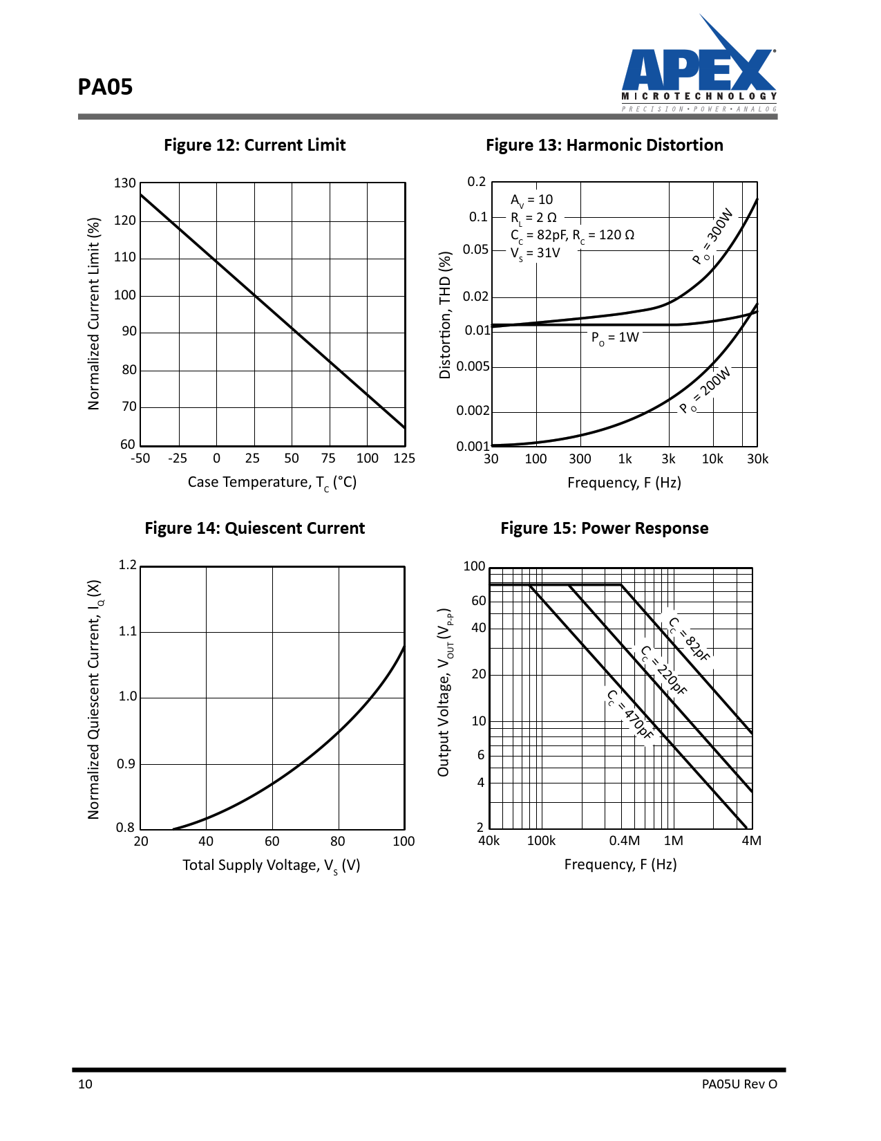

Pages / Page15 / 10 — PA05. Figure 12: Current Limit. Figure 13: Harmonic Distortion. Figure …
File Format / SizePDF / 829 Kb
PA05. Figure 12: Current Limit. Figure 13: Harmonic Distortion. Figure 14: Quiescent Current. Figure 15: Power Response
PA05 Figure 12: Current Limit Figure 13: Harmonic Distortion Figure 14: Quiescent Current Figure 15: Power Response
130 0.2 A = 10 V 120 0.1 R сϮɏ L C = 82pF, R сϭϮϬɏ C C ) 0.05 = 300W 110 V = 31V S P O 100 0.02 90 0.01 P = 1W O 80 0.005 ŝƐƚŽƌƟŽŶ͕d,;й Normalized Current Limit (%) 70 = 200W 0.002 P O 60 0.001 -50 -25 0 25 50 75 100 125 30 100 300 1k 3k 10k 30k Case Temperature, T (°C) Frequency, F (Hz) C
1.2 100 (X) Q 60 ) C P-P 1.1 40 C = 82pF (V C OUT C = 220pF V 20 C 1.0 C = 470pF 10 6 0.9 Output Voltage, 4 Normalized Quiescent Current, I 0.8 2 20 40 60 80 100 40k 100k 0.4M 1M 4M Total Supply Voltage, V (V) Frequency, F (Hz) S 10 PA05U Rev O Document Outline PA05 Features Applications Description Figure 1: Equivalent Schematic Typical Connection Figure 2: Typical Connections Pinout and Description Table Figure 3: External Connections Specifications Absolute Maximum Ratings Input Gain Output Power Supply Thermal Typical Performance Graphs SAFE OPERATING AREA (SOA) 1. The current handling capability of the MOSFET geometry and the wire bonds. 2. The junction temperature of the output MOSFETs. Figure 16: SOA General Typical Application Figure 17: Typical Application Phase Compensation Current Limit Figure 18: Current Limit Shutdown Operation Figure 19: Shutdown Operation Boost Operation Compensation Package Design Package Style CR
