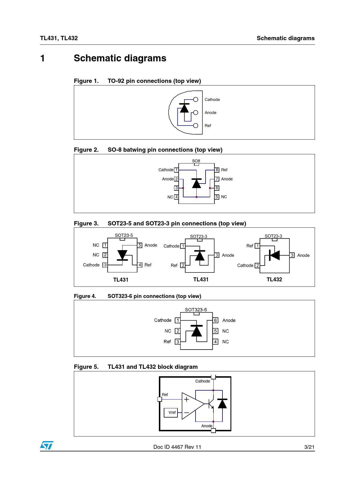

TL431, TL432. Schematic diagrams. 1 Schematic. diagrams. Figure 1. TO-92 pin connections (top view). Figure 2
TL431, TL432 Schematic diagrams 1 Schematic diagrams Figure 1 TO-92 pin connections (top view) Figure 2
TL431, TL432 Schematic diagrams 1 Schematic diagrams Figure 1. TO-92 pin connections (top view) Figure 2. SO-8 batwing pin connections (top view)
SO8 Cathode 1 8 Ref Anode 2 7 Anode 3 6 NC 4 5 NC
Figure 3. SOT23-5 and SOT23-3 pin connections (top view)
SOT23-5 SOT23-3 NC 1 5 Anode Cathode 1 NC 2 Cathode 3 4 Ref Ref 2 3 Anode
TL431 TL431 TL432 Figure 4. SOT323-6 pin connections (top view) Figure 5. TL431 and TL432 block diagram
