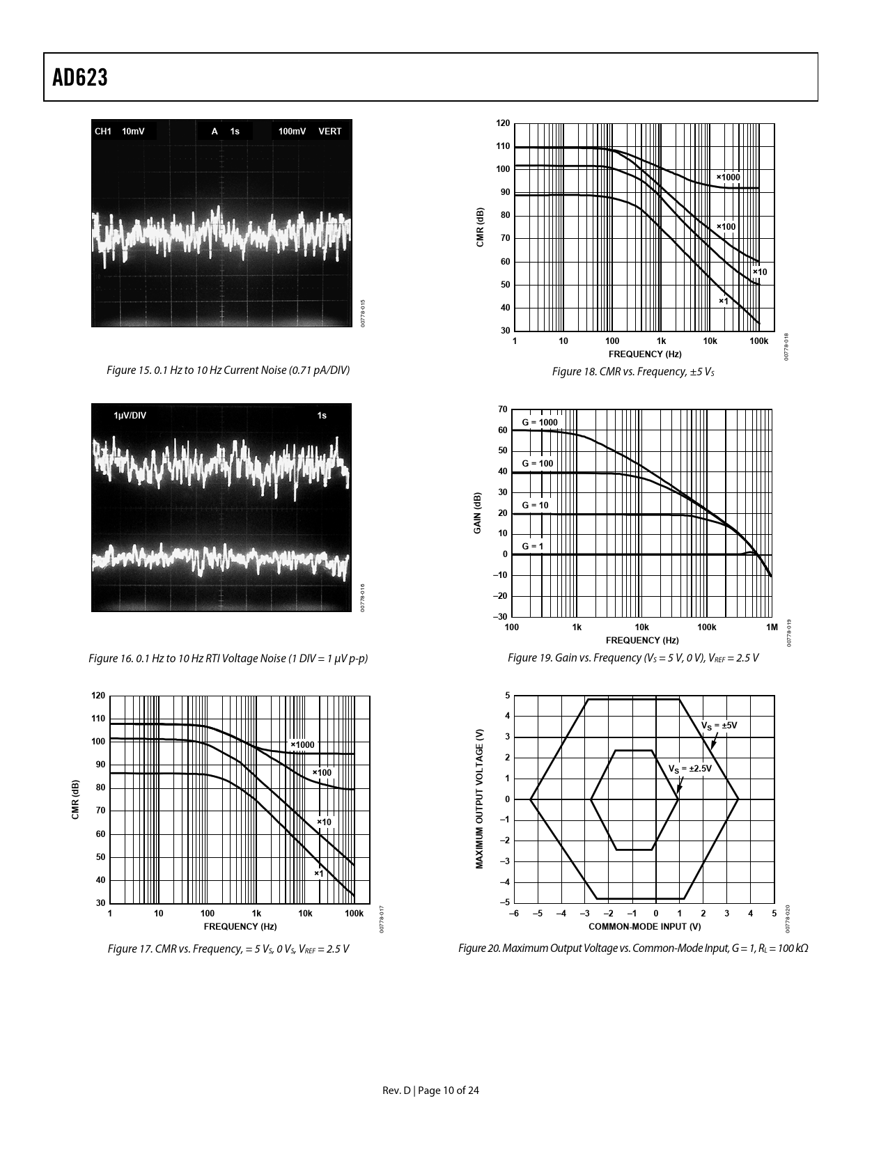

AD623. 120. CH1 10mV. A 1s. 100mV VERT. 110. 100. ×1000. d ( R. ×100. ×10. 10k. 100k. FREQUENCY (Hz). 1µV/DIV. G = 1000. G = 100. B d (. G = 10. IN GA. G = 1

77 00 Figure 15. 0.1 Hz to 10 Hz Current Noise (0.71 pA/DIV) Figure 18. CMR vs. Frequency, ±5 VS
70 1µV/DIV 1s G = 1000 60 50 G = 100 40 ) 30 B d ( G = 10 20 IN GA 10 G = 1 0 –10

77 00 Figure 16. 0.1 Hz to 10 Hz RTI Voltage Noise (1 DIV = 1 μV p-p) Figure 19. Gain vs. Frequency (VS = 5 V, 0 V), VREF = 2.5 V
120 5 110 4 ) VS = ±5V V 100 3 ×1000 E ( G A 2 90 T ×100 L VS = ±2.5V 1 B) 80 VO d T ( R 0 70 TPU CM U ×10 –1 60 M O –2 50 XIMU –3 MA ×1 40 –4 30 –5 1 10 100 1k 10k 100k

77 00 00 Figure 17. CMR vs. Frequency, = 5 VS, 0 VS, VREF = 2.5 V Figure 20. Maximum Output Voltage vs. Common-Mode Input, G = 1, RL = 100 kΩ Rev. D | Page 10 of 24 Document Outline FEATURES APPLICATIONS GENERAL DESCRIPTION CONNECTION DIAGRAM TABLE OF CONTENTS REVISION HISTORY SPECIFICATIONS SINGLE SUPPLY DUAL SUPPLIES BOTH DUAL AND SINGLE SUPPLIES ABSOLUTE MAXIMUM RATINGS ESD CAUTION TYPICAL PERFORMANCE CHARACTERISTICS THEORY OF OPERATION APPLICATIONS INFORMATION BASIC CONNECTION GAIN SELECTION REFERENCE TERMINAL INPUT AND OUTPUT OFFSET VOLTAGE INPUT PROTECTION RF INTERFERENCE GROUNDING Ground Returns for Input Bias Currents Output Buffering Single-Supply Data Acquisition System Amplifying Signals with Low Common-Mode Voltage INPUT DIFFERENTIAL AND COMMON-MODE RANGE vs. SUPPLY AND GAIN OUTLINE DIMENSIONS ORDERING GUIDE
