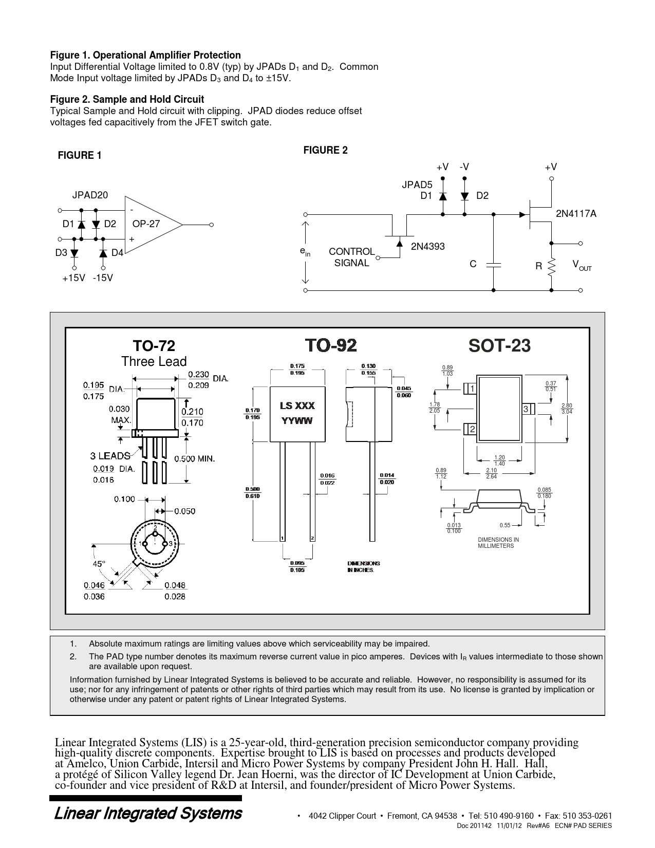

Figure 1. Operational Amplifier Protection. Figure 2. Sample and Hold Circuit. FIGURE 2. FIGURE 1. TO-72. SOT-23
Figure 1 Operational Amplifier Protection Figure 2 Sample and Hold Circuit FIGURE 2 FIGURE 1 TO-72 SOT-23
Input Differential Voltage limited to 0.8V (typ) by JPADs D1 and D2. Common Mode Input voltage limited by JPADs D3 and D4 to ±15V.
Typical Sample and Hold circuit with clipping. JPAD diodes reduce offset voltages fed capacitively from the JFET switch gate.
FIGURE 2 FIGURE 1
+V -V +V JPAD5 JPAD20 D1 D2 - 2N4117A D1 D2 OP-27 + 2N4393 D3 D4 ein CONTROL SIGNAL C R VOUT +15V -15V
