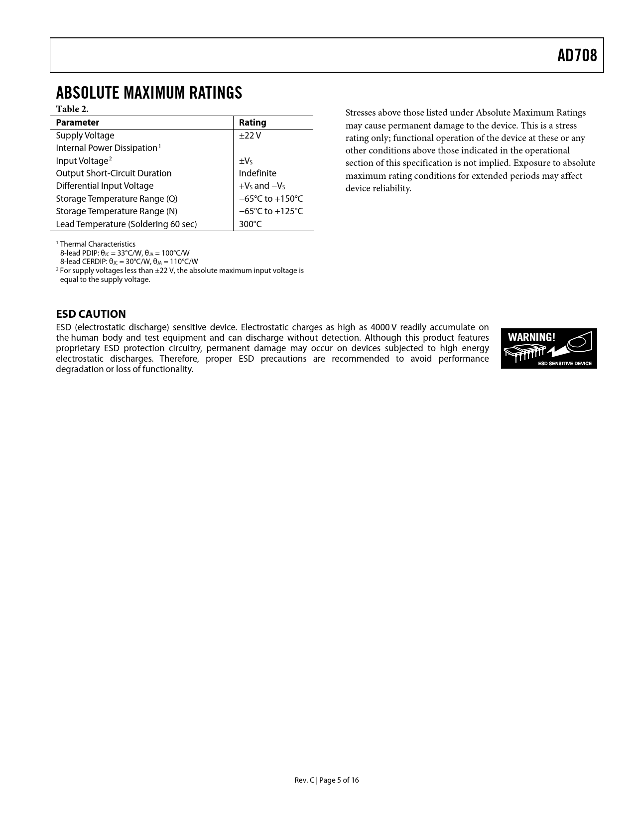

AD708 ABSOLUTE MAXIMUM RATINGS Table 2.
Stresses above those listed under Absolute Maximum Ratings
Parameter Rating
may cause permanent damage to the device. This is a stress Supply Voltage ±22 V rating only; functional operation of the device at these or any Internal Power Dissipation1 other conditions above those indicated in the operational Input Voltage2 ±VS section of this specification is not implied. Exposure to absolute Output Short-Circuit Duration Indefinite maximum rating conditions for extended periods may affect Differential Input Voltage +VS and −VS device reliability. Storage Temperature Range (Q) −65°C to +150°C Storage Temperature Range (N) −65°C to +125°C Lead Temperature (Soldering 60 sec) 300°C 1 Thermal Characteristics 8-lead PDIP: θJC = 33°C/W, θJA = 100°C/W 8-lead CERDIP: θJC = 30°C/W, θJA = 110°C/W 2 For supply voltages less than ±22 V, the absolute maximum input voltage is equal to the supply voltage.
ESD CAUTION
ESD (electrostatic discharge) sensitive device. Electrostatic charges as high as 4000 V readily accumulate on the human body and test equipment and can discharge without detection. Although this product features proprietary ESD protection circuitry, permanent damage may occur on devices subjected to high energy electrostatic discharges. Therefore, proper ESD precautions are recommended to avoid performance degradation or loss of functionality. Rev. C | Page 5 of 16 Document Outline FEATURES PIN CONFIGURATION GENERAL DESCRIPTION PRODUCT HIGHLIGHTS TABLE OF CONTENTS REVISION HISTORY SPECIFICATIONS ABSOLUTE MAXIMUM RATINGS ESD CAUTION TYPICAL PERFORMANCE CHARACTERISTICS THEORY OF OPERATION CROSSTALK PERFORMANCE OPERATION WITH A GAIN OF −100 HIGH PRECISION PROGRAMMABLE GAIN AMPLIFIER BRIDGE SIGNAL CONDITIONER PRECISION ABSOLUTE VALUE CIRCUIT SELECTION OF PASSIVE COMPONENTS OUTLINE DIMENSIONS ORDERING GUIDE
