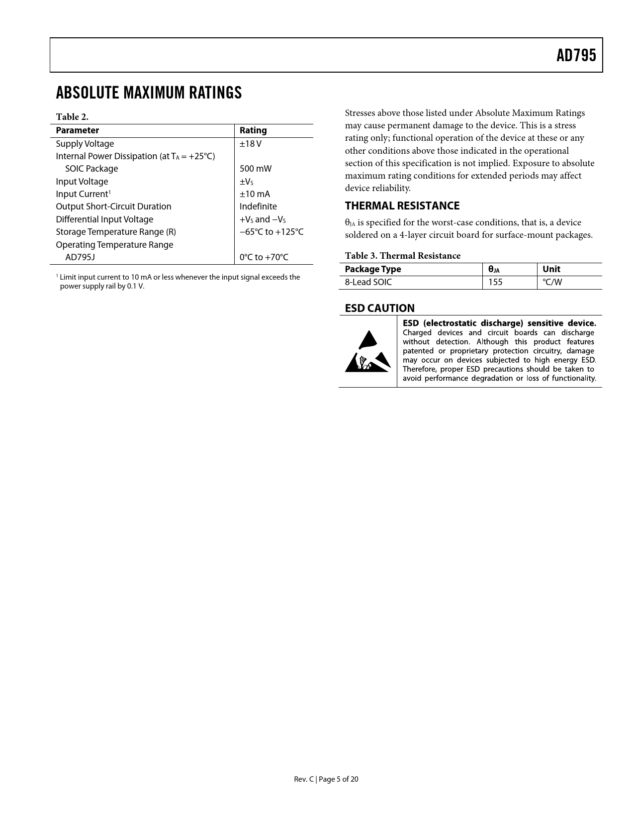

AD795. ABSOLUTE MAXIMUM RATINGS. Table 2. Parameter Rating. THERMAL RESISTANCE. Table 3. Thermal Resistance. Package Type. θJA Unit
AD795 ABSOLUTE MAXIMUM RATINGS Table 2 Parameter Rating THERMAL RESISTANCE Table 3 Thermal Resistance Package Type θJA Unit
link to page 6
AD795 ABSOLUTE MAXIMUM RATINGS Table 2.
Stresses above those listed under Absolute Maximum Ratings may cause permanent damage to the device. This is a stress
Parameter Rating
rating only; functional operation of the device at these or any Supply Voltage ±18 V other conditions above those indicated in the operational Internal Power Dissipation (at TA = +25°C) section of this specification is not implied. Exposure to absolute SOIC Package 500 mW maximum rating conditions for extended periods may affect Input Voltage ±VS device reliability. Input Current1 ±10 mA Output Short-Circuit Duration Indefinite
THERMAL RESISTANCE
Differential Input Voltage +VS and −VS θJA is specified for the worst-case conditions, that is, a device Storage Temperature Range (R) −65°C to +125°C soldered on a 4-layer circuit board for surface-mount packages. Operating Temperature Range AD795J 0°C to +70°C
Table 3. Thermal Resistance Package Type θJA Unit
1 Limit input current to 10 mA or less whenever the input signal exceeds the 8-Lead SOIC 155 °C/W power supply rail by 0.1 V.
