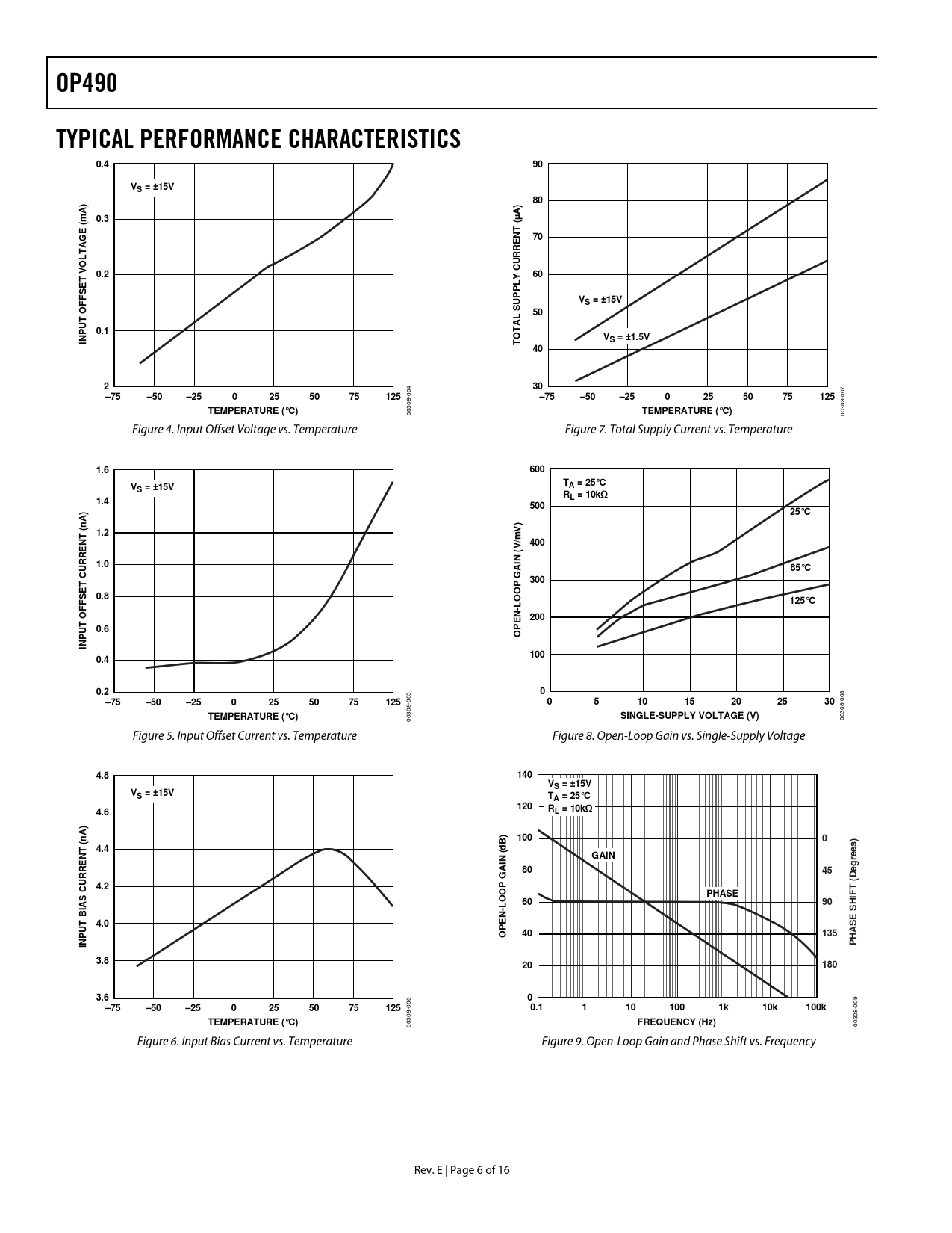

OP490. TYPICAL PERFORMANCE CHARACTERISTICS. 0.4. VS = ±15V. 0.3. E G. A T L O. URRE. 0.2. F F. 0.1. T O. S = ±1.5V. –75. –50. –25. 125. TEMPERATURE (°C)

00 Figure 4. Input Offset Voltage vs. Temperature Figure 7. Total Supply Current vs. Temperature

00 00 Figure 5. Input Offset Current vs. Temperature Figure 8. Open-Loop Gain vs. Single-Supply Voltage

00 00 Figure 6. Input Bias Current vs. Temperature Figure 9. Open-Loop Gain and Phase Shift vs. Frequency Rev. E | Page 6 of 16 Document Outline FEATURES GENERAL DESCRIPTION FUNCTIONAL BLOCK DIAGRAMS TABLE OF CONTENTS REVISION HISTORY SPECIFICATIONS ELECTRICAL CHARACTERISTICS ABSOLUTE MAXIMUM RATINGS THERMAL RESISTANCE ESD CAUTION TYPICAL PERFORMANCE CHARACTERISTICS APPLICATIONS INFORMATION BATTERY-POWERED APPLICATIONS SINGLE-SUPPLY OUTPUT VOLTAGE RANGE INPUT VOLTAGE PROTECTION MICROPOWER VOLTAGE-CONTROLLED OSCILLATOR MICROPOWER SINGLE-SUPPLY QUAD VOLTAGE-OUTPUT 8-BIT DAC HIGH OUTPUT AMPLIFIER SINGLE-SUPPLY MICROPOWER QUAD PROGRAMMABLE GAIN AMPLIFIER OUTLINE DIMENSIONS ORDERING GUIDE
