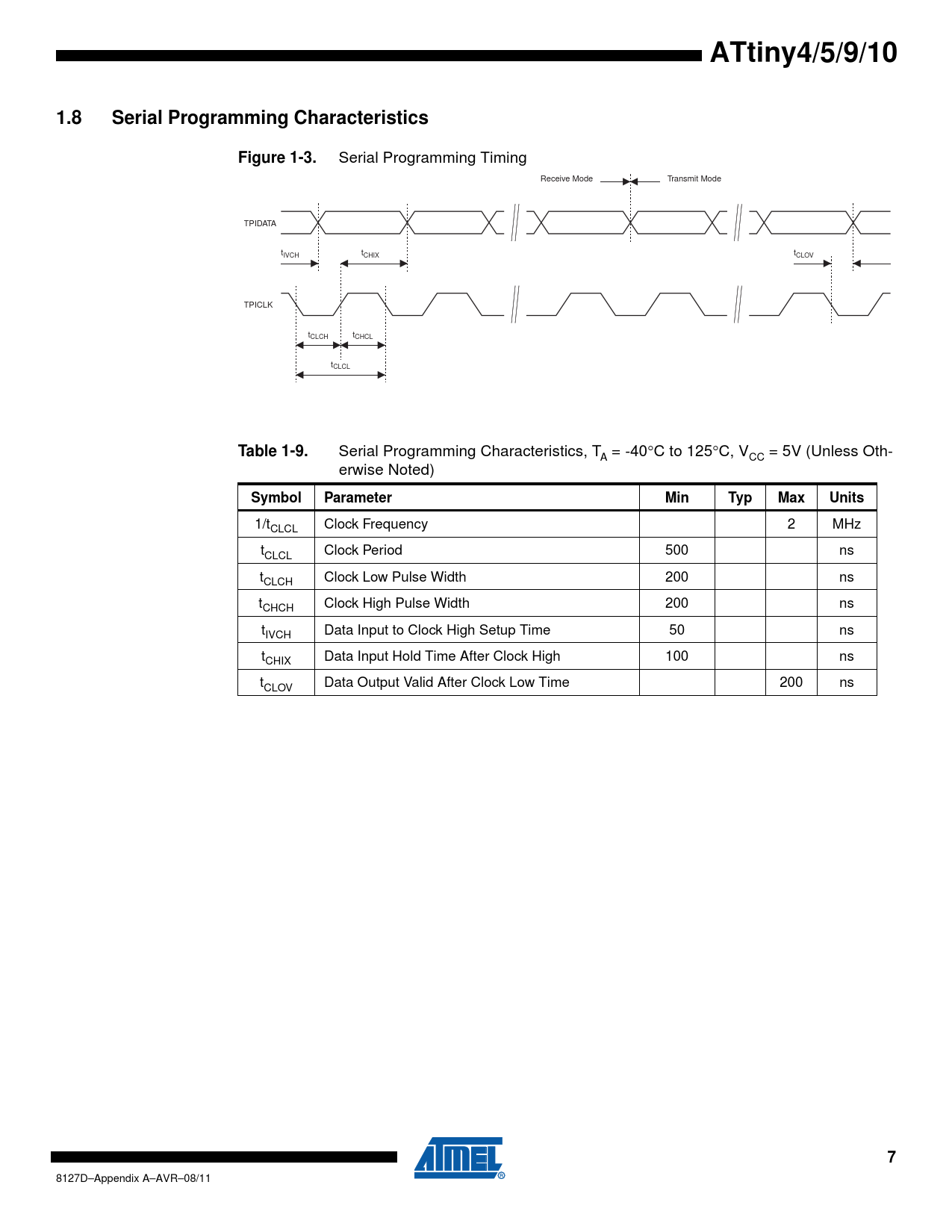

ATtiny4/5/9/10. 1.8. Serial Programming Characteristics. Figure 1-3. Table 1-9. Symbol. Parameter. Min. Typ. Max. Units
ATtiny4/5/9/10 1.8 Serial Programming Characteristics Figure 1-3 Table 1-9 Symbol Parameter Min Typ Max Units
ATtiny4/5/9/10 1.8 Serial Programming Characteristics Figure 1-3.
Serial Programming Timing Receive Mode Transmit Mode TPIDATA t t IVCH CHIX tCLOV TPICLK t t CLCH CHCL tCLCL
Table 1-9.
Serial Programming Characteristics, T = -40°C to 125°C, V = 5V (Unless Oth- A CC erwise Noted)
1/tCLCL Clock Frequency 2 MHz tCLCL Clock Period 500 ns tCLCH Clock Low Pulse Width 200 ns tCHCH Clock High Pulse Width 200 ns tIVCH Data Input to Clock High Setup Time 50 ns tCHIX Data Input Hold Time After Clock High 100 ns tCLOV Data Output Valid After Clock Low Time 200 ns
