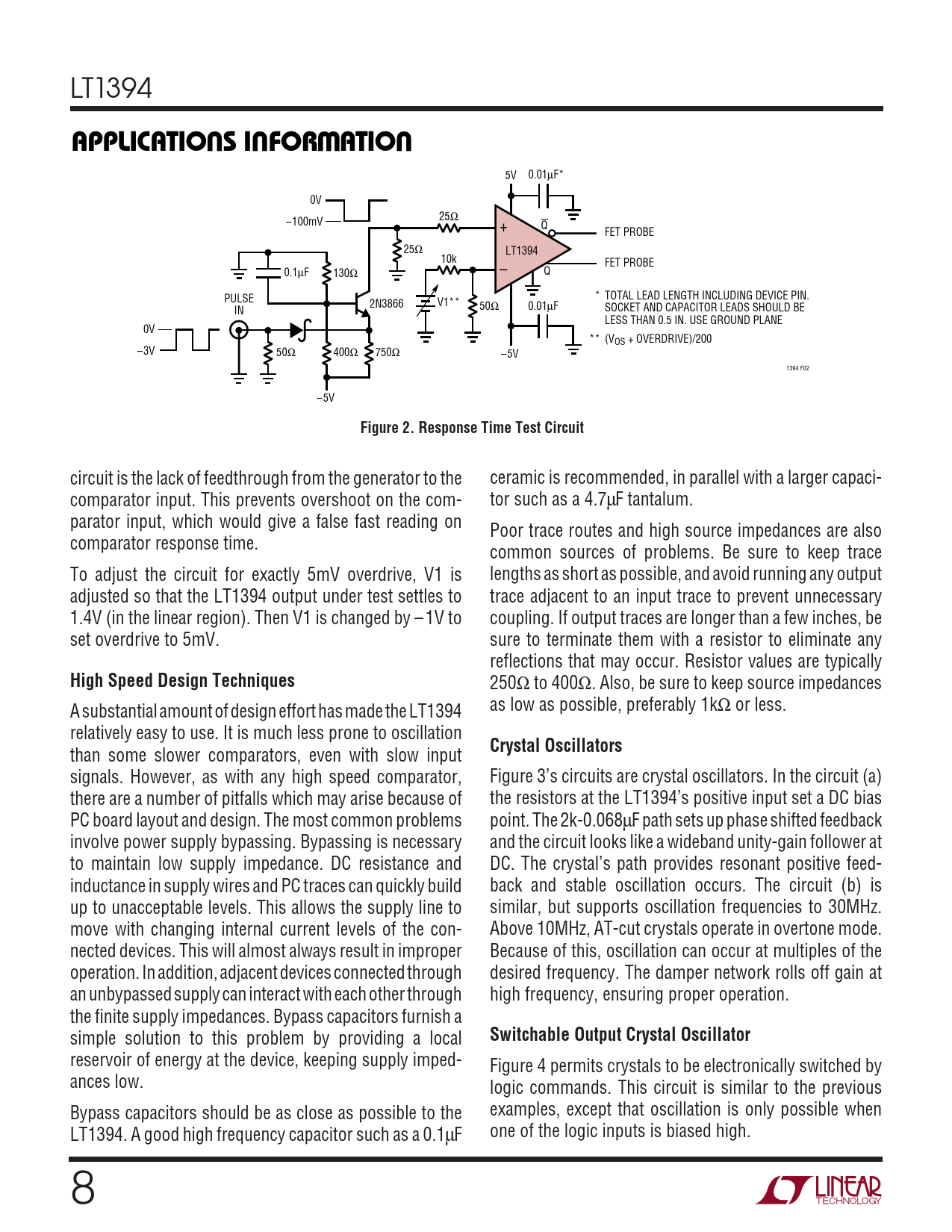

5V 0.01µF* 0V 25Ω –100mV + Q FET PROBE 25Ω LT1394 10k 0.1µF 130Ω – FET PROBE Q * TOTAL LEAD LENGTH INCLUDING DEVICE PIN. PULSE 2N3866 V1** 50Ω 0.01µF SOCKET AND CAPACITOR LEADS SHOULD BE IN LESS THAN 0.5 IN. USE GROUND PLANE 0V ** (VOS + OVERDRIVE)/200 –3V 50Ω 400Ω 750Ω –5V 1394 F02 –5V
Figure 2. Response Time Test Circuit
circuit is the lack of feedthrough from the generator to the ceramic is recommended, in parallel with a larger capaci- comparator input. This prevents overshoot on the com- tor such as a 4.7µF tantalum. parator input, which would give a false fast reading on Poor trace routes and high source impedances are also comparator response time. common sources of problems. Be sure to keep trace To adjust the circuit for exactly 5mV overdrive, V1 is lengths as short as possible, and avoid running any output adjusted so that the LT1394 output under test settles to trace adjacent to an input trace to prevent unnecessary 1.4V (in the linear region). Then V1 is changed by – 1V to coupling. If output traces are longer than a few inches, be set overdrive to 5mV. sure to terminate them with a resistor to eliminate any reflections that may occur. Resistor values are typically
