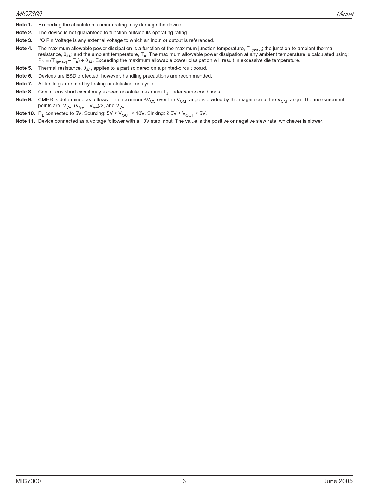

Note 1.
Exceeding the absolute maximum rating may damage the device.
Note 2.
The device is not guaranteed to function outside its operating rating.
Note 3.
I/O Pin Voltage is any external voltage to which an input or output is referenced.
Note 4.
The maximum allowable power dissipation is a function of the maximum junction temperature, T ; the junction-to-ambient thermal J(max) resistance, θ ; and the ambient temperature, T . The maximum allowable power dissipation at any ambient temperature is calculated using: JA A P = (T – T ) ÷ θ . Exceeding the maximum allowable power dissipation will result in excessive die temperature. D J(max) A JA
Note 5.
Thermal resistance, θ , applies to a part soldered on a printed-circuit board. JA
Note 6.
Devices are ESD protected; however, handling precautions are recommended.
Note 7.
All limits guaranteed by testing or statistical analysis.
Note 8.
Continuous short circuit may exceed absolute maximum T under some conditions. J
Note 9.
CMRR is determined as follows: The maximum ∆V over the V range is divided by the magnitude of the V range. The measurement OS CM CM points are: V , (V – V )/2, and V . V– V+ V– V+
Note 10.
R connected to 5V. Sourcing: 5V ≤ V ≤ 10V. Sinking: 2.5V ≤ V ≤ 5V. L OUT OUT
Note 11.
Device connected as a voltage follower with a 10V step input. The value is the positive or negative slew rate, whichever is slower. MIC7300 6 June 2005
