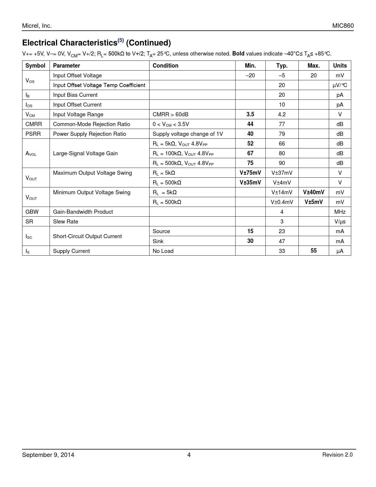

V+= +5V, V–= 0V, VCM= V+/2; RL= 500kΩ to V+/2; TA= 25°C, unless otherwise noted. Bold values indicate –40°C≤ TA≤ +85°C.
Symbol
VOS Parameter Condition Input Offset Voltage Min. Typ. Max. Units –20 –5 20 mV Input Offset Voltage Temp Coefficient 20 µV/°C IB Input Bias Current 20 pA IOS Input Offset Current 10 pA VCM Input Voltage Range CMRR > 60dB 3.5 4.2 V CMRR Common-Mode Rejection Ratio 0 < VCM < 3.5V 44 77 dB PSRR Power Supply Rejection Ratio Supply voltage change of 1V 40 79 dB RL = 5kΩ, VOUT 4.8VPP 52 66 dB RL = 100kΩ, VOUT 4.8VPP 67 80 dB RL = 500kΩ, VOUT 4.8VPP 75 90 dB RL = 5kΩ V±75mV V±37mV V RL = 500kΩ V±35mV V±4mV V AVOL VOUT VOUT Large-Signal Voltage Gain Maximum Output Voltage Swing Minimum Output Voltage Swing RL = 5kΩ V±14mV V±40mV RL = 500kΩ V±0.4mV V±5mV mV
