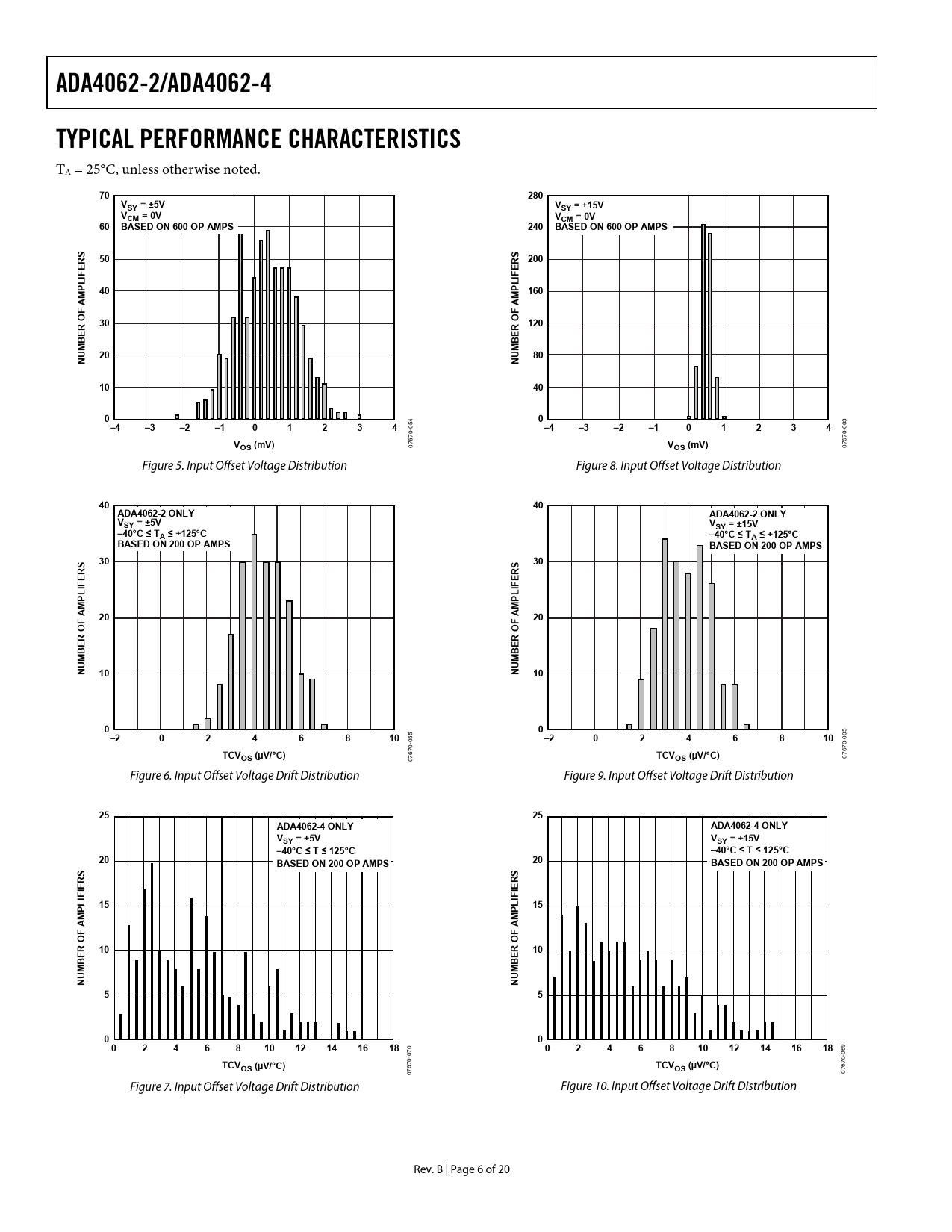

ADA4062-2/ADA4062-4. TYPICAL PERFORMANCE CHARACTERISTICS. 280. VSY = ±5V. VSY = ±15V. VCM = 0V. BASED ON 600 OP AMPS. 240. RS 200. P 160
ADA4062-2/ADA4062-4 TYPICAL PERFORMANCE CHARACTERISTICS 280 VSY = ±5V VSY = ±15V VCM = 0V BASED ON 600 OP AMPS 240 RS 200 P 160
TA = 25°C, unless otherwise noted.
70 280 VSY = ±5V VSY = ±15V VCM = 0V VCM = 0V 60 BASED ON 600 OP AMPS 240 BASED ON 600 OP AMPS RS 50 RS 200 E E IF IF L L P 40 P 160 AM AM F F O 30 O R 120 R BE BE 20 80 NUM NUM 10 40 0
4
0
3
–4 –3 –2 –1 0 1 2 3 4
05
00 0- 0- 67
V
67 07
OS (mV) V
07
OS (mV)
Figure 5. Input Offset Voltage Distribution Figure 8. Input Offset Voltage Distribution
40 40 ADA4062-2 ONLY ADA4062-2 ONLY VSY = ±5V VSY = ±15V –40°C ≤ TA ≤ +125°C –40°C ≤ TA ≤ +125°C BASED ON 200 OP AMPS BASED ON 200 OP AMPS 30 S 30 S R R E E IF IF L L P P AM 20 AM F 20 F R O R O BE BE NUM 10 NUM 10 0 0
5
–2 0 2 4 6 8 10
5
–2 0 2 4 6 8 10
00 -05 0- 70
TCV
67
OS (µV/°C) TCV
07 076
OS (µV/°C)
Figure 6. Input Offset Voltage Drift Distribution Figure 9. Input Offset Voltage Drift Distribution
25 25 ADA4062-4 ONLY ADA4062-4 ONLY VSY = ±5V VSY = ±15V –40°C ≤ T ≤ 125°C –40°C ≤ T ≤ 125°C 20 BASED ON 200 OP AMPS 20 BASED ON 200 OP AMPS RS RS IE IE IF IF L 15 L P 15 P AM AM F F O R 10 R O 10 BE BE NUM NUM 5 5 0 0 0 2 4 6 8 10 12 14 16 18
9 70
0 06 0- 0-
TCV
67
OS (µV/°C)
67
TCVOS (µV/°C)
07 07 Figure 7. Input Offset Voltage Drift Distribution Figure 10. Input Offset Voltage Drift Distribution Rev. B | Page 6 of 20 Document Outline FEATURES APPLICATIONS GENERAL DESCRIPTION PIN CONFIGURATIONS TABLE OF CONTENTS REVISION HISTORY SPECIFICATIONS ELECTRICAL CHARACTERISTICS ABSOLUTE MAXIMUM RATINGS THERMAL RESISTANCE POWER SEQUENCING ESD CAUTION TYPICAL PERFORMANCE CHARACTERISTICS APPLICATIONS INFORMATION NOTCH FILTER HIGH-SIDE SIGNAL CONDITIONING MICROPOWER INSTRUMENTATION AMPLIFIER PHASE REVERSAL SCHEMATIC OUTLINE DIMENSIONS ORDERING GUIDE
