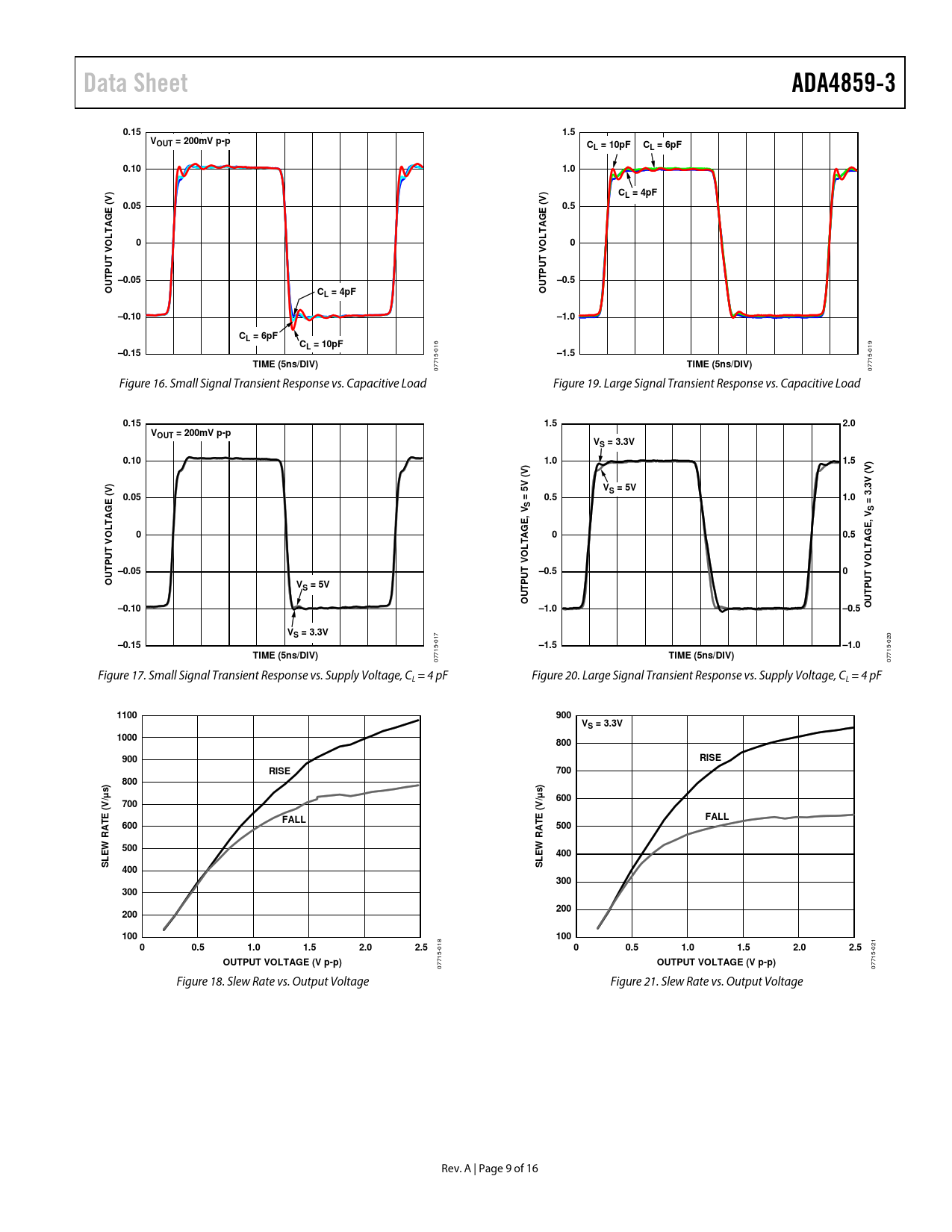

Data Sheet. ADA4859-3. 0.15. 1.5. VOUT = 200mV p-p. L = 10pF. L = 6pF. 0.10. 1.0. L = 4pF. 0.05. 0.5. OLTA. T V. TP –0.05. –0.5. –0.10. –1.0. CL = 6pF
Data Sheet ADA4859-3 0.15 1.5 VOUT = 200mV p-p L = 10pF L = 6pF 0.10 1.0 L = 4pF 0.05 0.5 OLTA T V TP –0.05 –0.5 –0.10 –1.0 CL = 6pF
Data Sheet ADA4859-3 0.15 1.5 VOUT = 200mV p-p C C L = 10pF L = 6pF 0.10 1.0 ) ) C V V L = 4pF ( 0.05 ( 0.5 GE GE OLTA 0 OLTA 0 T V T V U U TP –0.05 TP –0.5 OU C OU L = 4pF –0.10 –1.0 CL = 6pF CL = 10pF –0.15

07715- 07715- Figure 16. Smal Signal Transient Response vs. Capacitive Load Figure 19. Large Signal Transient Response vs. Capacitive Load
0.15 1.5 2.0 VOUT = 200mV p-p VS = 3.3V 0.10 1.0 1.5 V (V) ) V (V) V 5 V .3 S = 5V ( 0.05 = 0.5 1.0 3 S = GE S , V , V GE OLTA 0 0 0.5 GE T V U OLTA OLTA TP –0.05 T V –0.5 0 U T V OU U VS = 5V TP TP OU –0.10 –1.0 –0.5 OU VS = 3.3V

07715- 07715- Figure 17. Small Signal Transient Response vs. Supply Voltage, CL = 4 pF Figure 20. Large Signal Transient Response vs. Supply Voltage, CL = 4 pF
1100 900 VS = 3.3V 1000 800 900 RISE RISE 700 800 ) ) s s µ µ 600 700 E (V/ E (V/ FALL T FALL 600 T A 500 A R R 500 EW EW 400 SL SL 400 300 300 200 200 100 100 0 0.5 1.0 1.5 2.0 2.5

07715- 07715- Figure 18. Slew Rate vs. Output Voltage Figure 21. Slew Rate vs. Output Voltage Rev. A | Page 9 of 16 Document Outline Features Applications General Description Connection Diagram Table of Contents Revision History Specifications Absolute Maximum Ratings Maximum Power Dissipation ESD Caution Pin Configuration and Function Descriptions Typical Performance Characteristics Theory of Operation Overview Charge Pump Operation Applications Information Using the ADA4859-3 in Gains Equal to +1, −1 Unity-Gain Operation Option 1 Option 2 Inverting Unity-Gain Operation Video Line Driver Power-Down Layout Considerations Power Supply Bypassing Outline Dimensions Ordering Guide
