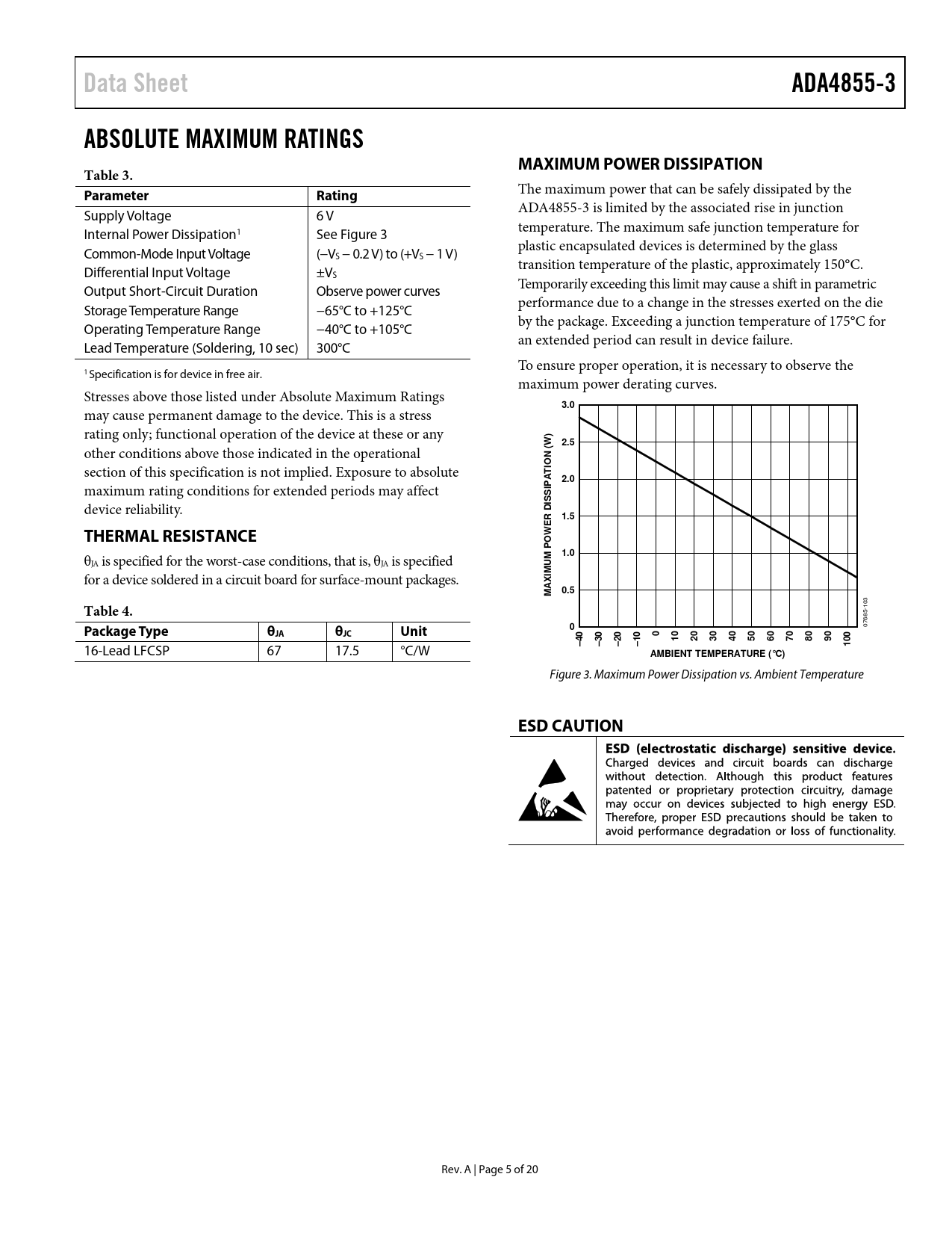

Data Sheet ADA4855-3 ABSOLUTE MAXIMUM RATINGS MAXIMUM POWER DISSIPATION Table 3. Parameter Rating
The maximum power that can be safely dissipated by the Supply Voltage 6 V ADA4855-3 is limited by the associated rise in junction Internal Power Dissipation1 See Figure 3 temperature. The maximum safe junction temperature for Common-Mode Input Voltage (−V plastic encapsulated devices is determined by the glass S − 0.2 V) to (+VS − 1 V) Differential Input Voltage ±V transition temperature of the plastic, approximately 150°C. S Output Short-Circuit Duration Observe power curves Temporarily exceeding this limit may cause a shift in parametric Storage Temperature Range −65°C to +125°C performance due to a change in the stresses exerted on the die Operating Temperature Range −40°C to +105°C by the package. Exceeding a junction temperature of 175°C for Lead Temperature (Soldering, 10 sec) 300°C an extended period can result in device failure. To ensure proper operation, it is necessary to observe the 1 Specification is for device in free air. maximum power derating curves. Stresses above those listed under Absolute Maximum Ratings
3.0
may cause permanent damage to the device. This is a stress rating only; functional operation of the device at these or any
) 2.5
other conditions above those indicated in the operational
(W N
section of this specification is not implied. Exposure to absolute
IO T 2.0
maximum rating conditions for extended periods may affect
PA
device reliability.
ISSI D 1.5 ER THERMAL RESISTANCE W
θ
1.0 M PO
JA is specified for the worst-case conditions, that is, θJA is specified for a device soldered in a circuit board for surface-mount packages.
MU XI 0.5 MA Table 4.
103
Package Type θ 0
07685-
JA θJC Unit 0 10 20 30 40 50 60 70 80 90
16-Lead LFCSP 67 17.5 °C/W
–40 –30 –20 –10 100 AMBIENT TEMPERATURE (°C)
Figure 3. Maximum Power Dissipation vs. Ambient Temperature
