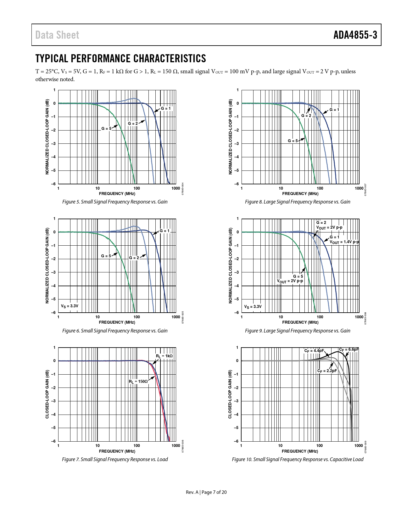

Data Sheet ADA4855-3 TYPICAL PERFORMANCE CHARACTERISTICS
T = 25°C, VS = 5V, G = 1, RF = 1 kΩ for G > 1, RL = 150 Ω, small signal VOUT = 100 mV p-p, and large signal VOUT = 2 V p-p, unless otherwise noted.

07685- Figure 5. Small Signal Frequency Response vs. Gain Figure 8. Large Signal Frequency Response vs. Gain

07685- Figure 6. Small Signal Frequency Response vs. Gain Figure 9. Large Signal Frequency Response vs. Gain

07685- Figure 7. Small Signal Frequency Response vs. Load Figure 10. Small Signal Frequency Response vs. Capacitive Load Rev. A | Page 7 of 20 Document Outline Features Applications Connection Diagram General Description Revision History Specifications 5 V Operation 3.3 V Operation Absolute Maximum Ratings Thermal Resistance Maximum Power Dissipation ESD Caution Pin Configuration and Function Descriptions Typical Performance Characteristics Test Circuits Theory of Operation Applications Information Gain Configurations 20 MHz Active Low-Pass Filter RGB Video Driver Driving Multiple Video Loads PD (Power-Down) Pin Single-Supply Operation Power Supply Bypassing Layout Outline Dimensions Ordering Guide
