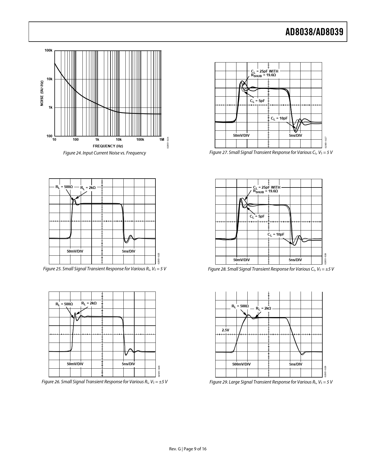

AD8038/AD8039. 100k. CL = 25pF WITH. RSNUB = 19.6Ω. ) 10k. /√Hz fA. ISE ( O. CL = 5pF. CL = 10pF. 100. 50mV/DIV. 5ns/DIV. 10k. FREQUENCY (Hz)

95 95 02 02 Figure 24. Input Current Noise vs. Frequency Figure 27. Small Signal Transient Response for Various CL, VS = 5 V

95 02 02 Figure 25. Small Signal Transient Response for Various RL, VS = 5 V Figure 28. Small Signal Transient Response for Various CL, VS = ±5 V

9 26 0 02 1- 1- 95 95 02 02 Figure 26. Small Signal Transient Response for Various RL, VS = ±5 V Figure 29. Large Signal Transient Response for Various RL, VS = 5 V Rev. G | Page 9 of 16 Document Outline FEATURES APPLICATIONS GENERAL DESCRIPTION FUNCTIONAL BLOCK DIAGRAM TABLE OF CONTENTS REVISION HISTORY SPECIFICATIONS ABSOLUTE MAXIMUM RATINGS MAXIMUM POWER DISSIPATION OUTPUT SHORT CIRCUIT ESD CAUTION TYPICAL PERFORMANCE CHARACTERISTICS LAYOUT, GROUNDING, AND BYPASSING CONSIDERATIONS DISABLE POWER SUPPLY BYPASSING GROUNDING INPUT CAPACITANCE OUTPUT CAPACITANCE INPUT-TO-OUTPUT COUPLING APPLICATIONS INFORMATION LOW POWER ADC DRIVER LOW POWER ACTIVE VIDEO FILTER OUTLINE DIMENSIONS ORDERING GUIDE
