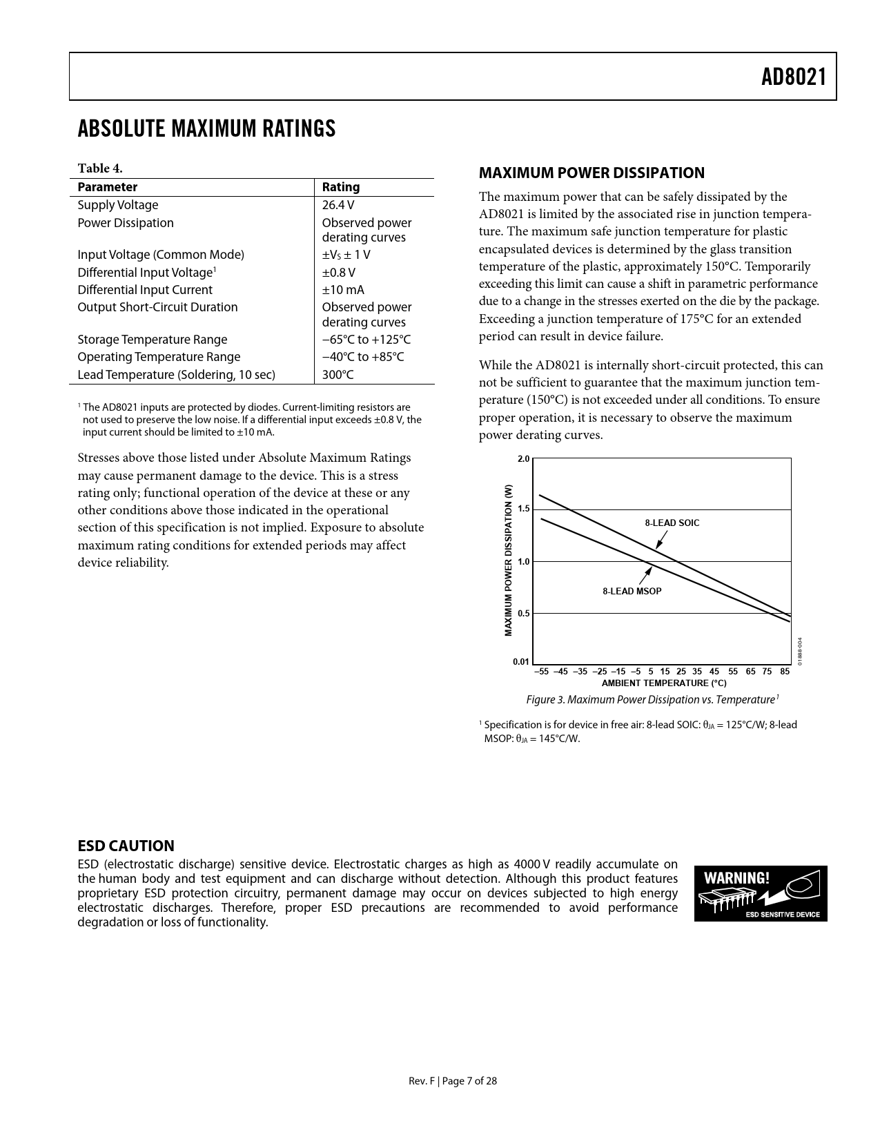

AD8021 ABSOLUTE MAXIMUM RATINGS Table 4. MAXIMUM POWER DISSIPATION Parameter Rating
The maximum power that can be safely dissipated by the Supply Voltage 26.4 V AD8021 is limited by the associated rise in junction tempera- Power Dissipation Observed power derating curves ture. The maximum safe junction temperature for plastic Input Voltage (Common Mode) ±V encapsulated devices is determined by the glass transition S ± 1 V Differential Input Voltage1 ±0.8 V temperature of the plastic, approximately 150°C. Temporarily Differential Input Current ±10 mA exceeding this limit can cause a shift in parametric performance due to a change in the stresses exerted on the die by the package. Output Short-Circuit Duration Observed power derating curves Exceeding a junction temperature of 175°C for an extended Storage Temperature Range −65°C to +125°C period can result in device failure. Operating Temperature Range −40°C to +85°C While the AD8021 is internally short-circuit protected, this can Lead Temperature (Soldering, 10 sec) 300°C not be sufficient to guarantee that the maximum junction tem- perature (150°C) is not exceeded under all conditions. To ensure 1 The AD8021 inputs are protected by diodes. Current-limiting resistors are not used to preserve the low noise. If a differential input exceeds ±0.8 V, the proper operation, it is necessary to observe the maximum input current should be limited to ±10 mA. power derating curves. Stresses above those listed under Absolute Maximum Ratings
2.0
may cause permanent damage to the device. This is a stress
rating only; functional operation of the device at these or any
W N (
other conditions above those indicated in the operational
1.5 IO
section of this specification is not implied. Exposure to absolute
AT 8-LEAD SOIC IP S
maximum rating conditions for extended periods may affect
S
device reliability.
R DI 1.0 E W O P 8-LEAD MSOP UM IM 0.5 X A M
04 0 8-
0.01
188 0
–55 –45 –35 –25 –15 –5 5 15 25 35 45 55 65 75 85 AMBIENT TEMPERATURE (°C)
Figure 3. Maximum Power Dissipation vs. Temperature1 1 Specification is for device in free air: 8-lead SOIC: θJA = 125°C/W; 8-lead MSOP: θJA = 145°C/W.
