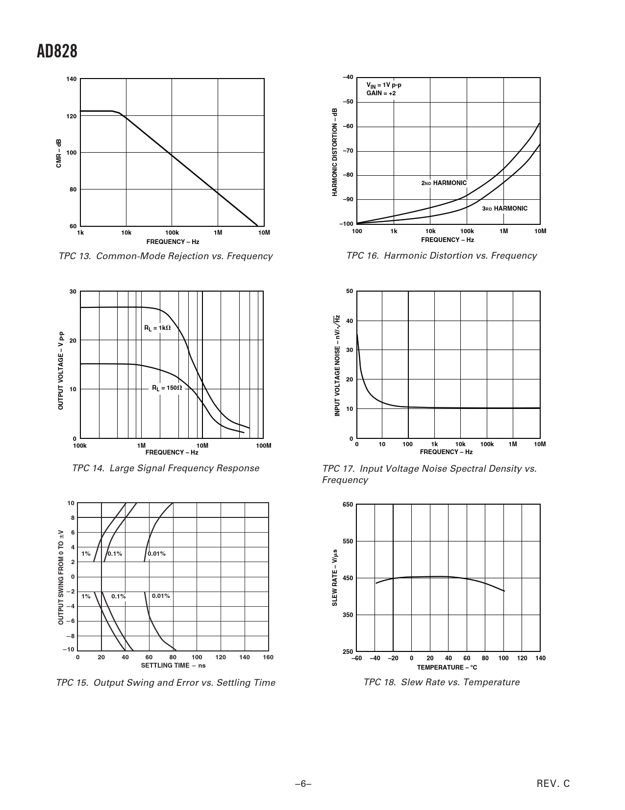

AD828. 140. –40. VIN = 1V p-p GAIN = +2. –50. 120. –60. 100. –70. CMR – dB. –80. 2ND HARMONIC. HARMONIC DISTORTION – dB. –90. 3RD HARMONIC. –100. 10k
AD828 140 –40 VIN = 1V p-p GAIN = +2 –50 120 –60 100 –70 CMR – dB –80 2ND HARMONIC HARMONIC DISTORTION – dB –90 3RD HARMONIC –100 10k
AD828 140 –40 VIN = 1V p-p GAIN = +2 –50 120 –60 100 –70 CMR – dB –80 2ND HARMONIC 80 HARMONIC DISTORTION – dB –90 3RD HARMONIC 60 –100 1k 10k 100k 1M 10M 100 1k 10k 100k 1M 10M FREQUENCY – Hz FREQUENCY – Hz
TPC 13. Common-Mode Rejection vs. Frequency TPC 16. Harmonic Distortion vs. Frequency
30 50 40 RL = 1k 20 30 20 10 RL = 150 OUTPUT VOLTAGE – V p-p 10 INPUT VOLTAGE NOISE – nV/ Hz 0 0 100k 1M 10M 100M 0 10 100 1k 10k 100k 1M 10M FREQUENCY – Hz FREQUENCY – Hz
TPC 14. Large Signal Frequency Response TPC 17. Input Voltage Noise Spectral Density vs. Frequency
10 650 8 V 6 550 4 1% 0.1% s 0.01% 2 0 450 2 1% 0.1% 0.01% 4 SLEW RATE – V/ 350 OUTPUT SWING FROM 0 TO 6 8 10 250 0 20 40 60 80 100 120 140 160 –60 –40 –20 0 20 40 60 80 100 120 140 SETTLING TIME ns TEMPERATURE – C
TPC 15. Output Swing and Error vs. Settling Time TPC 18. Slew Rate vs. Temperature –6– REV. C
