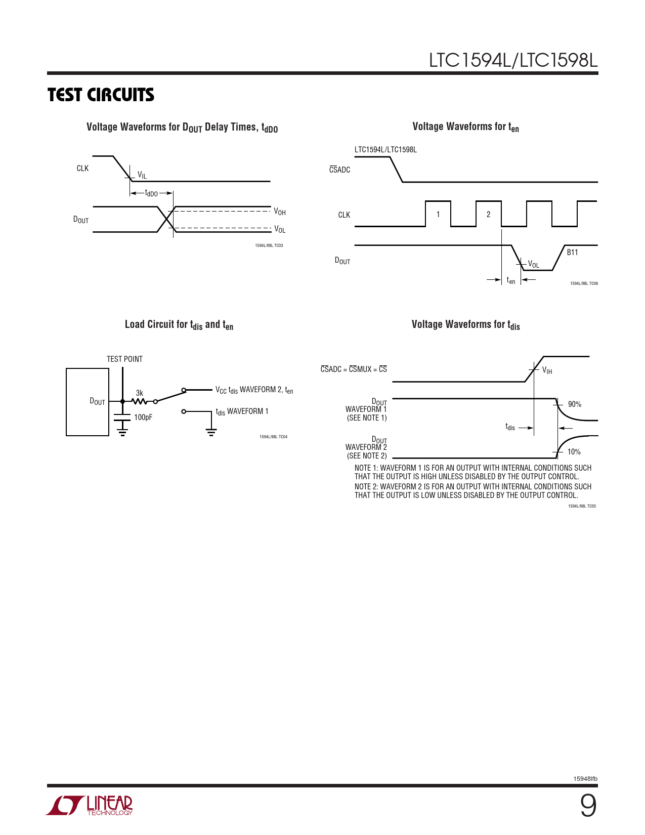

TEST CIRCUITS. Voltage Waveforms for D. Voltage Waveforms for t. OUT Delay Times, tdDO. Load Circuit for tdis and ten
TEST CIRCUITS Voltage Waveforms for D Voltage Waveforms for t OUT Delay Times, tdDO Load Circuit for tdis and ten
LTC1594L/LTC1598L
TEST CIRCUITS Voltage Waveforms for D Voltage Waveforms for t OUT Delay Times, tdDO en
LTC1594L/LTC1598L CLK CSADC VIL tdDO VOH CLK 1 2 DOUT VOL 1594L/98L TC03 B11 DOUT VOL ten 1594L/98L TC06
Load Circuit for tdis and ten Voltage Waveforms for tdis
TEST POINT CSADC = CSMUX = CS VIH V 3k CC tdis WAVEFORM 2, ten DOUT DOUT 90% WAVEFORM 1 tdis WAVEFORM 1 100pF (SEE NOTE 1) tdis 1594L/98L TC04 DOUT WAVEFORM 2 10% (SEE NOTE 2) NOTE 1: WAVEFORM 1 IS FOR AN OUTPUT WITH INTERNAL CONDITIONS SUCH THAT THE OUTPUT IS HIGH UNLESS DISABLED BY THE OUTPUT CONTROL. NOTE 2: WAVEFORM 2 IS FOR AN OUTPUT WITH INTERNAL CONDITIONS SUCH THAT THE OUTPUT IS LOW UNLESS DISABLED BY THE OUTPUT CONTROL. 1594L/98L TC05 15948lfb 9
