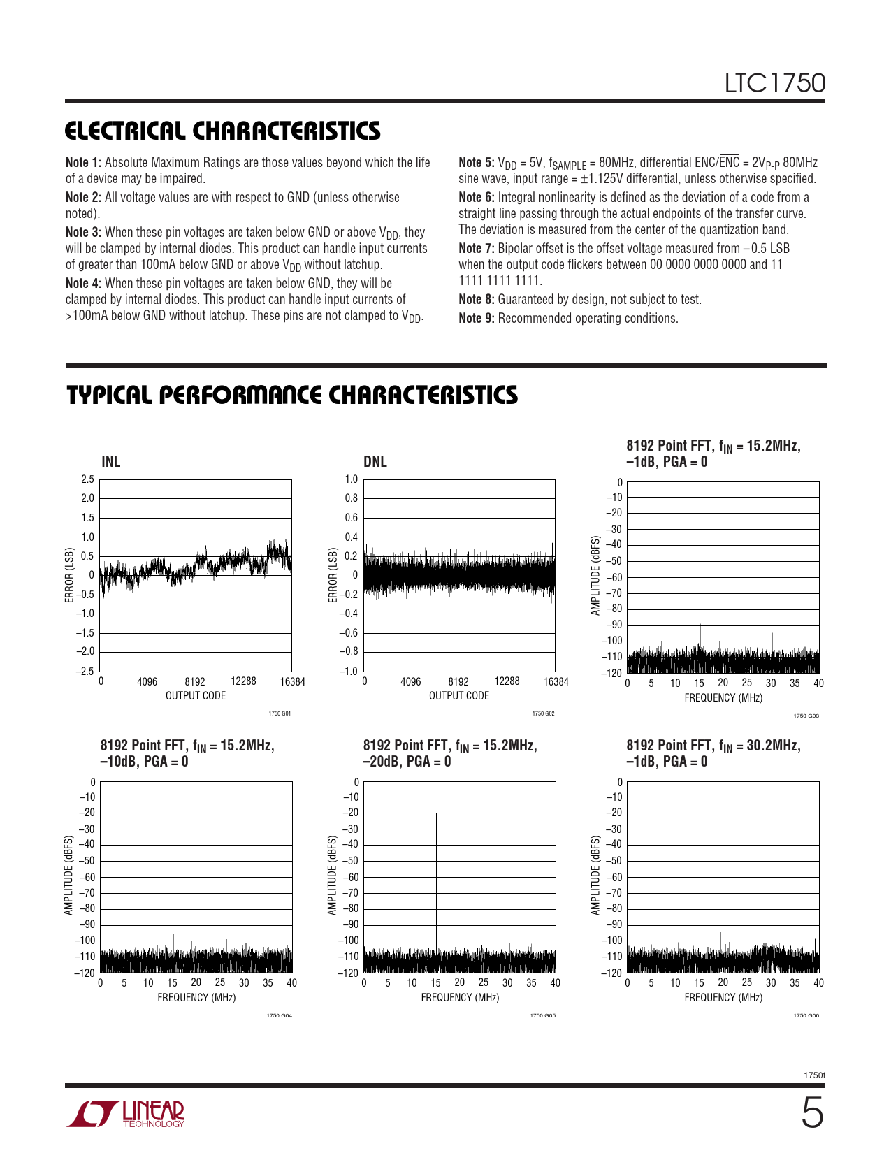

ELECTRICAL CHARACTERISTICS. Note 1:. Note 5:. Note 2:. Note 6:. Note 3:. Note 7:. Note 4:. Note 8:. Note 9:
ELECTRICAL CHARACTERISTICS Note 1: Note 5: Note 2: Note 6: Note 3: Note 7: Note 4: Note 8: Note 9:
LTC1750
Absolute Maximum Ratings are those values beyond which the life
Note 5:
VDD = 5V, fSAMPLE = 80MHz, differential ENC/ENC = 2VP-P 80MHz of a device may be impaired. sine wave, input range = ±1.125V differential, unless otherwise specified.
Note 2:
All voltage values are with respect to GND (unless otherwise
Note 6:
Integral nonlinearity is defined as the deviation of a code from a noted). straight line passing through the actual endpoints of the transfer curve.
Note 3:
When these pin voltages are taken below GND or above V The deviation is measured from the center of the quantization band. DD, they will be clamped by internal diodes. This product can handle input currents
Note 7:
Bipolar offset is the offset voltage measured from – 0.5 LSB of greater than 100mA below GND or above VDD without latchup. when the output code flickers between 00 0000 0000 0000 and 11
Note 4:
When these pin voltages are taken below GND, they will be 1111 1111 1111. clamped by internal diodes. This product can handle input currents of
Note 8:
Guaranteed by design, not subject to test. >100mA below GND without latchup. These pins are not clamped to VDD.
Note 9:
Recommended operating conditions.
W U TYPICAL PERFOR A CE CHARACTERISTICS 8192 Point FFT, fIN = 15.2MHz, INL DNL –1dB, PGA = 0
2.5 1.0 0 2.0 0.8 –10 –20 1.5 0.6 –30 1.0 0.4 –40 0.5 0.2 –50 0 0 –60 –0.5 –0.2 –70 ERROR (LSB) ERROR (LSB) –80 –1.0 –0.4 AMPLITUDE (dBFS) –90 –1.5 –0.6 –100 –2.0 –0.8 –110 –2.5 –1.0 –120 0 4096 8192 12288 16384 0 4096 8192 12288 16384 0 5 10 15 20 25 30 35 40 OUTPUT CODE OUTPUT CODE FREQUENCY (MHz) 1750 G01 1750 G02 1750 G03
8192 Point FFT, fIN = 15.2MHz, 8192 Point FFT, fIN = 15.2MHz, 8192 Point FFT, fIN = 30.2MHz, –10dB, PGA = 0 –20dB, PGA = 0 –1dB, PGA = 0
0 0 0 –10 –10 –10 –20 –20 –20 –30 –30 –30 –40 –40 –40 –50 –50 –50 –60 –60 –60 –70 –70 –70 AMPLITUDE (dBFS) –80 AMPLITUDE (dBFS) –80 AMPLITUDE (dBFS) –80 –90 –90 –90 –100 –100 –100 –110 –110 –110 –120 –120 –120 0 5 10 15 20 25 30 35 40 0 5 10 15 20 25 30 35 40 0 5 10 15 20 25 30 35 40 FREQUENCY (MHz) FREQUENCY (MHz) FREQUENCY (MHz) 1750 G04 1750 G05 1750 G06 1750f 5
