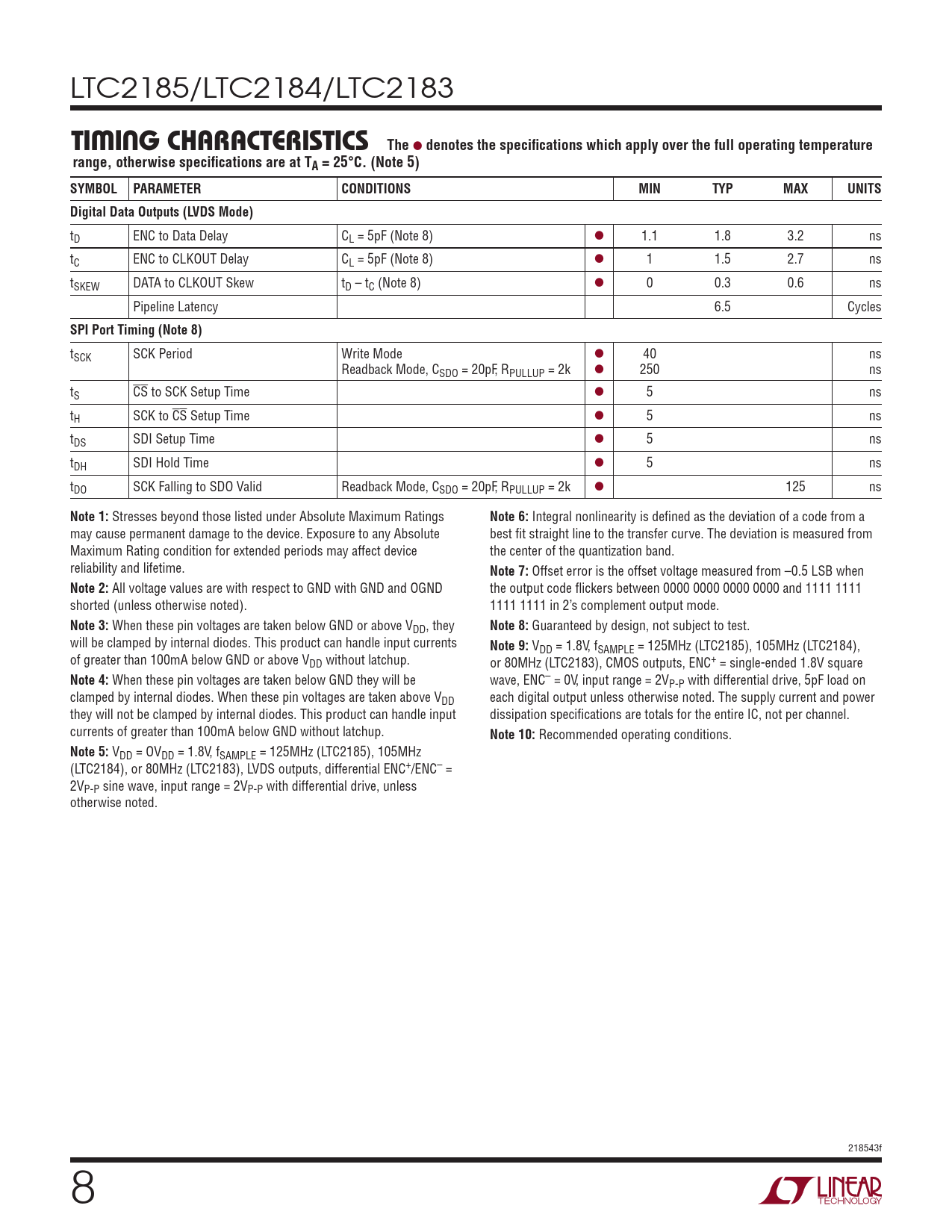

TiMing characTerisTics. The. denotes the specifications which apply over the full operating temperature
TiMing characTerisTics The denotes the specifications which apply over the full operating temperature
LTC2185/LTC2184/LTC2183
l
denotes the specifications which apply over the full operating temperature range, otherwise specifications are at TA = 25°C. (Note 5) SYMBOL PARAMETER CONDITIONS MIN TYP MAX UNITS Digital Data Outputs (LVDS Mode)
tD ENC to Data Delay CL = 5pF (Note 8) l 1.1 1.8 3.2 ns tC ENC to CLKOUT Delay CL = 5pF (Note 8) l 1 1.5 2.7 ns tSKEW DATA to CLKOUT Skew tD – tC (Note 8) l 0 0.3 0.6 ns Pipeline Latency 6.5 Cycles
SPI Port Timing (Note 8)
tSCK SCK Period Write Mode l 40 ns Readback Mode, CSDO = 20pF, RPULLUP = 2k l 250 ns tS CS to SCK Setup Time l 5 ns tH SCK to CS Setup Time l 5 ns tDS SDI Setup Time l 5 ns tDH SDI Hold Time l 5 ns tDO SCK Falling to SDO Valid Readback Mode, CSDO = 20pF, RPULLUP = 2k l 125 ns
Note 1:
Note 6:
Integral nonlinearity is defined as the deviation of a code from a may cause permanent damage to the device. Exposure to any Absolute best fit straight line to the transfer curve. The deviation is measured from Maximum Rating condition for extended periods may affect device the center of the quantization band. reliability and lifetime.
Note 7:
Offset error is the offset voltage measured from –0.5 LSB when
Note 2:
All voltage values are with respect to GND with GND and OGND the output code flickers between 0000 0000 0000 0000 and 1111 1111 shorted (unless otherwise noted). 1111 1111 in 2’s complement output mode.
Note 3:
When these pin voltages are taken below GND or above VDD, they
Note 8:
Guaranteed by design, not subject to test. will be clamped by internal diodes. This product can handle input currents
Note 9:
VDD = 1.8V, fSAMPLE = 125MHz (LTC2185), 105MHz (LTC2184), of greater than 100mA below GND or above VDD without latchup. or 80MHz (LTC2183), CMOS outputs, ENC+ = single-ended 1.8V square
Note 4:
When these pin voltages are taken below GND they will be wave, ENC– = 0V, input range = 2VP-P with differential drive, 5pF load on clamped by internal diodes. When these pin voltages are taken above VDD each digital output unless otherwise noted. The supply current and power they will not be clamped by internal diodes. This product can handle input dissipation specifications are totals for the entire IC, not per channel. currents of greater than 100mA below GND without latchup.
Note 10:
Recommended operating conditions.
Note 5:
VDD = OVDD = 1.8V, fSAMPLE = 125MHz (LTC2185), 105MHz (LTC2184), or 80MHz (LTC2183), LVDS outputs, differential ENC+/ENC– = 2VP-P sine wave, input range = 2VP-P with differential drive, unless otherwise noted. 218543f 8 Document Outline Features Description Applications Typical Application Absolute Maximum Ratings Pin Configuration Order Information Converter Characteristics Analog Input Dynamic Accuracy Internal Reference Characteristics Digital Inputs and Outputs Power Requirements Timing Characteristics Timing Diagrams Typical Performance Characteristics Pin Functions Functional Block Diagram Applications Information Typical Applications Package Description Typical Application Related Parts
