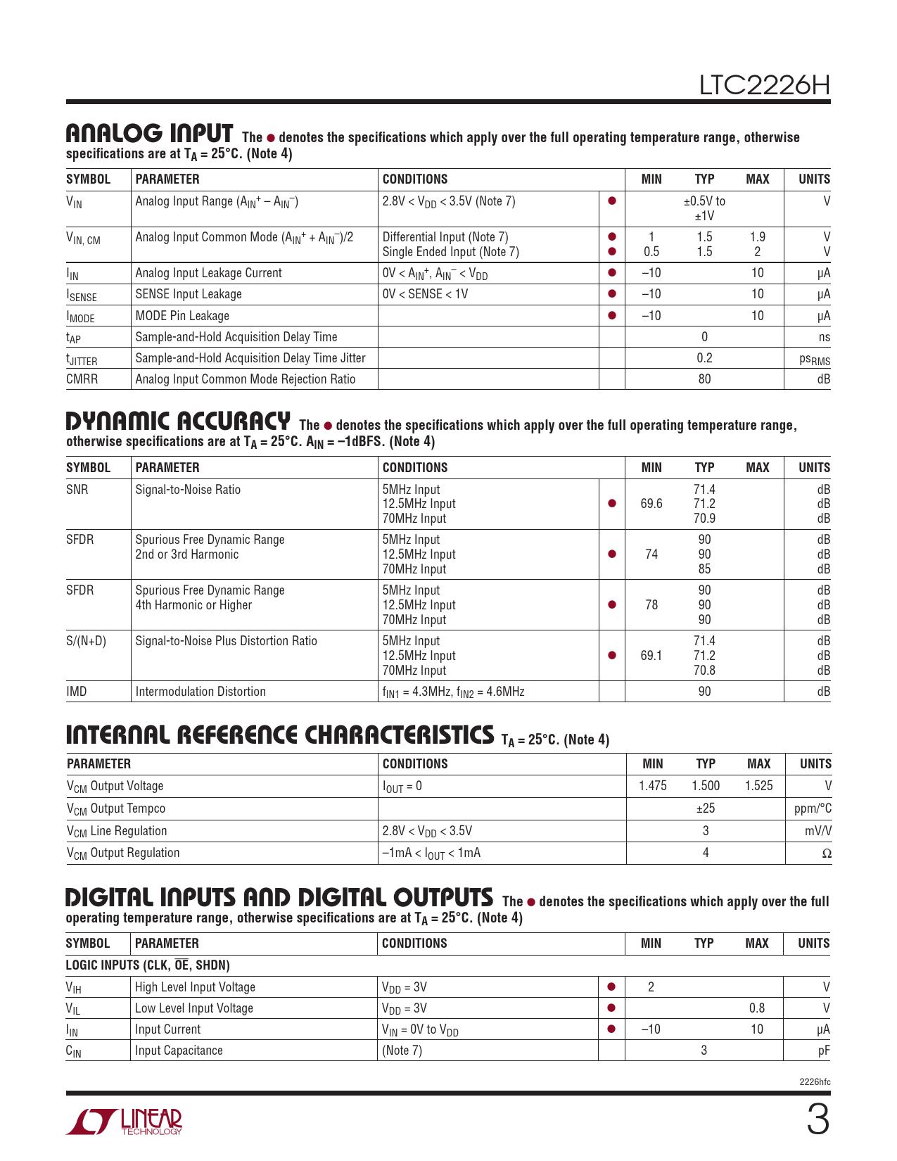

ANALOG INPUT. The. denotes the specifications which apply over the full operating temperature range, otherwise
ANALOG INPUT The denotes the specifications which apply over the full operating temperature range, otherwise
LTC2226H
ANALOG INPUT The
l
denotes the specifications which apply over the full operating temperature range, otherwise specifications are at TA = 25°C. (Note 4) SYMBOL PARAMETER CONDITIONS MIN TYP MAX UNITS
V + – IN Analog Input Range (AIN – AIN ) 2.8V < VDD < 3.5V (Note 7) l ±0.5V to V ±1V V + – IN, CM Analog Input Common Mode (AIN + AIN )/2 Differential Input (Note 7) l 1 1.5 1.9 V Single Ended Input (Note 7) l 0.5 1.5 2 V I + – IN Analog Input Leakage Current 0V < AIN , AIN < VDD l –10 10 µA ISENSE SENSE Input Leakage 0V < SENSE < 1V l –10 10 µA IMODE MODE Pin Leakage l –10 10 µA tAP Sample-and-Hold Acquisition Delay Time 0 ns tJITTER Sample-and-Hold Acquisition Delay Time Jitter 0.2 psRMS CMRR Analog Input Common Mode Rejection Ratio 80 dB
DYNAMIC ACCURACY The
l
denotes the specifications which apply over the full operating temperature range, otherwise specifications are at TA = 25°C. AIN = –1dBFS. (Note 4) SYMBOL PARAMETER CONDITIONS MIN TYP MAX UNITS
SNR Signal-to-Noise Ratio 5MHz Input 71.4 dB 12.5MHz Input l 69.6 71.2 dB 70MHz Input 70.9 dB SFDR Spurious Free Dynamic Range 5MHz Input 90 dB 2nd or 3rd Harmonic 12.5MHz Input l 74 90 dB 70MHz Input 85 dB SFDR Spurious Free Dynamic Range 5MHz Input 90 dB 4th Harmonic or Higher 12.5MHz Input l 78 90 dB 70MHz Input 90 dB S/(N+D) Signal-to-Noise Plus Distortion Ratio 5MHz Input 71.4 dB 12.5MHz Input l 69.1 71.2 dB 70MHz Input 70.8 dB IMD Intermodulation Distortion fIN1 = 4.3MHz, fIN2 = 4.6MHz 90 dB
INTERNAL REFERENCE CHARACTERISTICS TA = 25°C. (Note 4) PARAMETER CONDITIONS MIN TYP MAX UNITS
VCM Output Voltage IOUT = 0 1.475 1.500 1.525 V VCM Output Tempco ±25 ppm/°C VCM Line Regulation 2.8V < VDD < 3.5V 3 mV/V VCM Output Regulation –1mA < IOUT < 1mA 4 W
DIGITAL INPUTS AND DIGITAL OUTPUTS The
l
denotes the specifications which apply over the full operating temperature range, otherwise specifications are at TA = 25°C. (Note 4) SYMBOL PARAMETER CONDITIONS MIN TYP MAX UNITS LOGIC INPUTS (CLK, OE, SHDN)
VIH High Level Input Voltage VDD = 3V l 2 V VIL Low Level Input Voltage VDD = 3V l 0.8 V IIN Input Current VIN = 0V to VDD l –10 10 µA CIN Input Capacitance (Note 7) 3 pF 2226hfc 3
