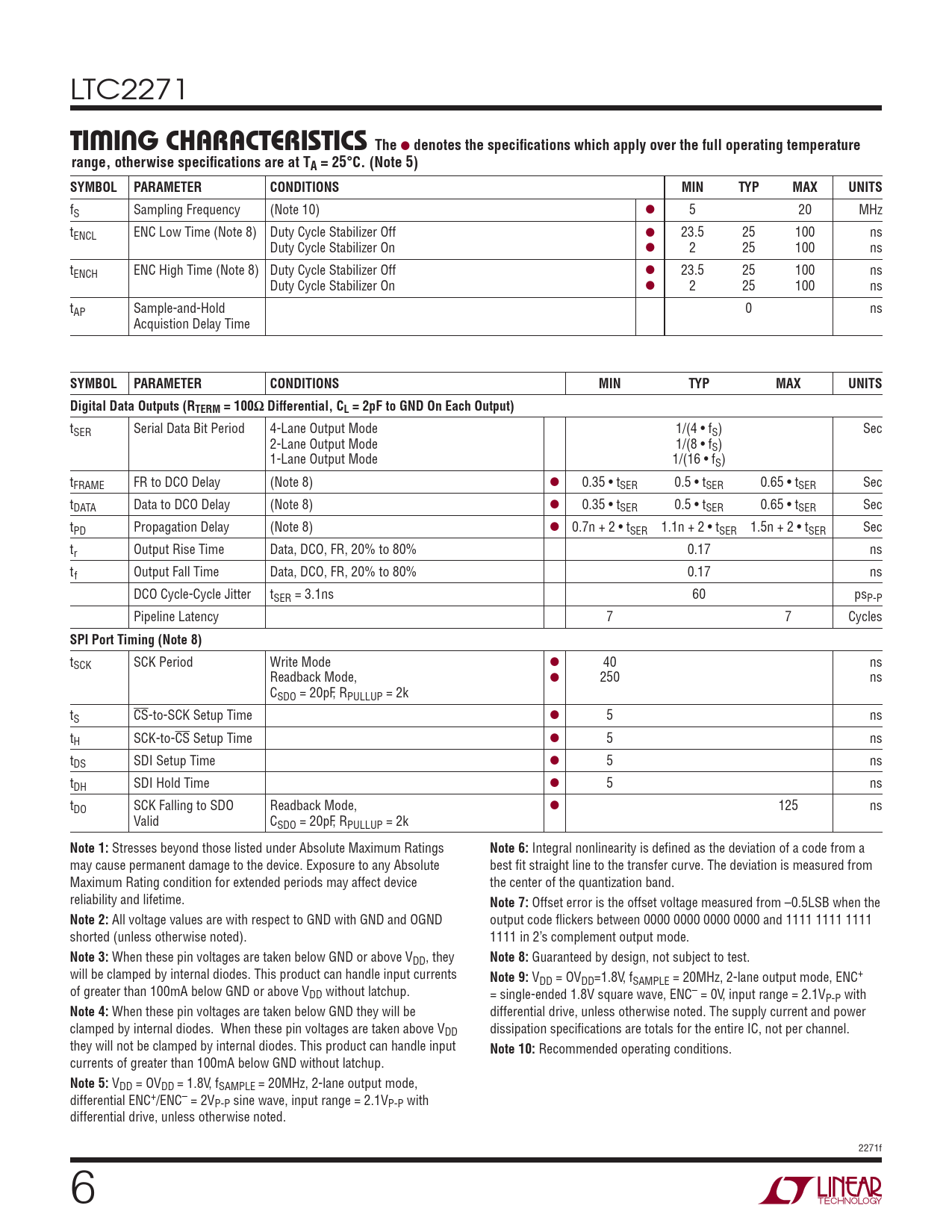

TIMING CHARACTERISTICS. The. denotes the specifi cations which apply over the full operating temperature
TIMING CHARACTERISTICS The denotes the specifi cations which apply over the full operating temperature
LTC2271
l
denotes the specifi cations which apply over the full operating temperature range, otherwise specifi cations are at TA = 25°C. (Note 5) SYMBOL PARAMETER CONDITIONS MIN TYP MAX UNITS
fS Sampling Frequency (Note 10) l 5 20 MHz tENCL ENC Low Time (Note 8) Duty Cycle Stabilizer Off l 23.5 25 100 ns Duty Cycle Stabilizer On l 2 25 100 ns tENCH ENC High Time (Note 8) Duty Cycle Stabilizer Off l 23.5 25 100 ns Duty Cycle Stabilizer On l 2 25 100 ns tAP Sample-and-Hold 0 ns Acquistion Delay Time
SYMBOL PARAMETER CONDITIONS MIN TYP MAX UNITS Digital Data Outputs (RTERM = 100Ω Differential, CL = 2pF to GND On Each Output)
tSER Serial Data Bit Period 4-Lane Output Mode 1/(4 • fS) Sec 2-Lane Output Mode 1/(8 • fS) 1-Lane Output Mode 1/(16 • fS) tFRAME FR to DCO Delay (Note 8) l 0.35 • tSER 0.5 • tSER 0.65 • tSER Sec tDATA Data to DCO Delay (Note 8) l 0.35 • tSER 0.5 • tSER 0.65 • tSER Sec tPD Propagation Delay (Note 8) l 0.7n + 2 • tSER 1.1n + 2 • tSER 1.5n + 2 • tSER Sec tr Output Rise Time Data, DCO, FR, 20% to 80% 0.17 ns tf Output Fall Time Data, DCO, FR, 20% to 80% 0.17 ns DCO Cycle-Cycle Jitter tSER = 3.1ns 60 psP-P Pipeline Latency 7 7 Cycles
SPI Port Timing (Note 8)
tSCK SCK Period Write Mode l 40 ns Readback Mode, l 250 ns CSDO = 20pF, RPULLUP = 2k tS CS-to-SCK Setup Time l 5 ns tH SCK-to-CS Setup Time l 5 ns tDS SDI Setup Time l 5 ns tDH SDI Hold Time l 5 ns tDO SCK Falling to SDO Readback Mode, l 125 ns Valid CSDO = 20pF, RPULLUP = 2k
