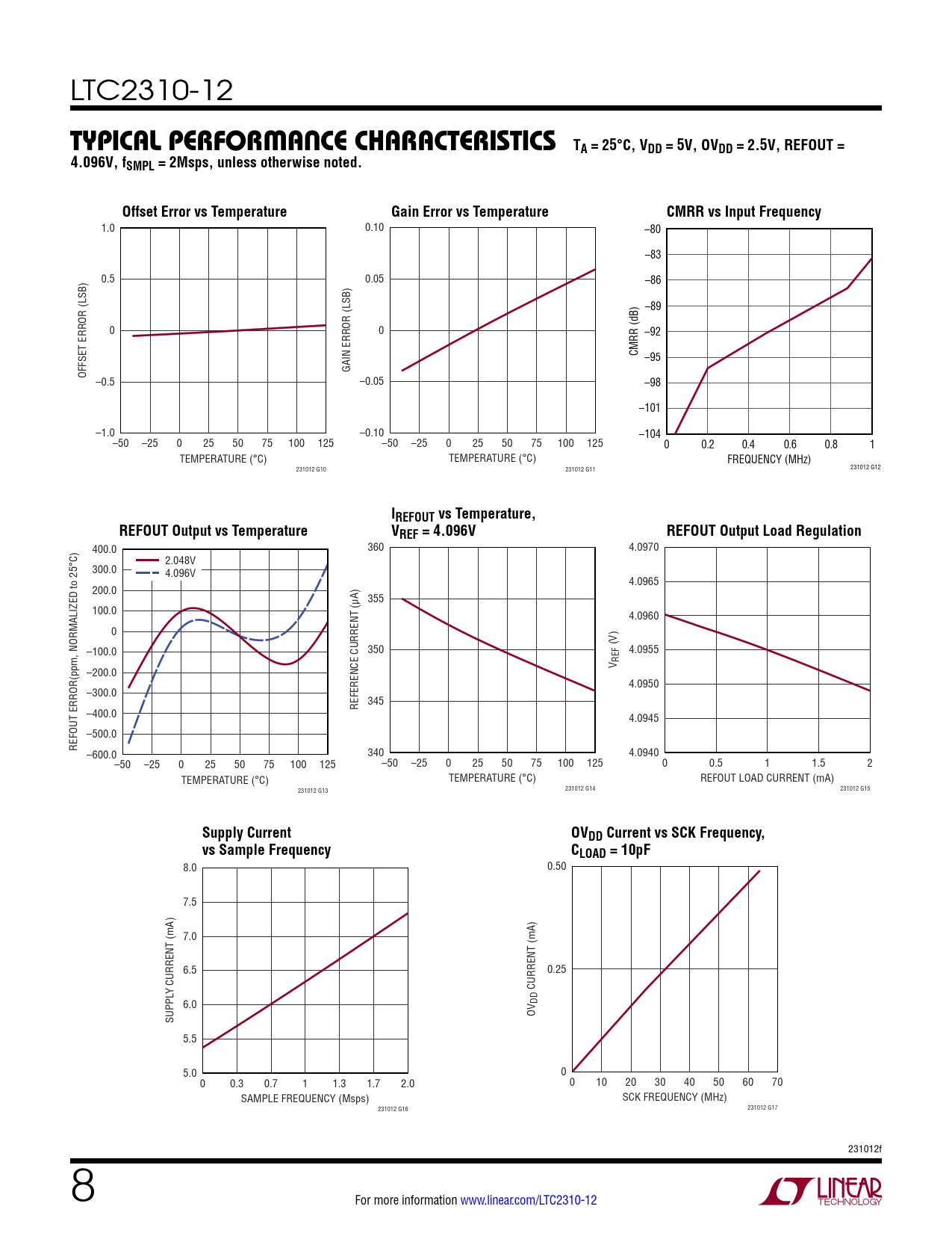

Typical perForMance characTerisTics. TA = 25°C, VDD = 5V, OVDD = 2.5V, REFOUT =
Typical perForMance characTerisTics TA = 25°C, VDD = 5V, OVDD = 2.5V, REFOUT =
LTC2310-12
Typical perForMance characTerisTics TA = 25°C, VDD = 5V, OVDD = 2.5V, REFOUT = 4.096V, fSMPL = 2Msps, unless otherwise noted. Offset Error vs Temperature Gain Error vs Temperature CMRR vs Input Frequency
1.0 0.10 –80 –83 0.5 0.05 –86 –89 0 0 –92 CMRR (dB) –95 OFFSET ERROR (LSB) GAIN ERROR (LSB) –0.5 –0.05 –98 –101 –1.0 –0.10 –104 –50 –25 0 25 50 75 100 125 –50 –25 0 25 50 75 100 125 0 0.2 0.4 0.6 0.8 1 TEMPERATURE (°C) TEMPERATURE (°C) FREQUENCY (MHz) 231012 G10 231012 G11 231012 G12
IREFOUT vs Temperature, REFOUT Output vs Temperature VREF = 4.096V REFOUT Output Load Regulation
400.0 360 4.0970 2.048V 300.0 4.096V 4.0965 200.0 355 100.0 4.0960 0 –100.0 350 (V) 4.0955 V REF –200.0 4.0950 –300.0 345 REFERENCE CURRENT (µA) –400.0 4.0945 –500.0 REFOUT ERROR(ppm, NORMALIZED to 25°C) –600.0 340 4.0940 –50 –25 0 25 50 75 100 125 –50 –25 0 25 50 75 100 125 0 0.5 1 1.5 2 TEMPERATURE (°C) TEMPERATURE (°C) REFOUT LOAD CURRENT (mA) 231012 G14 231012 G15 231012 G13
Supply Current OVDD Current vs SCK Frequency, vs Sample Frequency CLOAD = 10pF
