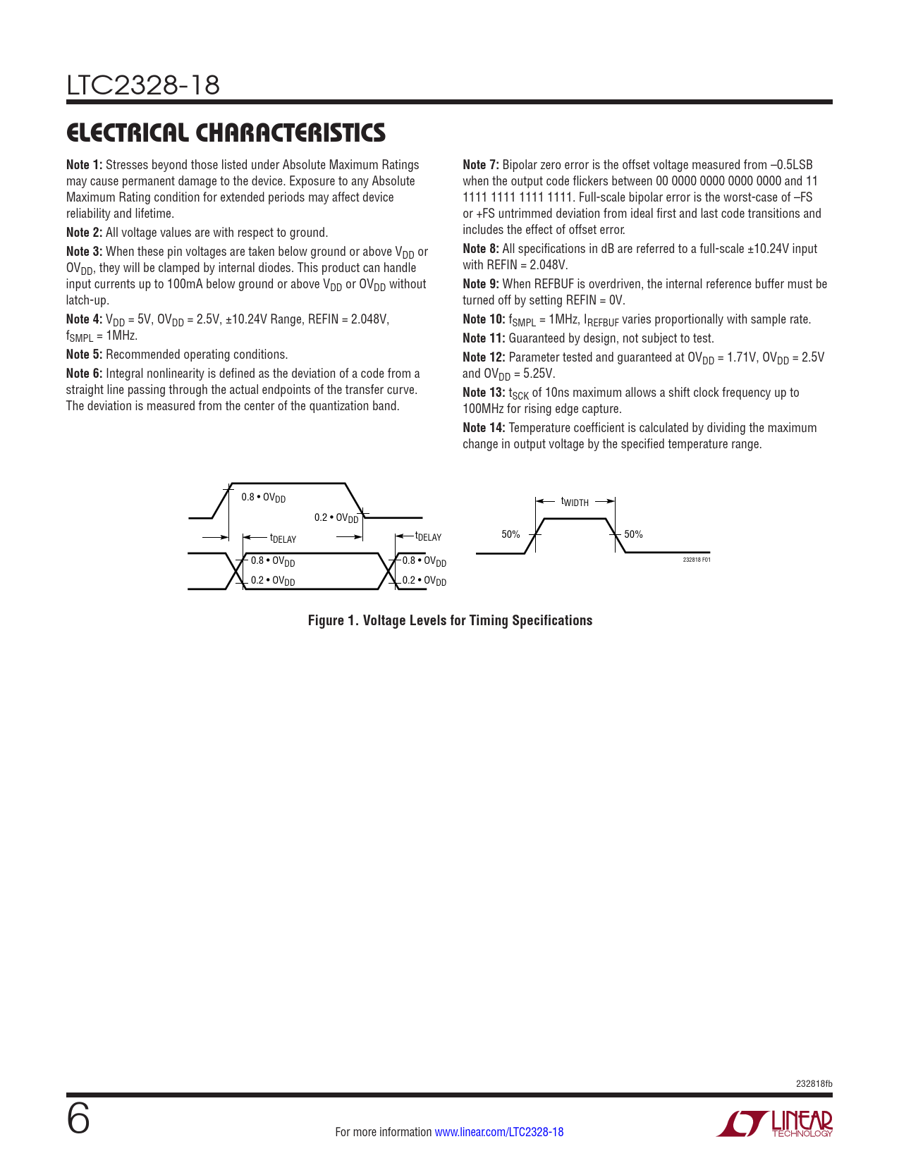

Temperature coefficient is calculated by dividing the maximum change in output voltage by the specified temperature range. 0.8 • OVDD tWIDTH 0.2 • OVDD t tDELAY 50% 50% DELAY 232818 F01 0.8 • OVDD 0.8 • OVDD 0.2 • OVDD 0.2 • OVDD
Figure 1. Voltage Levels for Timing Specifications
