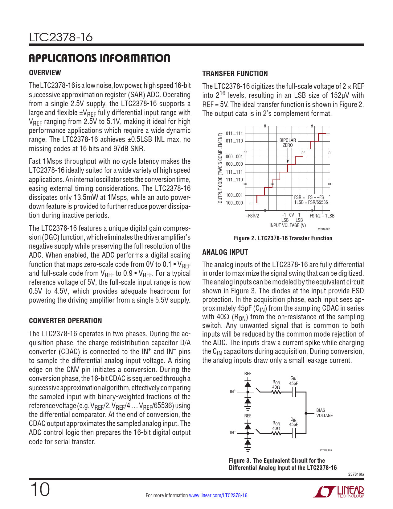

The LTC2378-16 is a low noise, low power, high speed 16-bit The LTC2378-16 digitizes the full-scale voltage of 2 × REF successive approximation register (SAR) ADC. Operating into 216 levels, resulting in an LSB size of 152µV with from a single 2.5V supply, the LTC2378-16 supports a REF = 5V. The ideal transfer function is shown in Figure 2. large and flexible ±VREF fully differential input range with The output data is in 2’s complement format. VREF ranging from 2.5V to 5.1V, making it ideal for high performance applications which require a wide dynamic 011...111 range. The LTC2378-16 achieves ±0.5LSB INL max, no 011...110 BIPOLAR missing codes at 16 bits and 97dB SNR. ZERO Fast 1Msps throughput with no cycle latency makes the 000...001 000...000 LTC2378-16 ideally suited for a wide variety of high speed 111...111 applications. An internal oscillator sets the conversion time, 111...110 easing external timing considerations. The LTC2378-16 dissipates only 13.5mW at 1Msps, while an auto power- 100...001 FSR = +FS – –FS down feature is provided to further reduce power dissipa- OUTPUT CODE (TWO’S COMPLEMENT) 100...000 1LSB = FSR/65536 tion during inactive periods. –FSR/2 –1 0V 1 FSR/2 – 1LSB LSB LSB The LTC2378-16 features a unique digital gain compres- INPUT VOLTAGE (V) 237816 F02 sion (DGC) function, which eliminates the driver amplifier’s
Figure 2. LTC2378-16 Transfer Function
negative supply while preserving the full resolution of the ADC. When enabled, the ADC performs a digital scaling
ANALOG INPUT
function that maps zero-scale code from 0V to 0.1 • VREF The analog inputs of the LTC2378-16 are fully differential and full-scale code from VREF to 0.9 • VREF. For a typical in order to maximize the signal swing that can be digitized. reference voltage of 5V, the full-scale input range is now The analog inputs can be modeled by the equivalent circuit 0.5V to 4.5V, which provides adequate headroom for shown in Figure 3. The diodes at the input provide ESD powering the driving amplifier from a single 5.5V supply. protection. In the acquisition phase, each input sees ap- proximately 45pF (CIN) from the sampling CDAC in series
CONVERTER OPERATION
with 40Ω (RON) from the on-resistance of the sampling switch. Any unwanted signal that is common to both The LTC2378-16 operates in two phases. During the ac- inputs will be reduced by the common mode rejection of quisition phase, the charge redistribution capacitor D/A the ADC. The inputs draw a current spike while charging converter (CDAC) is connected to the IN+ and IN– pins the CIN capacitors during acquisition. During conversion, to sample the differential analog input voltage. A rising the analog inputs draw only a small leakage current. edge on the CNV pin initiates a conversion. During the REF conversion phase, the 16-bit CDAC is sequenced through a C R IN successive approximation algorithm, effectively comparing ON 45pF 40Ω the sampled input with binary-weighted fractions of the IN+ reference voltage (e.g. VREF/2, VREF/4 … VREF/65536) using the differential comparator. At the end of conversion, the BIAS REF VOLTAGE CDAC output approximates the sampled analog input. The C R IN ON 45pF ADC control logic then prepares the 16-bit digital output 40Ω IN– code for serial transfer. 237816 F03
Figure 3. The Equivalent Circuit for the Differential Analog Input of the LTC2378-16
