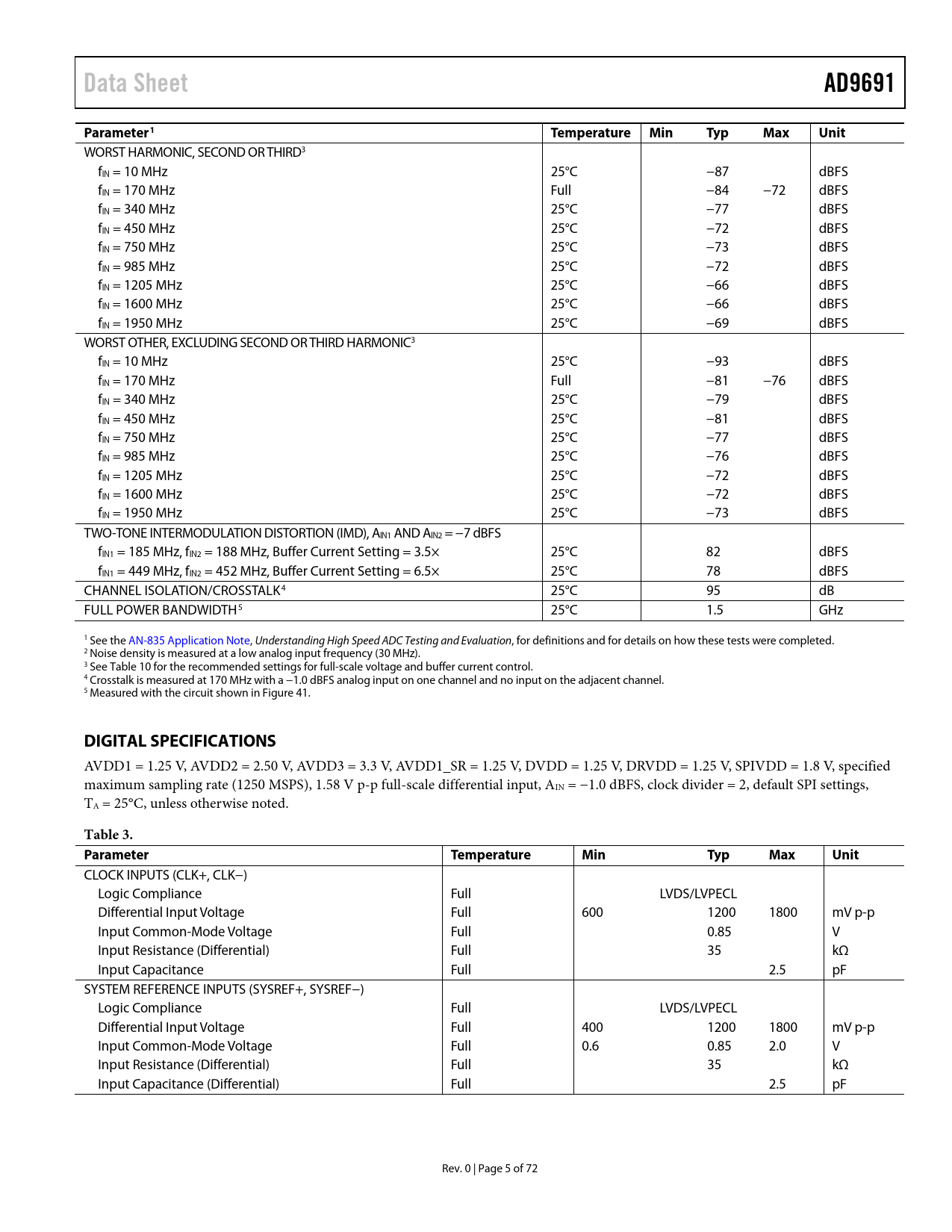

Data Sheet AD9691 Parameter1 Temperature Min Typ Max Unit
WORST HARMONIC, SECOND OR THIRD3 fIN = 10 MHz 25°C −87 dBFS fIN = 170 MHz Full −84 −72 dBFS fIN = 340 MHz 25°C −77 dBFS fIN = 450 MHz 25°C −72 dBFS fIN = 750 MHz 25°C −73 dBFS fIN = 985 MHz 25°C −72 dBFS fIN = 1205 MHz 25°C −66 dBFS fIN = 1600 MHz 25°C −66 dBFS fIN = 1950 MHz 25°C −69 dBFS WORST OTHER, EXCLUDING SECOND OR THIRD HARMONIC3 fIN = 10 MHz 25°C −93 dBFS fIN = 170 MHz Full −81 −76 dBFS fIN = 340 MHz 25°C −79 dBFS fIN = 450 MHz 25°C −81 dBFS fIN = 750 MHz 25°C −77 dBFS fIN = 985 MHz 25°C −76 dBFS fIN = 1205 MHz 25°C −72 dBFS fIN = 1600 MHz 25°C −72 dBFS fIN = 1950 MHz 25°C −73 dBFS TWO-TONE INTERMODULATION DISTORTION (IMD), AIN1 AND AIN2 = −7 dBFS fIN1 = 185 MHz, fIN2 = 188 MHz, Buffer Current Setting = 3.5× 25°C 82 dBFS fIN1 = 449 MHz, fIN2 = 452 MHz, Buffer Current Setting = 6.5× 25°C 78 dBFS CHANNEL ISOLATION/CROSSTALK4 25°C 95 dB FULL POWER BANDWIDTH5 25°C 1.5 GHz 1 See the AN-835 Application Note, Understanding High Speed ADC Testing and Evaluation, for definitions and for details on how these tests were completed. 2 Noise density is measured at a low analog input frequency (30 MHz). 3 See Table 10 for the recommended settings for ful -scale voltage and buffer current control. 4 Crosstalk is measured at 170 MHz with a −1.0 dBFS analog input on one channel and no input on the adjacent channel. 5 Measured with the circuit shown in Figure 41.
DIGITAL SPECIFICATIONS
AVDD1 = 1.25 V, AVDD2 = 2.50 V, AVDD3 = 3.3 V, AVDD1_SR = 1.25 V, DVDD = 1.25 V, DRVDD = 1.25 V, SPIVDD = 1.8 V, specified maximum sampling rate (1250 MSPS), 1.58 V p-p ful -scale differential input, AIN = −1.0 dBFS, clock divider = 2, default SPI settings, TA = 25°C, unless otherwise noted.
Table 3. Parameter Temperature Min Typ Max Unit
CLOCK INPUTS (CLK+, CLK−) Logic Compliance Full LVDS/LVPECL Differential Input Voltage Full 600 1200 1800 mV p-p Input Common-Mode Voltage Full 0.85 V Input Resistance (Differential) Full 35 kΩ Input Capacitance Full 2.5 pF SYSTEM REFERENCE INPUTS (SYSREF+, SYSREF−) Logic Compliance Full LVDS/LVPECL Differential Input Voltage Full 400 1200 1800 mV p-p Input Common-Mode Voltage Full 0.6 0.85 2.0 V Input Resistance (Differential) Full 35 kΩ Input Capacitance (Differential) Full 2.5 pF Rev. 0 | Page 5 of 72 Document Outline FEATURES APPLICATIONS GENERAL DESCRIPTION FUNCTIONAL BLOCK DIAGRAM PRODUCT HIGHLIGHTS TABLE OF CONTENTS REVISION HISTORY SPECIFICATIONS DC SPECIFICATIONS AC SPECIFICATIONS DIGITAL SPECIFICATIONS SWITCHING SPECIFICATIONS TIMING SPECIFICATIONS Timing Diagrams ABSOLUTE MAXIMUM RATINGS THERMAL CHARACTERISTICS ESD CAUTION PIN CONFIGURATION AND FUNCTION DESCRIPTIONS TYPICAL PERFORMANCE CHARACTERISTICS EQUIVALENT CIRCUITS THEORY OF OPERATION ADC ARCHITECTURE ANALOG INPUT CONSIDERATIONS Differential Input Configurations Input Common Mode Analog Input Controls and SFDR Optimization Absolute Maximum Input Swing VOLTAGE REFERENCE CLOCK INPUT CONSIDERATIONS Clock Duty Cycle Considerations Input Clock Divider ½ Period Delay Adjust Input Clock Divider Clock Fine Delay Adjust Clock Jitter Considerations POWER-DOWN/STANDBY MODE TEMPERATURE DIODE ADC OVERRANGE AND FAST DETECT ADC OVERRANGE FAST THRESHOLD DETECTION (FD_A AND FD_B) SIGNAL MONITOR SPORT Over JESD204B DIGITAL DOWNCONVERTERS (DDCS) DDC I/Q INPUT SELECTION DDC I/Q OUTPUT SELECTION DDC GENERAL DESCRIPTION FREQUENCY TRANSLATION GENERAL DESCRIPTION Variable IF Mode 0 Hz IF (ZIF) Mode fS/4 Hz IF Mode Test Mode DDC NCO PLUS MIXER LOSS AND SFDR NUMERICALLY CONTROLLED OSCILLATOR Setting Up the NCO FTW and POW NCO Synchronization Mixer FIR FILTERS GENERAL DESCRIPTION HALF-BAND FILTERS HB4 Filter HB3 Filter HB2 Filter HB1 Filter DDC GAIN STAGE DDC COMPLEX TO REAL CONVERSION BLOCK DDC EXAMPLE CONFIGURATIONS DIGITAL OUTPUTS INTRODUCTION TO THE JESD204B INTERFACE JESD204B OVERVIEW FUNCTIONAL OVERVIEW Transport Layer Data Link Layer Physical Layer JESD204B LINK ESTABLISHMENT Code Group Synchronization (CGS) and SYNCINB± Initial Lane Alignment Sequence (ILAS) User Data and Error Detection 8B/10B Encoder PHYSICAL LAYER (DRIVER) OUTPUTS Digital Outputs, Timing, and Controls De-Emphasis Phase-Locked Loop (PLL) CONFIGURING THE JESD204B LINK Example 1: Full Bandwidth Mode Example 2: ADC with DDC Option (Two ADCs Plus Two DDCs ) MULTICHIP SYNCHRONIZATION SYSREF± SETUP/HOLD WINDOW MONITOR TEST MODES ADC TEST MODES JESD204B BLOCK TEST MODES Transport Layer Sample Test Mode Interface Test Modes Data Link Layer Test Modes SERIAL PORT INTERFACE CONFIGURATION USING THE SPI HARDWARE INTERFACE SPI ACCESSIBLE FEATURES MEMORY MAP READING THE MEMORY MAP REGISTER TABLE Unassigned and Reserved Locations Default Values Logic Levels Channel-Specific Registers SPI Soft Reset MEMORY MAP REGISTER TABLE APPLICATIONS INFORMATION POWER SUPPLY RECOMMENDATIONS EXPOSED PAD THERMAL HEAT SLUG RECOMMENDATIONS AVDD1_SR (PIN 78) AND AGND (PIN 77 AND PIN 81) OUTLINE DIMENSIONS ORDERING GUIDE
