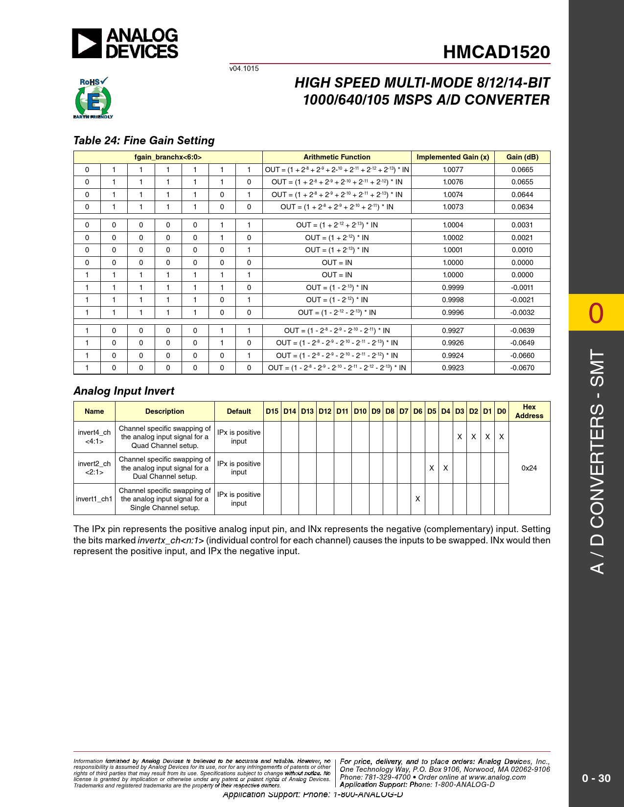

HigH Speed Multi-Mode 8/12/14-Bit 1000/640/105 MSpS A/d Converter table 24: Fine gain Setting fgain_branchx<6:0> Arithmetic Function Implemented Gain (x) Gain (dB)
0 1 1 1 1 1 1 oUt = (1 + 2-8 + 2-9 + 2-10 + 2-11 + 2-12 + 2-13) * In 1.0077 0.0665 0 1 1 1 1 1 0 oUt = (1 + 2-8 + 2-9 + 2-10 + 2-11 + 2-12) * In 1.0076 0.0655 0 1 1 1 1 0 1 oUt = (1 + 2-8 + 2-9 + 2-10 + 2-11 + 2-13) * In 1.0074 0.0644 0 1 1 1 1 0 0 oUt = (1 + 2-8 + 2-9 + 2-10 + 2-11) * In 1.0073 0.0634 0 0 0 0 0 1 1 oUt = (1 + 2-12 + 2-13) * In 1.0004 0.0031 0 0 0 0 0 1 0 oUt = (1 + 2-12) * In 1.0002 0.0021 0 0 0 0 0 0 1 oUt = (1 + 2-13) * In 1.0001 0.0010 0 0 0 0 0 0 0 oUt = In 1.0000 0.0000 1 1 1 1 1 1 1 oUt = In 1.0000 0.0000 1 1 1 1 1 1 0 oUt = (1 - 2-13) * In 0.9999 -0.0011 1 1 1 1 1 0 1 oUt = (1 - 2-12) * In 0.9998 -0.0021 1 1 1 1 1 0 0 oUt = (1 - 2-12 - 2-13) * In 0.9996 -0.0032 0 1 0 0 0 0 1 1 oUt = (1 - 2-8 - 2-9 - 2-10 - 2-11) * In 0.9927 -0.0639 1 0 0 0 0 1 0 oUt = (1 - 2-8 - 2-9 - 2-10 - 2-11 - 2-13) * In 0.9926 -0.0649 1 0 0 0 0 0 1 oUt = (1 - 2-8 - 2-9 - 2-10 - 2-11 - 2-12) * In 0.9924 -0.0660 t 1 0 0 0 0 0 0 oUt = (1 - 2-8 - 2-9 - 2-10 - 2-11 - 2-12 - 2-13) * In 0.9923 -0.0670 M s
Analog input invert Hex Name Description Default D15 D14 D13 D12 D11 D10 D9 D8 D7 D6 D5 D4 D3 D2 D1 D0 Address
s - Channel specific swapping of r invert4_ch IPx is positive the analog input signal for a X X X X <4:1> input e Quad Channel setup. t Channel specific swapping of invert2_ch IPx is positive r the analog input signal for a X X 0x24 <2:1> input Dual Channel setup. e v Channel specific swapping of IPx is positive invert1_ch1 the analog input signal for a X n input single Channel setup. o the IPx pin represents the positive analog input pin, and Inx represents the negative (complementary) input. setting the bits marked invertx_ch<n:1> (individual control for each channel) causes the inputs to be swapped. Inx would then represent the positive input, and IPx the negative input. A / D C Informatio For price, delivery, and to place orders: Analog Devices, Inc., One Technology Way, P.O. Box 9106, Norwood, n furnished by Analog Devices is believed to be accurate and reliable. However, no For price, delivery, and to place orders: Analog Devices, Inc., responsibility is assumed by Analog Devices for its use, nor for any infringement MA 02062-9106 s of patents or other One Technology Way, P.O. Box 9106, Norwood, MA 02062-9106 rights of third parties that may result from its use. Specifications subject to change without notice. No license is granted by implication or otherwise Phone: 781-329-4700 • Order online at www.analog.com Phone: 781-329-4700 • Order online at www.analog.com under any patent or patent rights of Analog Devices.
