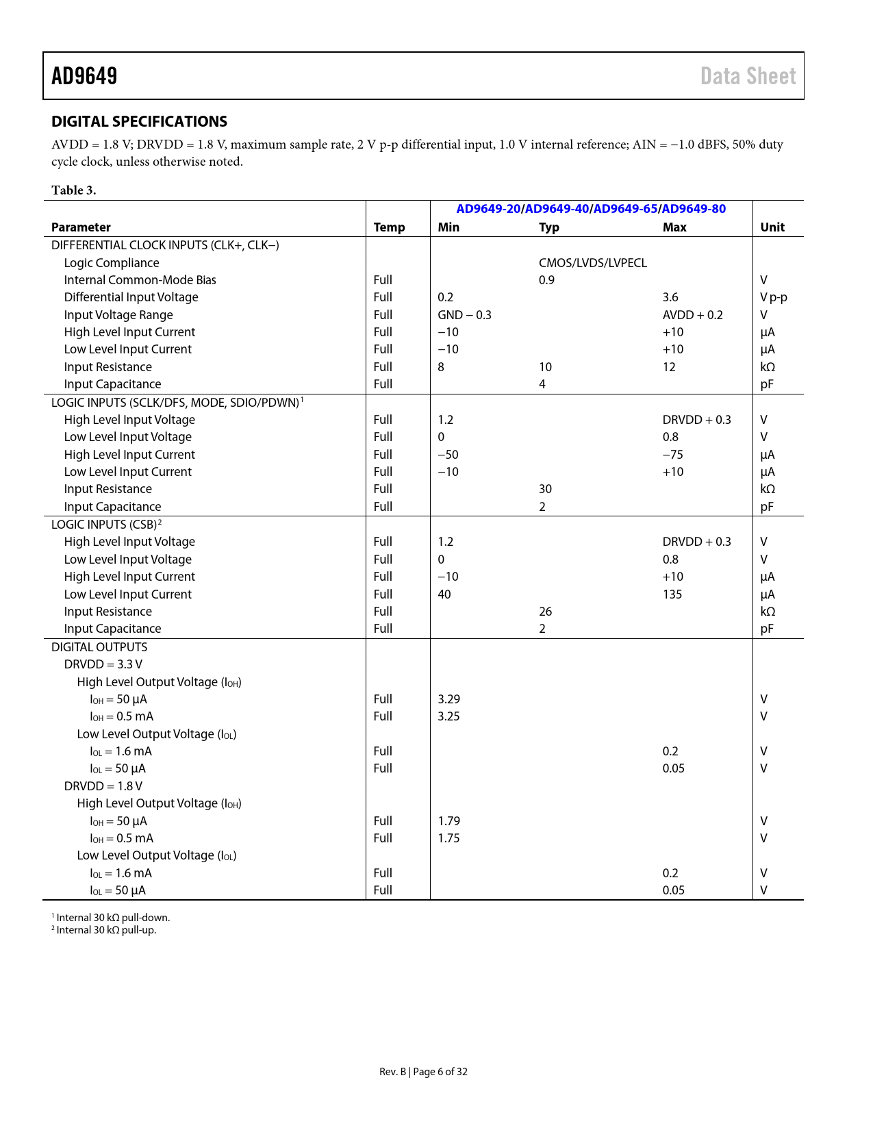

AD9649. Data Sheet. DIGITAL SPECIFICATIONS. Table 3. AD9649-20/AD9649-40/AD9649-65/AD9649-80. Parameter. Temp. Min. Typ. Max. Unit
AD9649 Data Sheet DIGITAL SPECIFICATIONS Table 3 AD9649-20/AD9649-40/AD9649-65/AD9649-80 Parameter Temp Min Typ Max Unit
AVDD = 1.8 V; DRVDD = 1.8 V, maximum sample rate, 2 V p-p differential input, 1.0 V internal reference; AIN = −1.0 dBFS, 50% duty cycle clock, unless otherwise noted.
Table 3. AD9649-20/AD9649-40/AD9649-65/AD9649-80 Parameter Temp Min Typ Max Unit
DIFFERENTIAL CLOCK INPUTS (CLK+, CLK−) Logic Compliance CMOS/LVDS/LVPECL Internal Common-Mode Bias Full 0.9 V Differential Input Voltage Full 0.2 3.6 V p-p Input Voltage Range Full GND − 0.3 AVDD + 0.2 V High Level Input Current Full −10 +10 µA Low Level Input Current Full −10 +10 µA Input Resistance Full 8 10 12 kΩ Input Capacitance Full 4 pF LOGIC INPUTS (SCLK/DFS, MODE, SDIO/PDWN)1 High Level Input Voltage Full 1.2 DRVDD + 0.3 V Low Level Input Voltage Full 0 0.8 V High Level Input Current Full −50 −75 µA Low Level Input Current Full −10 +10 µA Input Resistance Full 30 kΩ Input Capacitance Full 2 pF LOGIC INPUTS (CSB)2 High Level Input Voltage Full 1.2 DRVDD + 0.3 V Low Level Input Voltage Full 0 0.8 V High Level Input Current Full −10 +10 µA Low Level Input Current Full 40 135 µA Input Resistance Full 26 kΩ Input Capacitance Full 2 pF DIGITAL OUTPUTS DRVDD = 3.3 V High Level Output Voltage (IOH) IOH = 50 µA Full 3.29 V IOH = 0.5 mA Full 3.25 V Low Level Output Voltage (IOL) IOL = 1.6 mA Full 0.2 V IOL = 50 µA Full 0.05 V DRVDD = 1.8 V High Level Output Voltage (IOH) IOH = 50 µA Full 1.79 V IOH = 0.5 mA Full 1.75 V Low Level Output Voltage (IOL) IOL = 1.6 mA Full 0.2 V IOL = 50 µA Full 0.05 V 1 Internal 30 kΩ pull-down. 2 Internal 30 kΩ pull-up. Rev. B | Page 6 of 32 Document Outline FEATURES APPLICATIONS FUNCTIONAL BLOCK DIAGRAM PRODUCT HIGHLIGHTS REVISION HISTORY GENERAL DESCRIPTION SPECIFICATIONS DC SPECIFICATIONS AC SPECIFICATIONS DIGITAL SPECIFICATIONS SWITCHING SPECIFICATIONS TIMING SPECIFICATIONS ABSOLUTE MAXIMUM RATINGS THERMAL CHARACTERISTICS ESD CAUTION PIN CONFIGURATION AND FUNCTION DESCRIPTIONS TYPICAL PERFORMANCE CHARACTERISTICS AD9649-80 AD9649-65 AD9649-40 AD9649-20 EQUIVALENT CIRCUITS THEORY OF OPERATION ANALOG INPUT CONSIDERATIONS Input Common Mode Differential Input Configurations Single-Ended Input Configuration VOLTAGE REFERENCE Internal Reference Connection External Reference Operation CLOCK INPUT CONSIDERATIONS Clock Input Options Input Clock Divider Clock Duty Cycle Jitter Considerations POWER DISSIPATION AND STANDBY MODE DIGITAL OUTPUTS Digital Output Enable Function (OEB) TIMING Data Clock Output (DCO) BUILT-IN SELF-TEST (BIST) AND OUTPUT TEST BUILT-IN SELF-TEST (BIST) OUTPUT TEST MODES SERIAL PORT INTERFACE (SPI) CONFIGURATION USING THE SPI HARDWARE INTERFACE CONFIGURATION WITHOUT THE SPI SPI ACCESSIBLE FEATURES MEMORY MAP READING THE MEMORY MAP REGISTER TABLE OPEN LOCATIONS DEFAULT VALUES Logic Levels Transfer Register Map MEMORY MAP REGISTER TABLE MEMORY MAP REGISTER DESCRIPTIONS USR2 (Register 0x101) Bit 3—Enable GCLK Detect Bit 2—Run GCLK Bit 0—Disable SDIO Pull-Down APPLICATIONS INFORMATION DESIGN GUIDELINES Power and Ground Recommendations Exposed Paddle Thermal Heat Sink Recommendations Encode Clock VCM RBIAS Reference Decoupling SPI Port Soft Reset OUTLINE DIMENSIONS ORDERING GUIDE
