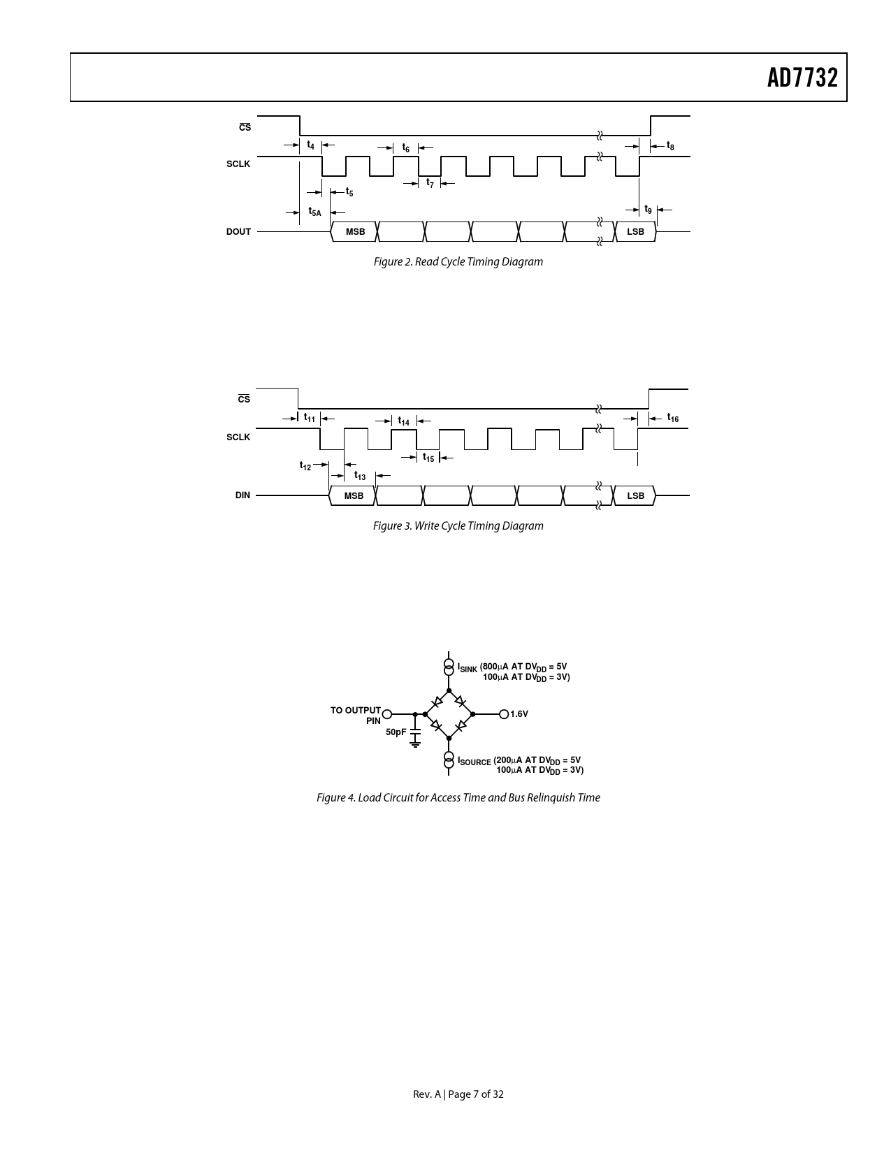

AD7732. SCLK. DOUT. MSB. LSB. t11. t16. t15. t12. t13. DIN. ISINK (800. A AT DVDD = 5V. 100. A AT DVDD = 3V). TO OUTPUT. 1.6V. PIN. 50pF. ISOURCE (200
AD7732 SCLK DOUT MSB LSB t11 t16 t15 t12 t13 DIN ISINK (800 A AT DVDD = 5V 100 A AT DVDD = 3V) TO OUTPUT 1.6V PIN 50pF ISOURCE (200
AD7732 CS t4 t t 6 8 SCLK t7 t5 t t 5A 9 DOUT MSB LSB
Figure 2. Read Cycle Timing Diagram
CS t11 t t16 14 SCLK t15 t12 t13 DIN MSB LSB
Figure 3. Write Cycle Timing Diagram
ISINK (800
μ
A AT DVDD = 5V 100
μ
μ
A AT DVDD = 5V 100
μ
A AT DVDD = 3V)
Figure 4. Load Circuit for Access Time and Bus Relinquish Time Rev. A | Page 7 of 32 Document Outline FEATURES APPLICATIONS GENERAL DESCRIPTION FUNCTIONAL BLOCK DIAGRAM REVISION HISTORY AD7732—SPECIFICATIONS Table 1. (–40°C to +105°C; AVDD = 5 V ± 5%; DVDD = 2.7 V to 3.6 V, or 5 V ± 5%; BIAS (all), REFIN(+) = 2.5 V; REFIN(–) = AGND; RA, RB, RC, RD open circuit; AIN Range = ±10 V; fMCLKIN = 6.144 MHz; unless otherwise noted.) TIMING SPECIFICATIONS Table 2. (AVDD = 5 V ± 5%; DVDD = 2.7 V to 3.6 V, or 5 V ± 5%; Input Logic 0 = 0 V; Logic 1 = DVDD; unless otherwise noted.) ABSOLUTE MAXIMUM RATINGS Table 3. TA = 25°C, unless otherwise noted. TYPICAL PERFORMANCE CHARACTERISTICS OUTPUT NOISE AND RESOLUTION SPECIFICATION Chopping Enabled Table 4. Typical Output RMS Noise in µV vs. Conversion Time and Input Range with Chopping Enabled Table 5. Typical Effective Resolution in Bits vs. Conversion Time and Input Range with Chopping Enabled Table 6. Typical Peak-to-Peak Resolution in Bits vs. Conversion Time and Input Range with Chopping Enabled Chopping Disabled Table 7. Typical Output RMS Noise in µV vs. Conversion Time and Input Range with Chopping Disabled Table 8. Typical Effective Resolution in Bits vs. Conversion Time and Input Range with Chopping Disabled Table 9. Typical Peak-to-Peak Resolution in Bits vs. Conversion Time and Input Range with Chopping Disabled PIN CONFIGURATIONS AND FUNCTIONAL DESCRIPTIONS Table 10. Pin Function Descriptions—28-Lead TSSOP REGISTER DESCRIPTION Table 11. Register Summary Table 12. Operational Mode Summary Table 13. Input Range Summary Register Access Communications Register Table 14. I/O Port Register Revision Register Test Register ADC Status Register Checksum Register ADC Zero-Scale Calibration Register ADC Full-Scale Register Channel Data Registers Channel Zero-Scale Calibration Registers Channel Full-Scale Calibration Registers Channel Status Registers Channel Setup Registers Table 15. Channel Conversion Time Registers Mode Register DIGITAL INTERFACE DESCRIPTION Hardware Reset Access the AD7732 Registers Single Conversion and Reading Data Dump Mode Continuous Conversion Mode Continuous Read (Continuous Conversion) Mode CIRCUIT DESCRIPTION Analog Front End Analog Input’s Extended Voltage Range Table 16. Extended Input Voltage Range, Nominal Voltage Range ±10 V, 16 Bits, CLAMP = 0 Table 17. Extended Input Voltage Range, Nominal Voltage Range 0 V to +10 V, 16 Bits, CLAMP = 0 Chopping Multiplexer, Conversion, and Data Output Timing Sigma-Delta ADC Frequency Response Voltage Reference Inputs Reference Detect I/O Port Calibration ADC Zero-Scale Self-Calibration Per Channel System Calibration High Common-Mode Voltage Application OUTLINE DIMENSIONS Ordering Guide
