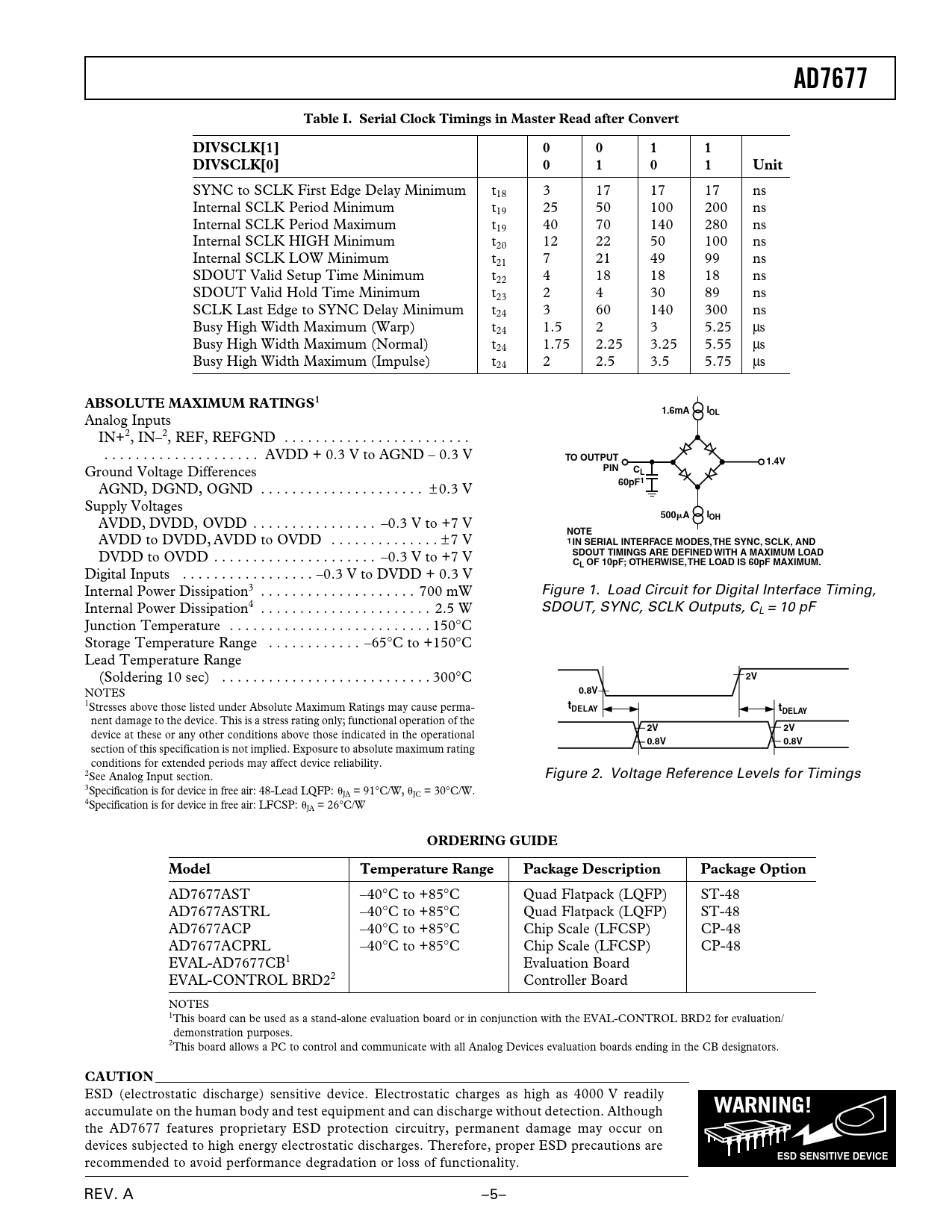

AD7677. Table I. Serial Clock Timings in Master Read after Convert. DIVSCLK[1]. DIVSCLK[0]. Unit. ABSOLUTE MAXIMUM RATINGS1. 1.6mA
AD7677 Table I Serial Clock Timings in Master Read after Convert DIVSCLK[1] DIVSCLK[0] Unit ABSOLUTE MAXIMUM RATINGS1 1.6mA
AD7677 Table I. Serial Clock Timings in Master Read after Convert DIVSCLK[1] 0 0 1 1 DIVSCLK[0] 0 1 0 1 Unit
SYNC to SCLK First Edge Delay Minimum t18 3 17 17 17 ns Internal SCLK Period Minimum t19 25 50 100 200 ns Internal SCLK Period Maximum t19 40 70 140 280 ns Internal SCLK HIGH Minimum t20 12 22 50 100 ns Internal SCLK LOW Minimum t21 7 21 49 99 ns SDOUT Valid Setup Time Minimum t22 4 18 18 18 ns SDOUT Valid Hold Time Minimum t23 2 4 30 89 ns SCLK Last Edge to SYNC Delay Minimum t24 3 60 140 300 ns Busy High Width Maximum (Warp) t24 1.5 2 3 5.25 µs Busy High Width Maximum (Normal) t24 1.75 2.25 3.25 5.55 µs Busy High Width Maximum (Impulse) t24 2 2.5 3.5 5.75 µs
ABSOLUTE MAXIMUM RATINGS1 1.6mA IOL
Analog Inputs IN+2, IN–2, REF, REFGND . AVDD + 0.3 V to AGND – 0.3 V
TO OUTPUT 1.4V
Ground Voltage Differences
PIN CL
AGND, DGND, OGND . ± 0.3 V
60pF1
Supply Voltages
500 A I
AVDD, DVDD, OVDD . –0.3 V to +7 V
OH NOTE
AVDD to DVDD, AVDD to OVDD . ± 7 V
1 IN SERIAL INTERFACE MODES, THE SYNC, SCLK, AND
DVDD to OVDD . –0.3 V to +7 V
SDOUT TIMINGS ARE DEFINED WITH A MAXIMUM LOAD CL OF 10pF; OTHERWISE, THE LOAD IS 60pF MAXIMUM.
Digital Inputs . –0.3 V to DVDD + 0.3 V Internal Power Dissipation3 . 700 mW Figure 1. Load Circuit for Digital Interface Timing, Internal Power Dissipation4 . 2.5 W SDOUT, SYNC, SCLK Outputs, CL = 10 pF Junction Temperature . 150°C Storage Temperature Range . –65°C to +150°C Lead Temperature Range (Soldering 10 sec) . 300°C
2V
NOTES
0.8V
1Stresses above those listed under Absolute Maximum Ratings may cause perma-
tDELAY tDELAY
nent damage to the device. This is a stress rating only; functional operation of the
2V 2V
device at these or any other conditions above those indicated in the operational
0.8V 0.8V
section of this specification is not implied. Exposure to absolute maximum rating conditions for extended periods may affect device reliability. 2See Analog Input section. Figure 2. Voltage Reference Levels for Timings 3Specification is for device in free air: 48-Lead LQFP: ␪JA = 91°C/W, ␪JC = 30°C/W. 4Specification is for device in free air: LFCSP: ␪JA = 26°C/W
ORDERING GUIDE Model Temperature Range Package Description Package Option
AD7677AST –40°C to +85°C Quad Flatpack (LQFP) ST-48 AD7677ASTRL –40°C to +85°C Quad Flatpack (LQFP) ST-48 AD7677ACP –40°C to +85°C Chip Scale (LFCSP) CP-48 AD7677ACPRL –40°C to +85°C Chip Scale (LFCSP) CP-48 EVAL-AD7677CB1 Evaluation Board EVAL-CONTROL BRD22 Controller Board NOTES 1This board can be used as a stand-alone evaluation board or in conjunction with the EVAL-CONTROL BRD2 for evaluation/ demonstration purposes. 2This board allows a PC to control and communicate with all Analog Devices evaluation boards ending in the CB designators.
