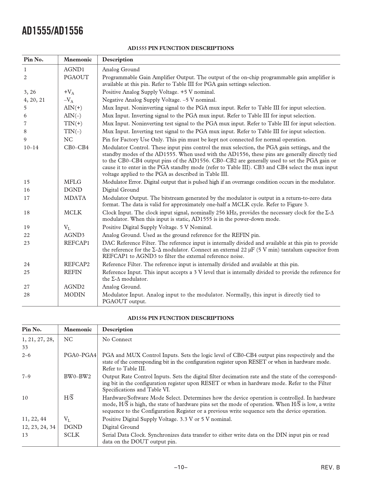

AD1555/AD1556. AD1555 PIN FUNCTION DESCRIPTIONS. Pin No. Mnemonic. Description. AD1556 PIN FUNCTION DESCRIPTIONS
AD1555/AD1556 AD1555 PIN FUNCTION DESCRIPTIONS Pin No Mnemonic Description AD1556 PIN FUNCTION DESCRIPTIONS
AD1555/AD1556 AD1555 PIN FUNCTION DESCRIPTIONS Pin No. Mnemonic Description
1 AGND1 Analog Ground 2 PGAOUT Programmable Gain Amplifier Output. The output of the on-chip programmable gain amplifier is available at this pin. Refer to Table III for PGA gain settings selection. 3, 26 +VA Positive Analog Supply Voltage. +5 V nominal. 4, 20, 21 –VA Negative Analog Supply Voltage. –5 V nominal. 5 AIN(+) Mux Input. Noninverting signal to the PGA mux input. Refer to Table III for input selection. 6 AIN(–) Mux Input. Inverting signal to the PGA mux input. Refer to Table III for input selection. 7 TIN(+) Mux Input. Noninverting test signal to the PGA mux input. Refer to Table III for input selection. 8 TIN(–) Mux Input. Inverting test signal to the PGA mux input. Refer to Table III for input selection. 9 NC Pin for Factory Use Only. This pin must be kept not connected for normal operation. 10–14 CB0–CB4 Modulator Control. These input pins control the mux selection, the PGA gain settings, and the standby modes of the AD1555. When used with the AD1556, these pins are generally directly tied to the CB0–CB4 output pins of the AD1556. CB0–CB2 are generally used to set the PGA gain or cause it to enter in the PGA standby mode (refer to Table III). CB3 and CB4 select the mux input voltage applied to the PGA as described in Table III. 15 MFLG Modulator Error. Digital output that is pulsed high if an overrange condition occurs in the modulator. 16 DGND Digital Ground 17 MDATA Modulator Output. The bitstream generated by the modulator is output in a return-to-zero data format. The data is valid for approximately one-half a MCLK cycle. Refer to Figure 3. 18 MCLK Clock Input. The clock input signal, nominally 256 kHz, provides the necessary clock for the Σ-∆ modulator. When this input is static, AD1555 is in the power-down mode. 19 VL Positive Digital Supply Voltage. 5 V Nominal. 22 AGND3 Analog Ground. Used as the ground reference for the REFIN pin. 23 REFCAP1 DAC Reference Filter. The reference input is internally divided and available at this pin to provide the reference for the ⌺-⌬ modulator. Connect an external 22 µF (5 V min) tantalum capacitor from REFCAP1 to AGND3 to filter the external reference noise. 24 REFCAP2 Reference Filter. The reference input is internally divided and available at this pin. 25 REFIN Reference Input. This input accepts a 3 V level that is internally divided to provide the reference for the Σ-∆ modulator. 27 AGND2 Analog Ground. 28 MODIN Modulator Input. Analog input to the modulator. Normally, this input is directly tied to PGAOUT output.
AD1556 PIN FUNCTION DESCRIPTIONS Pin No. Mnemonic Description
1, 21, 27, 28, NC No Connect 33 2–6 PGA0–PGA4 PGA and MUX Control Inputs. Sets the logic level of CB0-CB4 output pins respectively and the state of the corresponding bit in the configuration register upon RESET or when in hardware mode. Refer to Table III. 7–9 BW0–BW2 Output Rate Control Inputs. Sets the digital filter decimation rate and the state of the correspond- ing bit in the configuration register upon RESET or when in hardware mode. Refer to the Filter Specifications and Table VI. 10 H/S Hardware/Software Mode Select. Determines how the device operation is controlled. In hardware mode, H/S is high, the state of hardware pins set the mode of operation. When H/S is low, a write sequence to the Configuration Register or a previous write sequence sets the device operation. 11, 22, 44 VL Positive Digital Supply Voltage. 3.3 V or 5 V nominal. 12, 23, 24, 34 DGND Digital Ground 13 SCLK Serial Data Clock. Synchronizes data transfer to either write data on the DIN input pin or read data on the DOUT output pin. –10– REV. B
