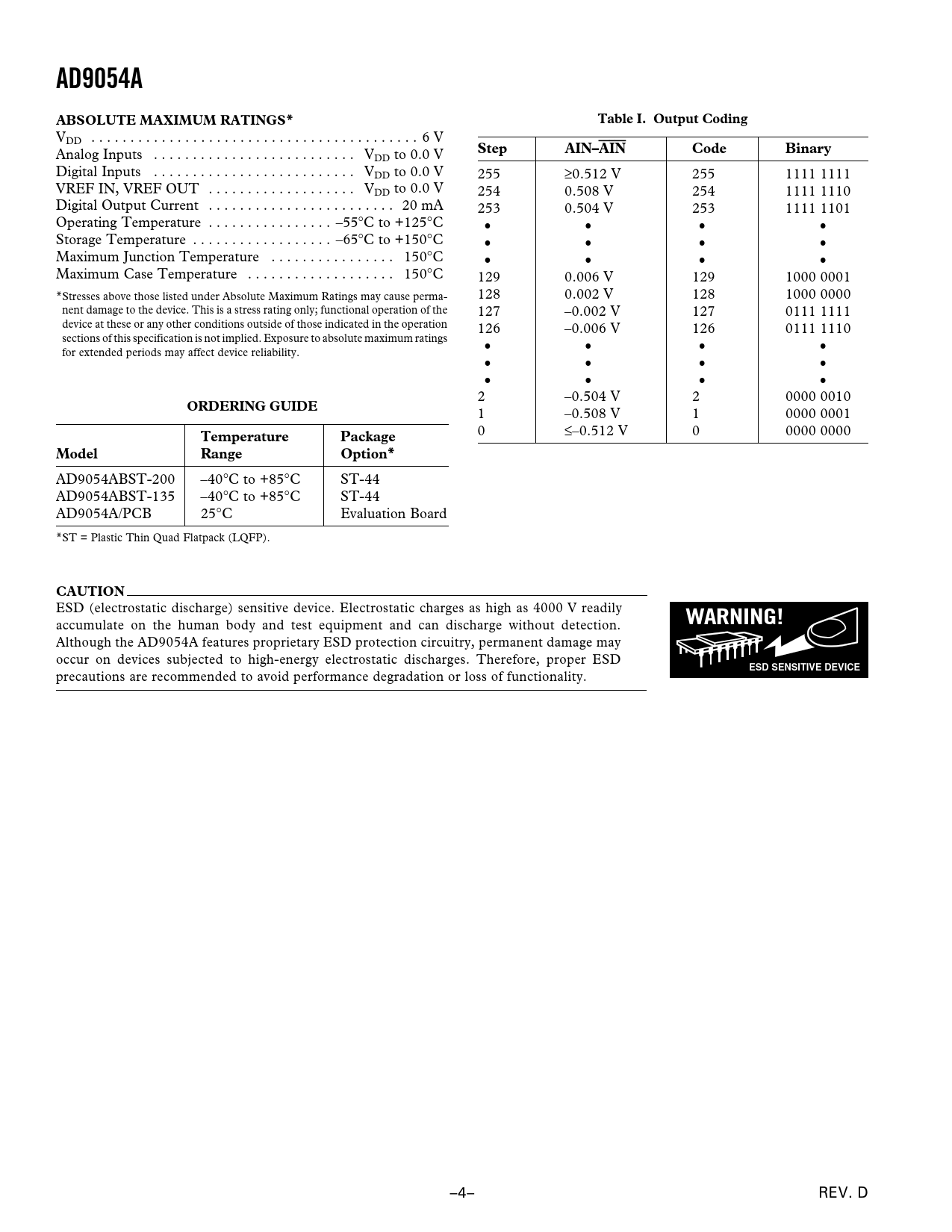

AD9054A. ABSOLUTE MAXIMUM RATINGS*. Table I. Output Coding. Step. AIN–AIN. Code. Binary. ORDERING GUIDE. Temperature. Package. Model. Range
AD9054A ABSOLUTE MAXIMUM RATINGS* Table I Output Coding Step AIN–AIN Code Binary ORDERING GUIDE Temperature Package Model Range
AD9054A ABSOLUTE MAXIMUM RATINGS* Table I. Output Coding
VDD . 6 V Analog Inputs . V
DD to 0.0 V Digital Inputs . VDD to 0.0 V 255 ≥0.512 V 255 1111 1111 VREF IN, VREF OUT . VDD to 0.0 V 254 0.508 V 254 1111 1110 Digital Output Current . 20 mA 253 0.504 V 253 1111 1101 Operating Temperature . –55°C to +125°C • • • • Storage Temperature . –65°C to +150°C • • • • Maximum Junction Temperature . 150°C • • • • Maximum Case Temperature . 150°C 129 0.006 V 129 1000 0001 *Stresses above those listed under Absolute Maximum Ratings may cause perma- 128 0.002 V 128 1000 0000 nent damage to the device. This is a stress rating only; functional operation of the 127 –0.002 V 127 0111 1111 device at these or any other conditions outside of those indicated in the operation 126 –0.006 V 126 0111 1110 sections of this specification is not implied. Exposure to absolute maximum ratings • • • • for extended periods may affect device reliability. • • • • • • • • 2 –0.504 V 2 0000 0010
ORDERING GUIDE
1 –0.508 V 1 0000 0001
Temperature Package
0 ≤–0.512 V 0 0000 0000
Model Range Option*
AD9054ABST-200 –40°C to +85°C ST-44 AD9054ABST-135 –40°C to +85°C ST-44 AD9054A/PCB 25°C Evaluation Board *ST = Plastic Thin Quad Flatpack (LQFP).
CAUTION
ESD (electrostatic discharge) sensitive device. Electrostatic charges as high as 4000 V readily
WARNING!
accumulate on the human body and test equipment and can discharge without detection. Although the AD9054A features proprietary ESD protection circuitry, permanent damage may occur on devices subjected to high-energy electrostatic discharges. Therefore, proper ESD
ESD SENSITIVE DEVICE
precautions are recommended to avoid performance degradation or loss of functionality. –4– REV. D
