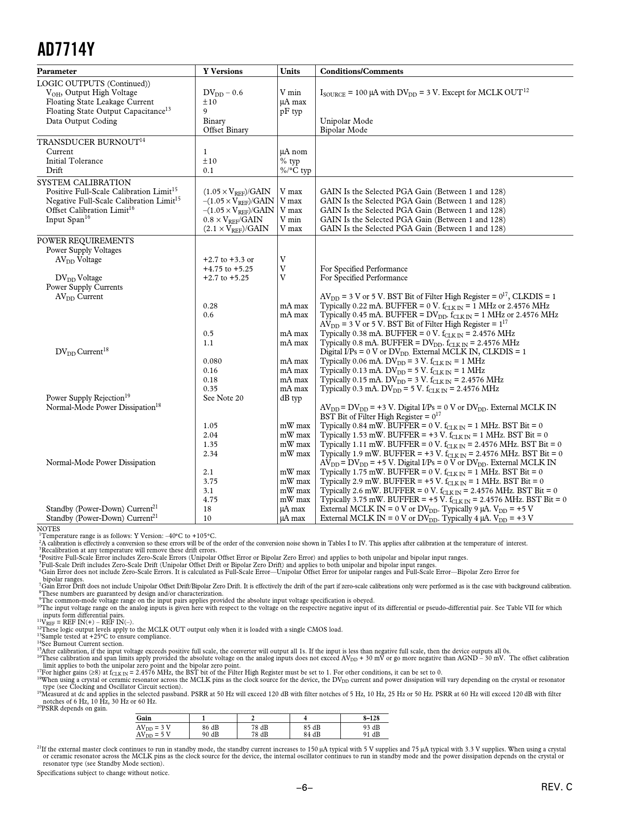

DescriptionCMOS, 3V/5V, 500 µA, 24-Bit Sigma-Delta, Signal Conditioning ADC

LOGIC OUTPUTS (Continued)) VOH, Output High Voltage DVDD – 0.6 V min ISOURCE = 100 µA with DVDD = 3 V. Except for MCLK OUT12 Floating State Leakage Current ±10 µA max Floating State Output Capacitance13 9 pF typ Data Output Coding Binary Unipolar Mode Offset Binary Bipolar Mode TRANSDUCER BURNOUT14 Current 1 µA nom Initial Tolerance ±10 % typ Drift 0.1 %/°C typ SYSTEM CALIBRATION Positive Full-Scale Calibration Limit15 (1.05 × VREF)/GAIN V max GAIN Is the Selected PGA Gain (Between 1 and 128) Negative Full-Scale Calibration Limit15 –(1.05 × VREF)/GAIN V max GAIN Is the Selected PGA Gain (Between 1 and 128) Offset Calibration Limit16 –(1.05 × VREF)/GAIN V max GAIN Is the Selected PGA Gain (Between 1 and 128) Input Span16 0.8 × VREF/GAIN V min GAIN Is the Selected PGA Gain (Between 1 and 128) (2.1 × VREF)/GAIN V max GAIN Is the Selected PGA Gain (Between 1 and 128) POWER REQUIREMENTS Power Supply Voltages AVDD Voltage +2.7 to +3.3 or V +4.75 to +5.25 V For Specified Performance DVDD Voltage +2.7 to +5.25 V For Specified Performance Power Supply Currents AVDD Current AVDD = 3 V or 5␣ V. BST Bit of Filter High Register = 017, CLKDIS = 1 0.28 mA max Typically 0.22 mA. BUFFER = 0 V. fCLK IN = 1␣ MHz or 2.4576␣ MHz 0.6 mA max Typically 0.45 mA. BUFFER = DVDD. fCLK IN = 1␣ MHz or 2.4576␣ MHz AVDD = 3 V or 5␣ V. BST Bit of Filter High Register = 117 0.5 mA max Typically 0.38␣ mA. BUFFER = 0␣ V. fCLK IN = 2.4576␣ MHz 1.1 mA max Typically 0.8␣ mA. BUFFER = DVDD. fCLK IN = 2.4576␣ MHz DVDD Current18 Digital I/Ps = 0␣ V or DVDD. External MCLK IN, CLKDIS = 1 0.080 mA max Typically 0.06␣ mA. DVDD = 3 V. fCLK IN = 1␣ MHz 0.16 mA max Typically 0.13␣ mA. DVDD = 5␣ V. fCLK IN = 1␣ MHz 0.18 mA max Typically 0.15␣ mA. DVDD = 3 V. fCLK IN = 2.4576␣ MHz 0.35 mA max Typically 0.3 mA. DVDD = 5␣ V. fCLK IN = 2.4576␣ MHz Power Supply Rejection19 See Note 20 dB typ Normal-Mode Power Dissipation18 AVDD = DVDD = +3 V. Digital I/Ps = 0␣ V or DVDD. External MCLK IN BST Bit of Filter High Register = 017 1.05 mW max Typically 0.84␣ mW. BUFFER = 0␣ V. fCLK IN = 1␣ MHz. BST Bit = 0 2.04 mW max Typically 1.53␣ mW. BUFFER = +3 V. fCLK IN = 1␣ MHz. BST Bit = 0 1.35 mW max Typically 1.11␣ mW. BUFFER = 0␣ V. fCLK IN = 2.4576␣ MHz. BST Bit = 0 2.34 mW max Typically 1.9␣ mW. BUFFER = +3 V. fCLK IN = 2.4576␣ MHz. BST Bit = 0 Normal-Mode Power Dissipation AVDD = DVDD = +5␣ V. Digital I/Ps = 0␣ V or DVDD. External MCLK IN 2.1 mW max Typically 1.75 mW. BUFFER = 0␣ V. fCLK IN = 1␣ MHz. BST Bit = 0 3.75 mW max Typically 2.9 mW. BUFFER = +5␣ V. fCLK IN = 1␣ MHz. BST Bit = 0 3.1 mW max Typically 2.6␣ mW. BUFFER = 0␣ V. fCLK IN = 2.4576␣ MHz. BST Bit = 0 4.75 mW max Typically 3.75␣ mW. BUFFER = +5␣ V. fCLK IN = 2.4576␣ MHz. BST Bit = 0 Standby (Power-Down) Current21 18 µA max External MCLK IN = 0 V or DVDD. Typically 9␣ µA. VDD = +5 V Standby (Power-Down) Current21 10 µA max External MCLK IN = 0 V or DVDD. Typically 4␣ µA. VDD = +3 V NOTES 1Temperature range is as follows: Y Version: –40°C to +105°C. 2A calibration is effectively a conversion so these errors will be of the order of the conversion noise shown in Tables I to IV. This applies after calibration at the temperature of interest. 3Recalibration at any temperature will remove these drift errors. 4Positive Full-Scale Error includes Zero-Scale Errors (Unipolar Offset Error or Bipolar Zero Error) and applies to both unipolar and bipolar input ranges. 5Full-Scale Drift includes Zero-Scale Drift (Unipolar Offset Drift or Bipolar Zero Drift) and applies to both unipolar and bipolar input ranges. 6Gain Error does not include Zero-Scale Errors. It is calculated as Full-Scale Error—Unipolar Offset Error for unipolar ranges and Full-Scale Error—Bipolar Zero Error for bipolar ranges. 7Gain Error Drift does not include Unipolar Offset Drift/Bipolar Zero Drift. It is effectively the drift of the part if zero-scale calibrations only were performed as is the case with background calibration. 8These numbers are guaranteed by design and/or characterization. 9The common-mode voltage range on the input pairs applies provided the absolute input voltage specification is obeyed. 10The input voltage range on the analog inputs is given here with respect to the voltage on the respective negative input of its differential or pseudo-differential pair. See Table VII for which inputs form differential pairs. 11VREF = REF IN(+) – REF IN(–). 12These logic output levels apply to the MCLK OUT output only when it is loaded with a single CMOS load. 13Sample tested at +25°C to ensure compliance. 14See Burnout Current section. 15After calibration, if the input voltage exceeds positive full scale, the converter will output all 1s. If the input is less than negative full scale, then the device outputs all 0s. 16These calibration and span limits apply provided the absolute voltage on the analog inputs does not exceed AVDD + 30␣ mV or go more negative than AGND␣ –␣ 30␣ mV. The offset calibration limit applies to both the unipolar zero point and the bipolar zero point. 17For higher gains (≥8) at fCLK␣ IN = 2.4576␣ MHz, the BST bit of the Filter High Register must be set to 1. For other conditions, it can be set to 0. 18When using a crystal or ceramic resonator across the MCLK pins as the clock source for the device, the DVDD current and power dissipation will vary depending on the crystal or resonator type (see Clocking and Oscillator Circuit section). 19Measured at dc and applies in the selected passband. PSRR at 50 Hz will exceed 120 dB with filter notches of 5 Hz, 10 Hz, 25 Hz or 50 Hz. PSRR at 60 Hz will exceed 120 dB with filter notches of 6 Hz, 10 Hz, 30 Hz or 60 Hz. 20PSRR depends on gain.
Gain 1 2 4 8–128
AVDD = 3 V 86 dB 78 dB 85 dB 93 dB AVDD = 5 V 90 dB 78 dB 84 dB 91 dB 21If the external master clock continues to run in standby mode, the standby current increases to 150 µA typical with 5 V supplies and 75 µA typical with 3.3 V supplies. When using a crystal or ceramic resonator across the MCLK pins as the clock source for the device, the internal oscillator continues to run in standby mode and the power dissipation depends on the crystal or resonator type (see Standby Mode section). Specifications subject to change without notice. –6– REV. C
