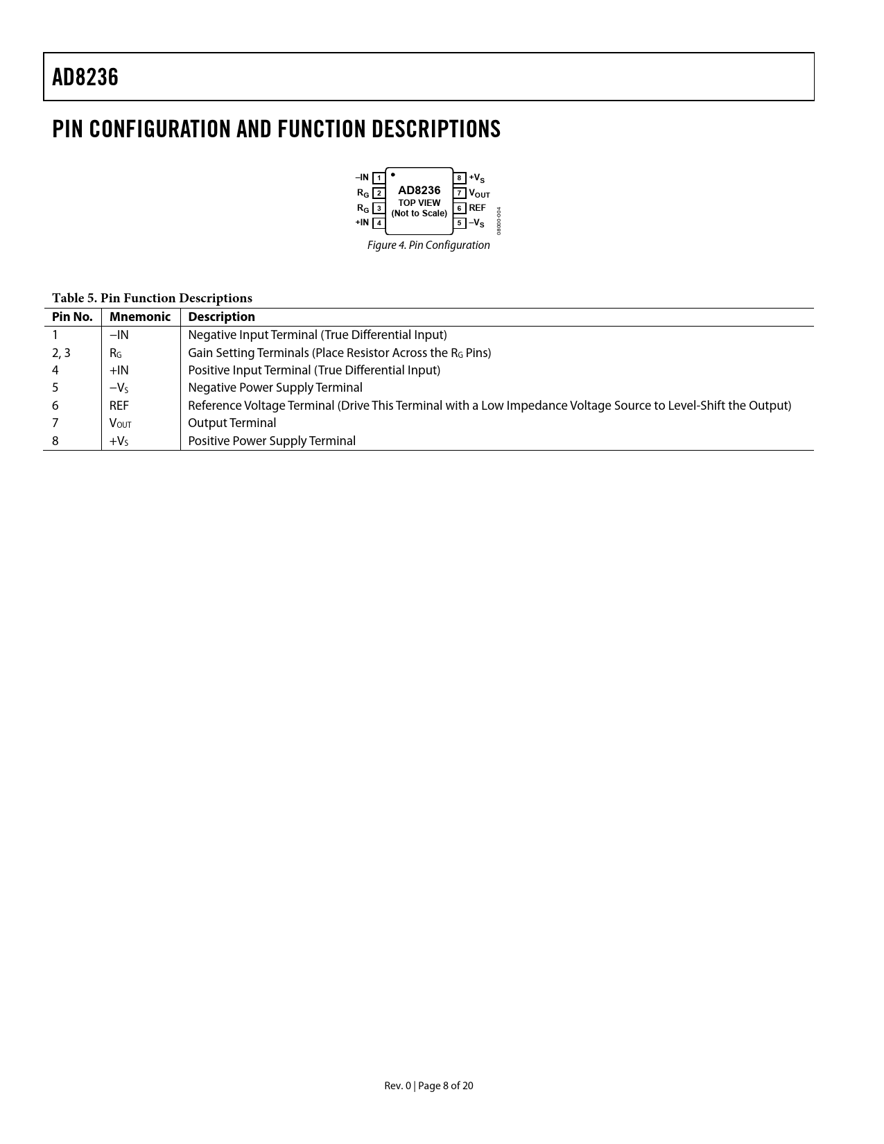

AD8236. PIN CONFIGURATION AND FUNCTION DESCRIPTIONS. –IN 1. 8 +VS. 7 VOUT. TOP VIEW. 6 REF. (Not to Scale). +IN 4. 5 –VS
AD8236 PIN CONFIGURATION AND FUNCTION DESCRIPTIONS –IN 1 8 +VS 7 VOUT TOP VIEW 6 REF (Not to Scale) +IN 4 5 –VS
AD8236 PIN CONFIGURATION AND FUNCTION DESCRIPTIONS –IN 1 8 +VS R AD8236 G 2 7 VOUT R TOP VIEW G 3 6 REF (Not to Scale)
4 -00
+IN 4 5 –VS
00 080 Figure 4. Pin Configuration
Table 5. Pin Function Descriptions Pin No. Mnemonic Description
1 −IN Negative Input Terminal (True Differential Input) 2, 3 RG Gain Setting Terminals (Place Resistor Across the RG Pins) 4 +IN Positive Input Terminal (True Differential Input) 5 −VS Negative Power Supply Terminal 6 REF Reference Voltage Terminal (Drive This Terminal with a Low Impedance Voltage Source to Level-Shift the Output) 7 VOUT Output Terminal 8 +VS Positive Power Supply Terminal Rev. 0 | Page 8 of 20 Document Outline FEATURES APPLICATIONS GENERAL DESCRIPTION CONNECTION DIAGRAM TABLE OF CONTENTS REVISION HISTORY SPECIFICATIONS ABSOLUTE MAXIMUM RATINGS MAXIMUM POWER DISSIPATION ESD CAUTION PIN CONFIGURATION AND FUNCTION DESCRIPTIONS TYPICAL PERFORMANCE CHARACTERISTICS THEORY OF OPERATION BASIC OPERATION GAIN SELECTION LAYOUT Grounding REFERENCE TERMINAL POWER SUPPLY REGULATION AND BYPASSING INPUT BIAS CURRENT RETURN PATH INPUT PROTECTION RF INTERFERENCE COMMON-MODE INPUT VOLTAGE RANGE APPLICATIONS INFORMATION AC-COUPLED INSTRUMENTATION AMPLIFIER LOW POWER HEART RATE MONITOR OUTLINE DIMENSIONS ORDERING GUIDE
