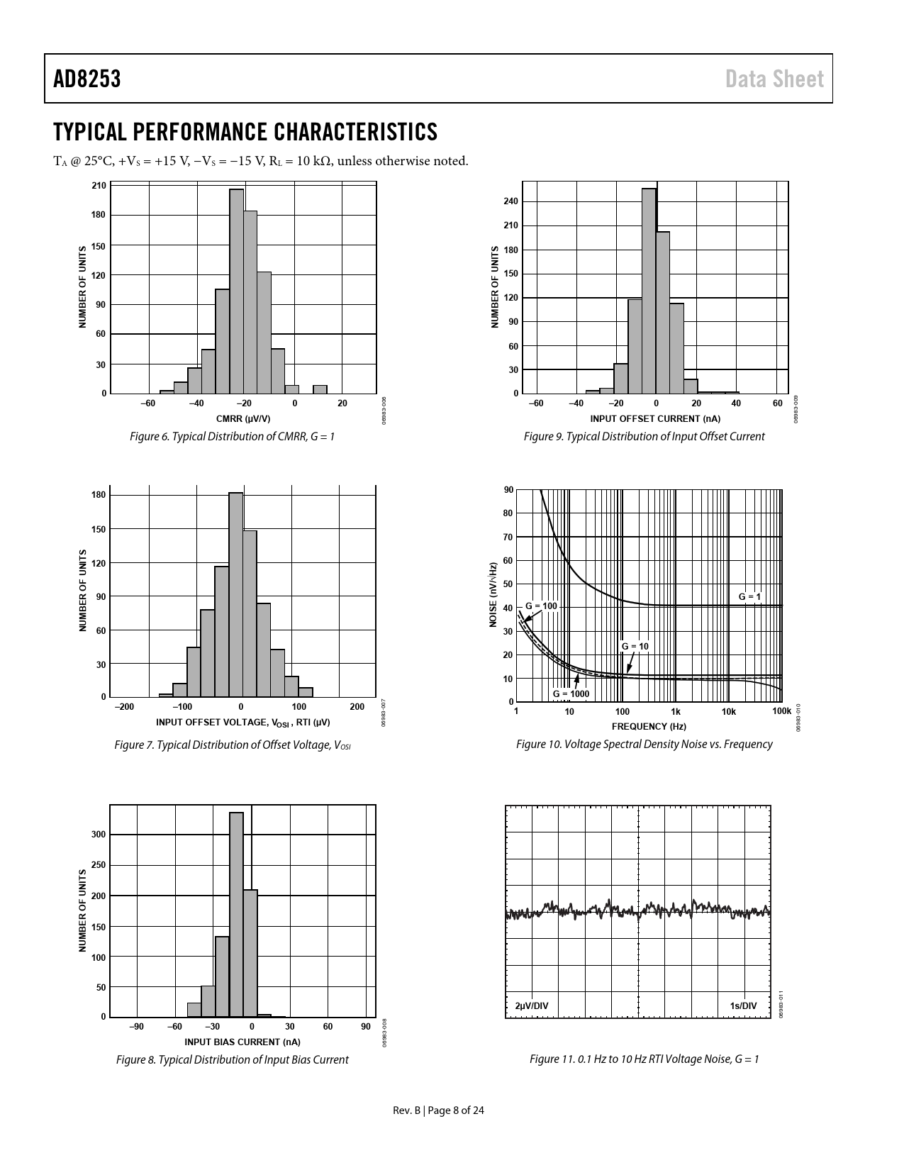

Pages / Page25 / 9 — AD8253. Data Sheet. TYPICAL PERFORMANCE CHARACTERISTICS. 210. 240. 180. S …

AD8253. Data Sheet. TYPICAL PERFORMANCE CHARACTERISTICS. 210. 240. 180. S 150. UNI. F 120. 150. R O. R O 120. –60. –40. –20. CMRR (µV/V)
AD8253 Data Sheet TYPICAL PERFORMANCE CHARACTERISTICS 210 240 180 S 150 UNI F 120 150 R O R O 120 –60 –40 –20 CMRR (µV/V)
TA @ 25°C, +VS = +15 V, −VS = −15 V, RL = 10 kΩ, unless otherwise noted.
210 240 180 210 S 150 S T 180 T UNI UNI F 120 150 F R O R O 120 BE 90 BE M M NU 90 NU 60 60 30 30 0 0

98 06 06 Figure 6. Typical Distribution of CMRR, G = 1 Figure 9. Typical Distribution of Input Offset Current

0 Figure 7. Typical Distribution of Offset Voltage, VOSI Figure 10. Voltage Spectral Density Noise vs. Frequency

98 06 Figure 8. Typical Distribution of Input Bias Current Figure 11. 0.1 Hz to 10 Hz RTI Voltage Noise, G = 1 Rev. B | Page 8 of 24 Document Outline FEATURES APPLICATIONS GENERAL DESCRIPTION FUNCTIONAL BLOCK DIAGRAM TABLE OF CONTENTS REVISION HISTORY SPECIFICATIONS TIMING DIAGRAM ABSOLUTE MAXIMUM RATINGS MAXIMUM POWER DISSIPATION ESD CAUTION PIN CONFIGURATION AND FUNCTION DESCRIPTIONS TYPICAL PERFORMANCE CHARACTERISTICS THEORY OF OPERATION GAIN SELECTION Transparent Gain Mode Latched Gain Mode Timing for Latched Gain Mode POWER SUPPLY REGULATION AND BYPASSING INPUT BIAS CURRENT RETURN PATH INPUT PROTECTION REFERENCE TERMINAL COMMON-MODE INPUT VOLTAGE RANGE LAYOUT Grounding Coupling Noise Common-Mode Rejection RF INTERFERENCE DRIVING AN ANALOG-TO-DIGITAL CONVERTER APPLICATIONS INFORMATION DIFFERENTIAL OUTPUT SETTING GAINS WITH A MICROCONTROLLER DATA ACQUISITION OUTLINE DIMENSIONS ORDERING GUIDE
