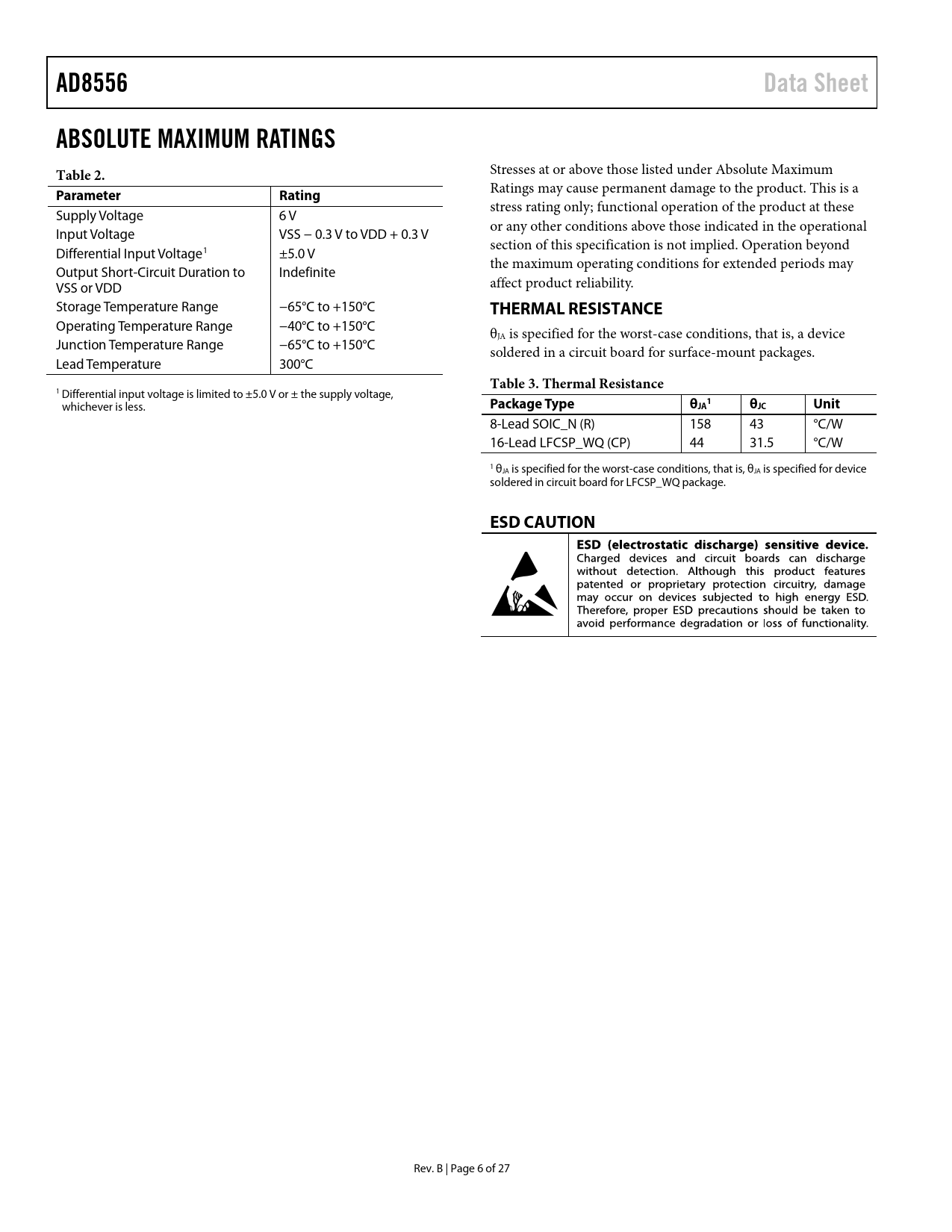

AD8556. Data Sheet. ABSOLUTE MAXIMUM RATINGS Table 2. Parameter. Rating. THERMAL RESISTANCE. Table 3. Thermal Resistance
AD8556 Data Sheet ABSOLUTE MAXIMUM RATINGS Table 2 Parameter Rating THERMAL RESISTANCE Table 3 Thermal Resistance
AD8556 Data Sheet ABSOLUTE MAXIMUM RATINGS Table 2.
Stresses at or above those listed under Absolute Maximum
Parameter Rating
Ratings may cause permanent damage to the product. This is a stress rating only; functional operation of the product at these Supply Voltage 6 V or any other conditions above those indicated in the operational Input Voltage VSS − 0.3 V to VDD + 0.3 V section of this specification is not implied. Operation beyond Differential Input Voltage1 ±5.0 V the maximum operating conditions for extended periods may Output Short-Circuit Duration to Indefinite VSS or VDD affect product reliability. Storage Temperature Range −65°C to +150°C
THERMAL RESISTANCE
Operating Temperature Range −40°C to +150°C θJA is specified for the worst-case conditions, that is, a device Junction Temperature Range −65°C to +150°C soldered in a circuit board for surface-mount packages. Lead Temperature 300°C
1 Differential input voltage is limited to ±5.0 V or ± the supply voltage, whichever is less.
Package Type θ 1 JA θJC Unit
8-Lead SOIC_N (R) 158 43 °C/W 16-Lead LFCSP_WQ (CP) 44 31.5 °C/W 1 θJA is specified for the worst-case conditions, that is, θJA is specified for device soldered in circuit board for LFCSP_WQ package.
