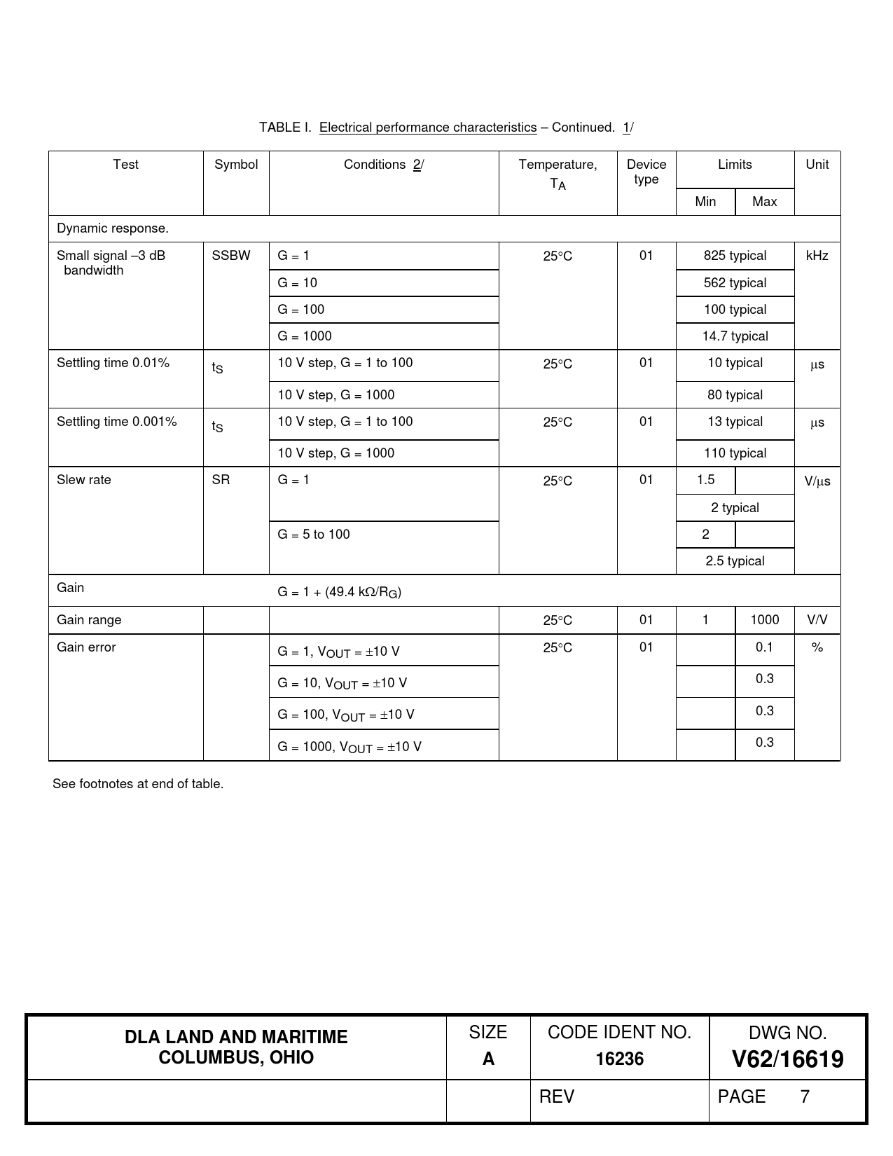

TABLE I. Electrical performance characteristics – Continued. 1/ Test Symbol Conditions 2/ Temperature, Device Limits Unit T type A Min Max Dynamic response. Small signal –3 dB SSBW G = 1 25C 01 825 typical kHz bandwidth G = 10 562 typical G = 100 100 typical G = 1000 14.7 typical Settling time 0.01% tS 10 V step, G = 1 to 100 25C 01 10 typical s 10 V step, G = 1000 80 typical Settling time 0.001% tS 10 V step, G = 1 to 100 25C 01 13 typical s 10 V step, G = 1000 110 typical Slew rate SR G = 1 25C 01 1.5 V/s 2 typical G = 5 to 100 2 2.5 typical Gain G = 1 + (49.4 k/RG) Gain range 25C 01 1 1000 V/V Gain error G = 1, VOUT = 10 V 25C 01 0.1 % G = 10, VOUT = 10 V 0.3 G = 100, VOUT = 10 V 0.3 G = 1000, VOUT = 10 V 0.3 See footnotes at end of table.
