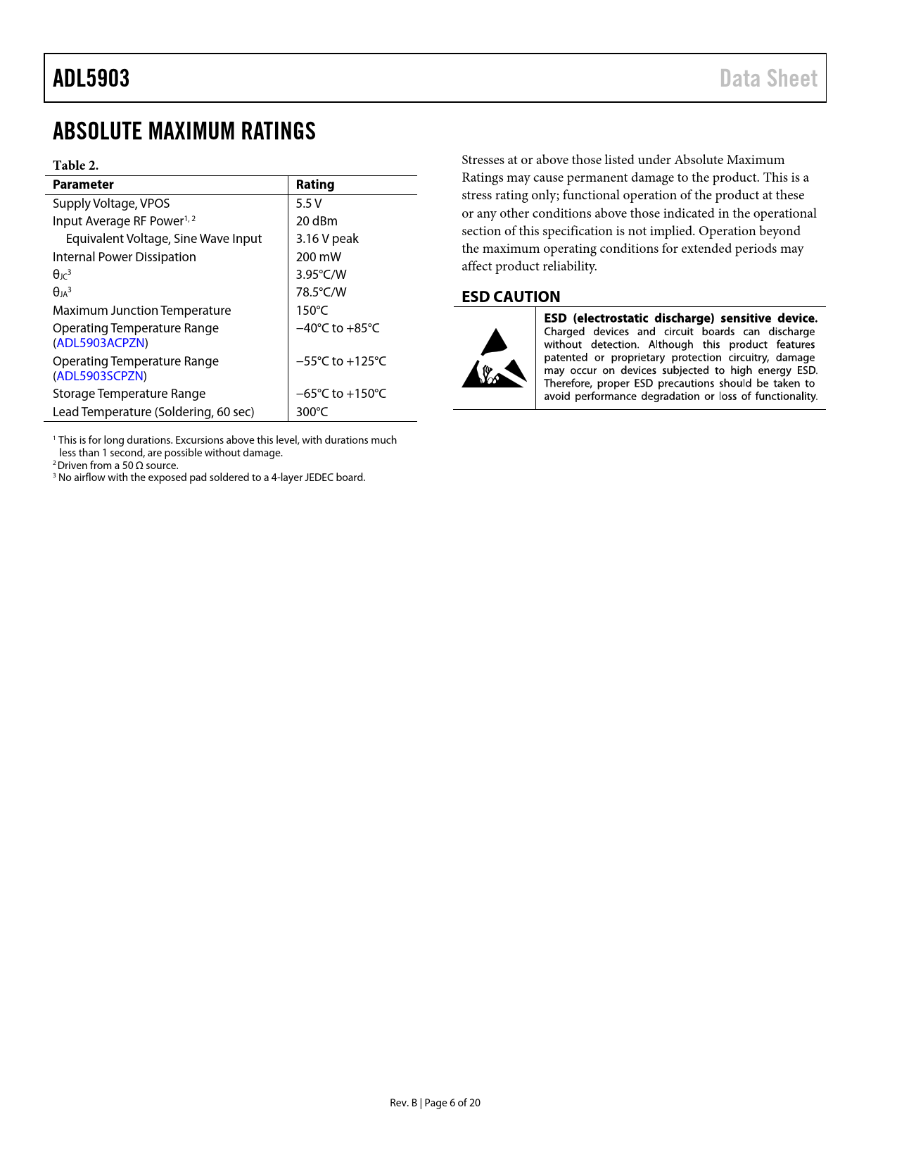

ADL5903. Data Sheet. ABSOLUTE MAXIMUM RATINGS. Table 2. Parameter Rating. ESD CAUTION
ADL5903 Data Sheet ABSOLUTE MAXIMUM RATINGS Table 2 Parameter Rating ESD CAUTION
ADL5903 Data Sheet ABSOLUTE MAXIMUM RATINGS Table 2.
Stresses at or above those listed under Absolute Maximum Ratings may cause permanent damage to the product. This is a
Parameter Rating
stress rating only; functional operation of the product at these Supply Voltage, VPOS 5.5 V or any other conditions above those indicated in the operational Input Average RF Power1, 2 20 dBm section of this specification is not implied. Operation beyond Equivalent Voltage, Sine Wave Input 3.16 V peak the maximum operating conditions for extended periods may Internal Power Dissipation 200 mW affect product reliability. θ 3 JC 3.95°C/W θ 3 JA 78.5°C/W
ESD CAUTION
Maximum Junction Temperature 150°C Operating Temperature Range −40°C to +85°C (ADL5903ACPZN) Operating Temperature Range −55°C to +125°C (ADL5903SCPZN) Storage Temperature Range −65°C to +150°C Lead Temperature (Soldering, 60 sec) 300°C 1 This is for long durations. Excursions above this level, with durations much less than 1 second, are possible without damage. 2 Driven from a 50 Ω source. 3 No airflow with the exposed pad soldered to a 4-layer JEDEC board. Rev. B | Page 6 of 20 Document Outline FEATURES APPLICATIONS FUNCTIONAL BLOCK DIAGRAM GENERAL DESCRIPTION TABLE OF CONTENTS REVISION HISTORY SPECIFICATIONS ABSOLUTE MAXIMUM RATINGS ESD CAUTION PIN CONFIGURATION AND FUNCTION DESCRIPTIONS TYPICAL PERFORMANCE CHARACTERISTICS MEASUREMENT SETUPS THEORY OF OPERATION RF INPUT INTERFACE BASIC CONNECTIONS CHOOSING A VALUE FOR CRMS DEVICE CALIBRATION AND ERROR CALCULATION EVALUATION BOARD SCHEMATIC AND CONFIGURATION OPTIONS OUTLINE DIMENSIONS ORDERING GUIDE
