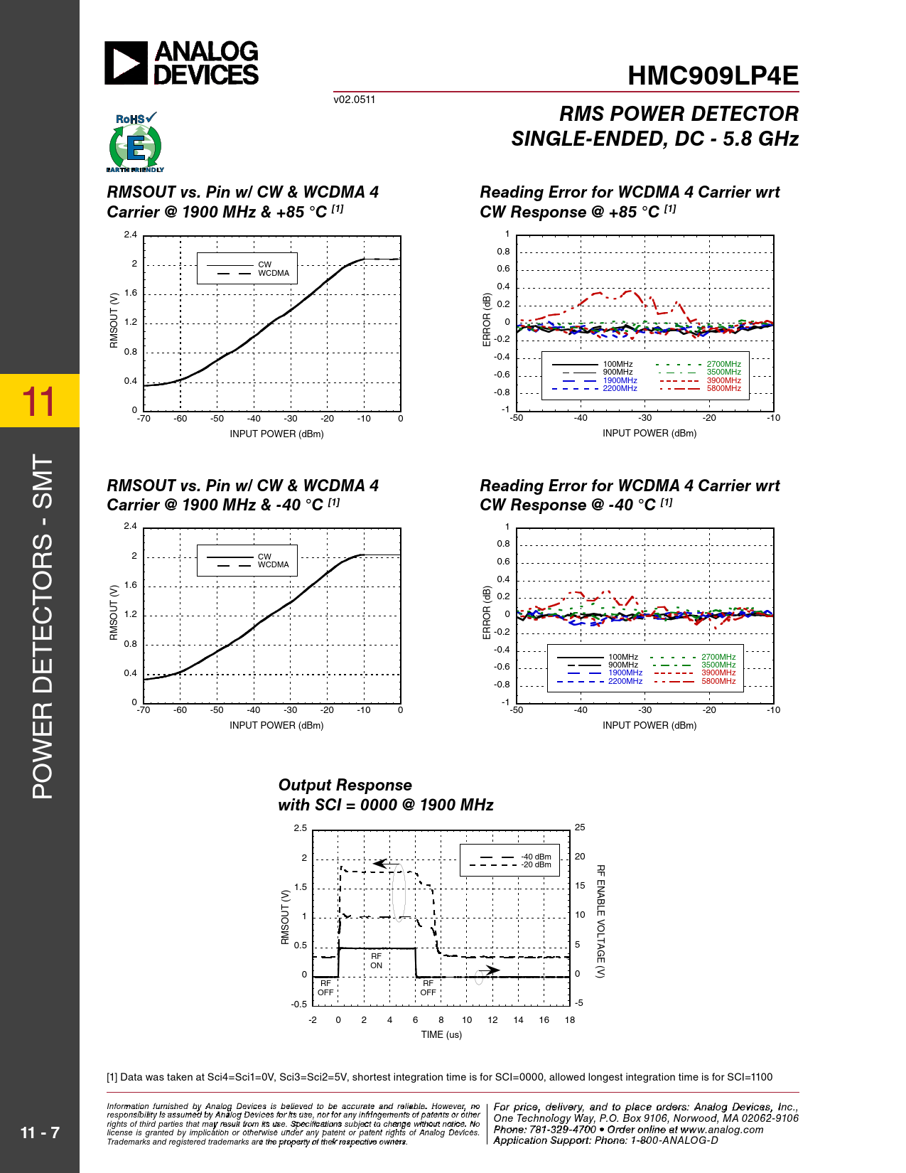

HMC909LP4E. RMS POWER DETECTOR. SINGLE-ENDED, DC - 5.8 GHz. RMSOUT vs. Pin w/ CW & WCDMA 4
HMC909LP4E RMS POWER DETECTOR SINGLE-ENDED, DC - 5.8 GHz RMSOUT vs Pin w/ CW & WCDMA 4
HMC909LP4E
v02.0511
RMS POWER DETECTOR SINGLE-ENDED, DC - 5.8 GHz RMSOUT vs. Pin w/ CW & WCDMA 4 Reading Error for WCDMA 4 Carrier wrt Carrier @ 1900 MHz & +85 °C [1] CW Response @ +85 °C [1]
2.4 1 0.8 2 CW WCDMA 0.6 0.4 1.6 (V) 0.2 (dB) 1.2 0 -0.2 RMSOUT ERROR 0.8 -0.4 100MHz 2700MHz -0.6 900MHz 3500MHz 11 0.4 1900MHz 3900MHz -0.8 2200MHz 5800MHz 0 -1 -70 -60 -50 -40 -30 -20 -10 0 -50 -40 -30 -20 -10 INPUT POWER (dBm) INPUT POWER (dBm) t M
s
Carrier @ 1900 MHz & -40 °C [1] CW Response @ -40 °C [1]
- 2.4 1 0.8 rs 2 CW 0.6 WCDMA o 0.4 t 1.6 (V) 0.2 (dB) c 1.2 0 e -0.2 t RMSOUT ERROR 0.8 -0.4 e 100MHz 2700MHz -0.6 900MHz 3500MHz 0.4 1900MHz 3900MHz D -0.8 2200MHz 5800MHz r 0 -1 -70 -60 -50 -40 -30 -20 -10 0 -50 -40 -30 -20 -10 e INPUT POWER (dBm) INPUT POWER (dBm) w o P
Output Response with SCI = 0000 @ 1900 MHz
2.5 25 2 -40 dBm 20 -20 dBm RF ENABLE 1.5 15 (V) 1 10 VOLTAGE RMSOUT 0.5 5 RF (V) ON 0 0 RF RF OFF OFF -0.5 -5 -2 0 2 4 6 8 10 12 14 16 18 TIME (us) [1] Data was taken at sci4=sci1=0V, sci3=sci2=5V, shortest integration time is for scI=0000, allowed longest integration time is for scI=1100 Info F rmoatr p ion rfiurcne is , d hed ebly ivAe n r al y a og D n evd t ice o p s is bla eli c eve o ed t rd o b e e ras: H ccuratite tiatne M d reli iac bl reo . w Ho av wev e C er, n o o For price, delivery, and to place orders: Analog Devices, Inc., responsibility is assumed by Analog Devices for its use, nor for any infringements of patents or other rporation, 20 Alpha Road, Chelmsford, MA 01824 One Technology Way, P.O. Box 9106, Norwood, MA 02062-9106 Phone: 978-250-3343 Fax: 978-250-3373 O rights of third parties that may result from its use. Specifications subject to change without notice. No P rd ho e ne r O : 7 n 81- -3li 2n 9 e a -47 t w 0 w 0 • O w rd .h e it r o tniltie n .c e ao t m
