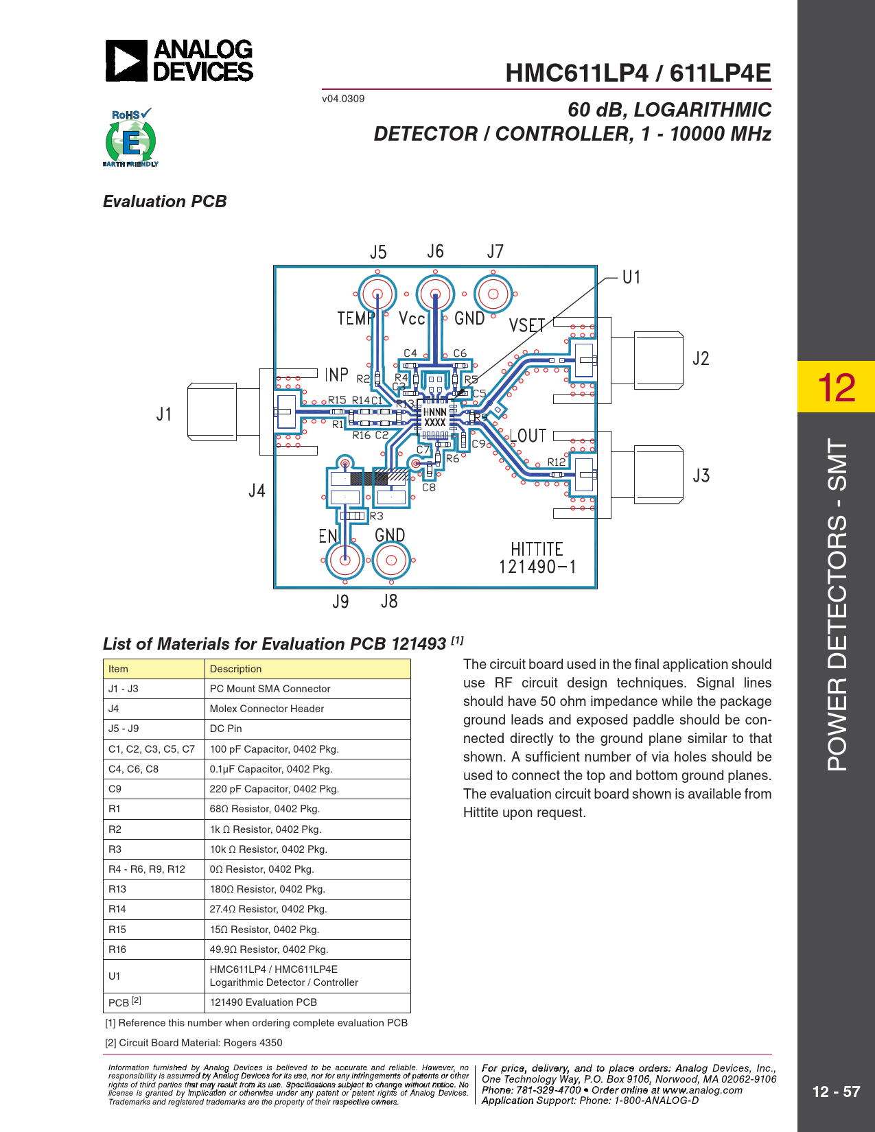

List of Materials for Evaluation PCB 121493 [1]
E The circuit board used in the fi nal application should Item Description use RF circuit design techniques. Signal lines J1 - J3 PC Mount SMA Connector R D should have 50 ohm impedance while the package J4 Molex Connector Header E ground leads and exposed paddle should be con- J5 - J9 DC Pin W nected directly to the ground plane similar to that C1, C2, C3, C5, C7 100 pF Capacitor, 0402 Pkg. O shown. A sufficient number of via holes should be C4, C6, C8 0.1μF Capacitor, 0402 Pkg. P used to connect the top and bottom ground planes. C9 220 pF Capacitor, 0402 Pkg. The evaluation circuit board shown is available from R1 68Ω Resistor, 0402 Pkg. Hittite upon request. R2 1k Ω Resistor, 0402 Pkg. R3 10k Ω Resistor, 0402 Pkg. R4 - R6, R9, R12 0Ω Resistor, 0402 Pkg. R13 180Ω Resistor, 0402 Pkg. R14 27.4Ω Resistor, 0402 Pkg. R15 15Ω Resistor, 0402 Pkg. R16 49.9Ω Resistor, 0402 Pkg. HMC611LP4 / HMC611LP4E U1 Logarithmic Detector / Controller PCB [2] 121490 Evaluation PCB [1] Reference this number when ordering complete evaluation PCB [2] Circuit Board Material: Rogers 4350 Information furnis F heod r pri by An ce, de alog Devi lcievs eir s y b , a eliev nd to pla ed to be accu ce o rate anrder d relia sbl, pl e. H ease co owever, no For price, delivery, and to place orders: Analog Devices, Inc., responsibility is assumed by Analog Devices for its use, nor for any infringements of patents or other ntact Hittite Microwave Corporation: One Technology Way, P.O. Box 9106, Norwood, MA 02062-9106 20 Alpha Road, Chelmsford, MA 01824 Phone: 978 rights of third parties that may result from its use. Specifications subject to change without notice. No Ph - o 25 ne 0 : 7 -3 81- 3 3 4 29 3 F -470 ax: 978 0 • Orde - r o 25 nlin 0- e a3 t 373 license is granted by implication or otherwise under any patent or patent rights of Analog Devices. www.analog.com
