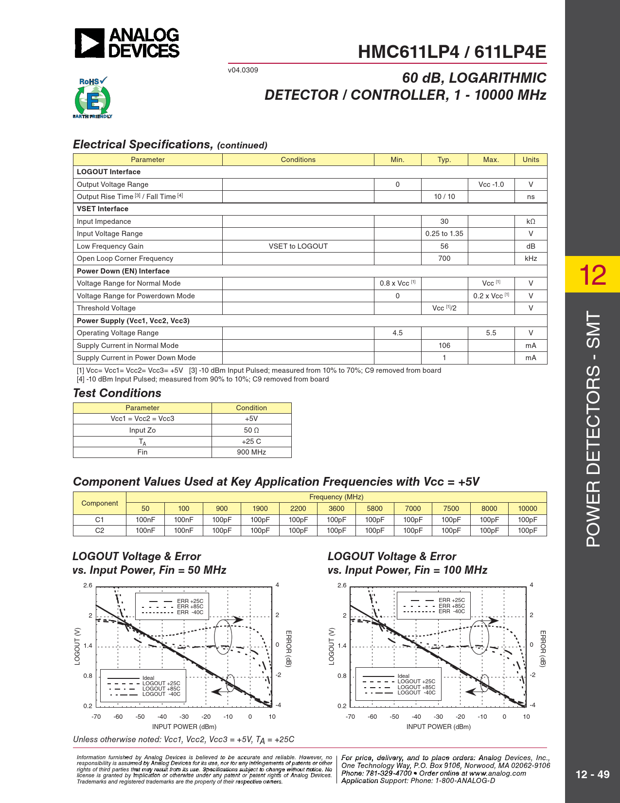

HMC611LP4 / 611LP4E. 60 dB, LOGARITHMIC. DETECTOR / CONTROLLER, 1 - 10000 MHz. Electrical Specifi cations, (continued)
HMC611LP4 / 611LP4E 60 dB, LOGARITHMIC DETECTOR / CONTROLLER, 1 - 10000 MHz Electrical Specifi cations, (continued)
HMC611LP4 / 611LP4E
v04.0309
Parameter Conditions Min. Typ. Max. Units
LOGOUT Interface
Output Voltage Range 0 Vcc -1.0 V Output Rise Time [3] / Fall Time [4] 10 / 10 ns
VSET Interface
Input Impedance 30 kΩ Input Voltage Range 0.25 to 1.35 V Low Frequency Gain VSET to LOGOUT 56 dB Open Loop Corner Frequency 700 kHz
Power Down (EN) Interface
Voltage Range for Normal Mode 0.8 x Vcc [1] Vcc [1] V 12 Voltage Range for Powerdown Mode 0 0.2 x Vcc [1] V Threshold Voltage Vcc [1]/2 V
Power Supply (Vcc1, Vcc2, Vcc3)
T Operating Voltage Range 4.5 5.5 V Supply Current in Normal Mode 106 mA Supply Current in Power Down Mode 1 mA [1] Vcc= Vcc1= Vcc2= Vcc3= +5V [3] -10 dBm Input Pulsed; measured from 10% to 70%; C9 removed from board S - SM [4] -10 dBm Input Pulsed; measured from 90% to 10%; C9 removed from board R
Test Conditions
O Parameter Condition T Vcc1 = Vcc2 = Vcc3 +5V C Input Zo 50 Ω E T +25 C A T Fin 900 MHz E
Component Values Used at Key Application Frequencies with Vcc = +5V
R D Frequency (MHz) Component E 50 100 900 1900 2200 3600 5800 7000 7500 8000 10000 C1 100nF 100nF 100pF 100pF 100pF 100pF 100pF 100pF 100pF 100pF 100pF W C2 100nF 100nF 100pF 100pF 100pF 100pF 100pF 100pF 100pF 100pF 100pF O P
LOGOUT Voltage & Error LOGOUT Voltage & Error vs. Input Power, Fin = 50 MHz vs. Input Power, Fin = 100 MHz
2.6 4 2.6 4 ERR +25C ERR +25C ERR +85C ERR +85C ERR -40C ERR -40C 2 2 2 2 ERROR (dB) ERROR (dB) 1.4 0 1.4 0 LOGOUT (V) LOGOUT (V) 0.8 -2 Ideal -2 Ideal 0.8 LOGOUT +25C LOGOUT +25C LOGOUT +85C LOGOUT +85C LOGOUT -40C LOGOUT -40C 0.2 -4 0.2 -4 -70 -60 -50 -40 -30 -20 -10 0 10 -70 -60 -50 -40 -30 -20 -10 0 10 INPUT POWER (dBm) INPUT POWER (dBm) Unless otherwise noted: Vcc1, Vcc2, Vcc3 = +5V, TA = +25C Information furnis F heod r pri by An ce, de alog Devi lcievs eir s y b , a eliev nd to pla ed to be accu ce o rate anrder d relia sbl, pl e. H ease co owever, no For price, delivery, and to place orders: Analog Devices, Inc., responsibility is assumed by Analog Devices for its use, nor for any infringements of patents or other ntact Hittite Microwave Corporation: One Technology Way, P.O. Box 9106, Norwood, MA 02062-9106 20 Alpha Road, Chelmsford, MA 01824 Phone: 978 rights of third parties that may result from its use. Specifications subject to change without notice. No Ph - o 25 ne 0 : 7 -3 81- 3 3 4 29 3 F -470 ax: 978 0 • Orde - r o 25 nlin 0- e a3 t 373 license is granted by implication or otherwise under any patent or patent rights of Analog Devices. www.analog.com
