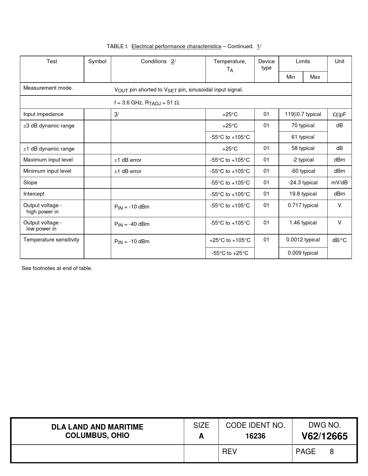

TABLE I. Electrical performance characteristics – Continued. 1/ Test Symbol Conditions 2/ Temperature, Device Limits Unit T type A Min Max Measurement mode. VOUT pin shorted to VSET pin, sinusoidal input signal. f = 3.6 GHz, RTADJ = 51 Ω. Input impedance 3/ +25°C 01 119||0.7 typical Ω||pF ±3 dB dynamic range +25°C 01 70 typical dB -55°C to +105°C 61 typical ±1 dB dynamic range +25°C 01 58 typical dB Maximum input level ±1 dB error -55°C to +105°C 01 -2 typical dBm Minimum input level ±1 dB error -55°C to +105°C 01 -60 typical dBm Slope -55°C to +105°C 01 -24.3 typical mV/dB Intercept -55°C to +105°C 01 19.8 typical dBm Output voltage - PIN = -10 dBm -55°C to +105°C 01 0.717 typical V high power in Output voltage - PIN = -40 dBm -55°C to +105°C 01 1.46 typical V low power in Temperature sensitivity PIN = -10 dBm +25°C to +105°C 01 0.0012 typical dB/°C -55°C to +25°C 0.009 typical See footnotes at end of table.
