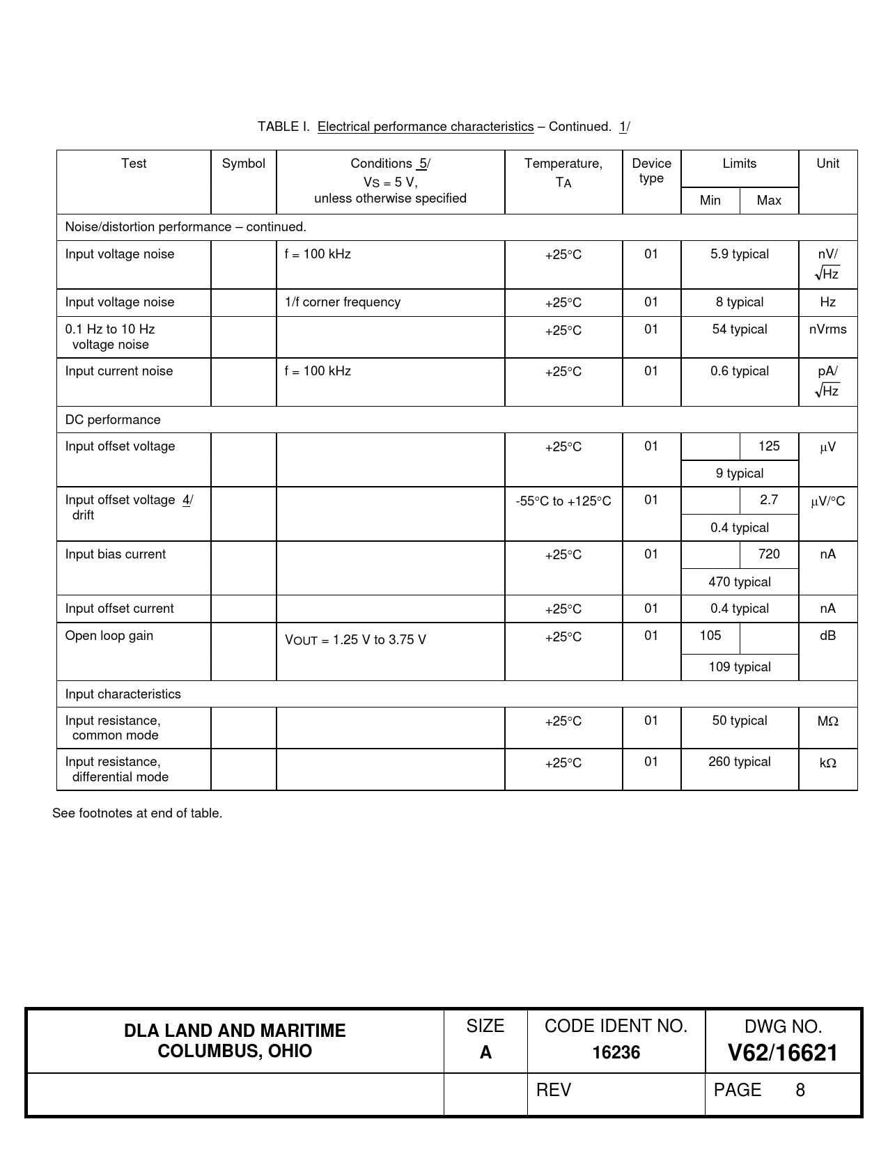

TABLE I. Electrical performance characteristics – Continued. 1/ Test Symbol Conditions 5/ Temperature, Device Limits Unit VS = 5 V, TA type unless otherwise specified Min Max Noise/distortion performance – continued. Input voltage noise f = 100 kHz +25C 01 5.9 typical nV/ Hz Input voltage noise 1/f corner frequency +25C 01 8 typical Hz 0.1 Hz to 10 Hz +25C 01 54 typical nVrms voltage noise Input current noise f = 100 kHz +25C 01 0.6 typical pA/ Hz DC performance Input offset voltage +25C 01 125 V 9 typical Input offset voltage 4/ -55C to +125C 01 2.7 V/C drift 0.4 typical Input bias current +25C 01 720 nA 470 typical Input offset current +25C 01 0.4 typical nA Open loop gain VOUT = 1.25 V to 3.75 V +25C 01 105 dB 109 typical Input characteristics Input resistance, +25C 01 50 typical M common mode Input resistance, +25C 01 260 typical k differential mode See footnotes at end of table.
