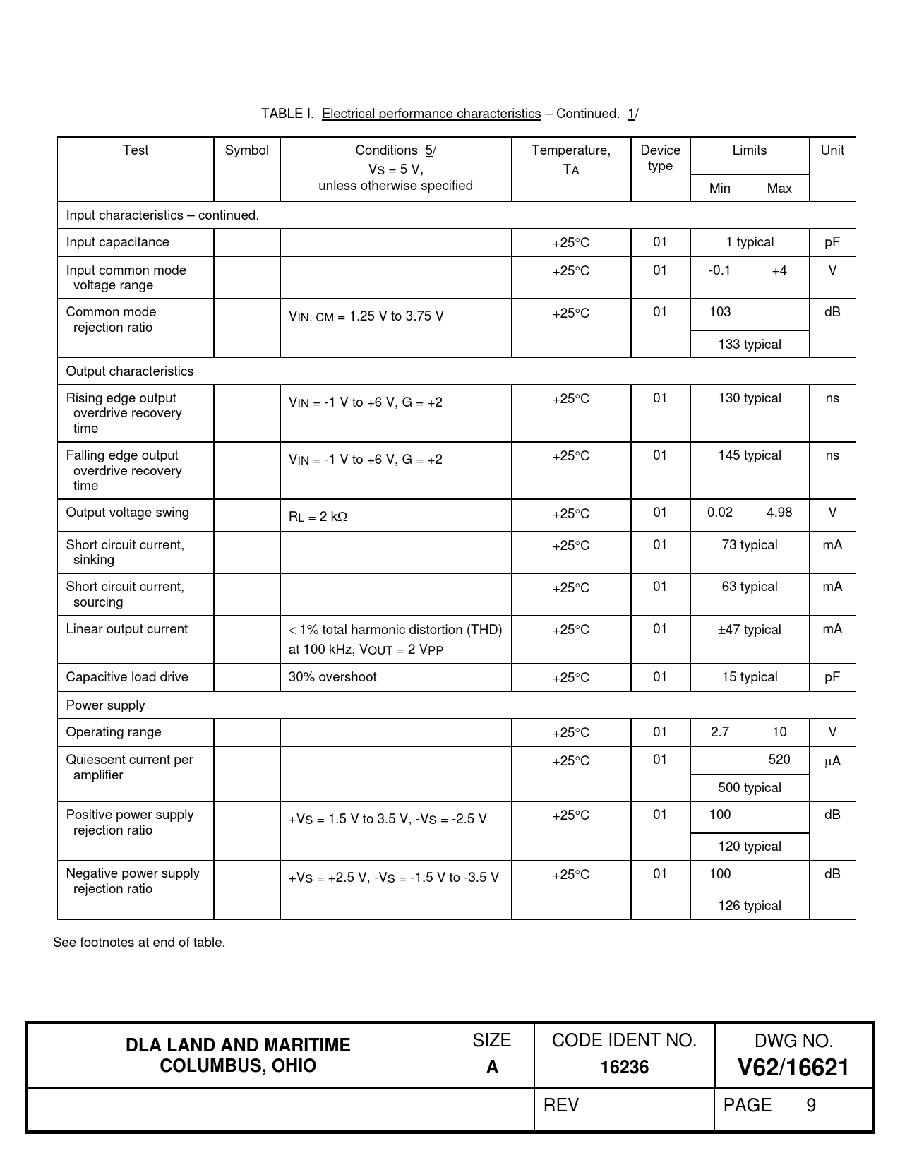

TABLE I. Electrical performance characteristics – Continued. 1/ Test Symbol Conditions 5/ Temperature, Device Limits Unit VS = 5 V, TA type unless otherwise specified Min Max Input characteristics – continued. Input capacitance +25C 01 1 typical pF Input common mode +25C 01 -0.1 +4 V voltage range Common mode VIN, CM = 1.25 V to 3.75 V +25C 01 103 dB rejection ratio 133 typical Output characteristics Rising edge output VIN = -1 V to +6 V, G = +2 +25C 01 130 typical ns overdrive recovery time Falling edge output VIN = -1 V to +6 V, G = +2 +25C 01 145 typical ns overdrive recovery time Output voltage swing RL = 2 k +25C 01 0.02 4.98 V Short circuit current, +25C 01 73 typical mA sinking Short circuit current, +25C 01 63 typical mA sourcing Linear output current  1% total harmonic distortion (THD) +25C 01 47 typical mA at 100 kHz, VOUT = 2 VPP Capacitive load drive 30% overshoot +25C 01 15 typical pF Power supply Operating range +25C 01 2.7 10 V Quiescent current per +25C 01 520 A amplifier 500 typical Positive power supply +VS = 1.5 V to 3.5 V, -VS = -2.5 V +25C 01 100 dB rejection ratio 120 typical Negative power supply +VS = +2.5 V, -VS = -1.5 V to -3.5 V +25C 01 100 dB rejection ratio 126 typical See footnotes at end of table.
