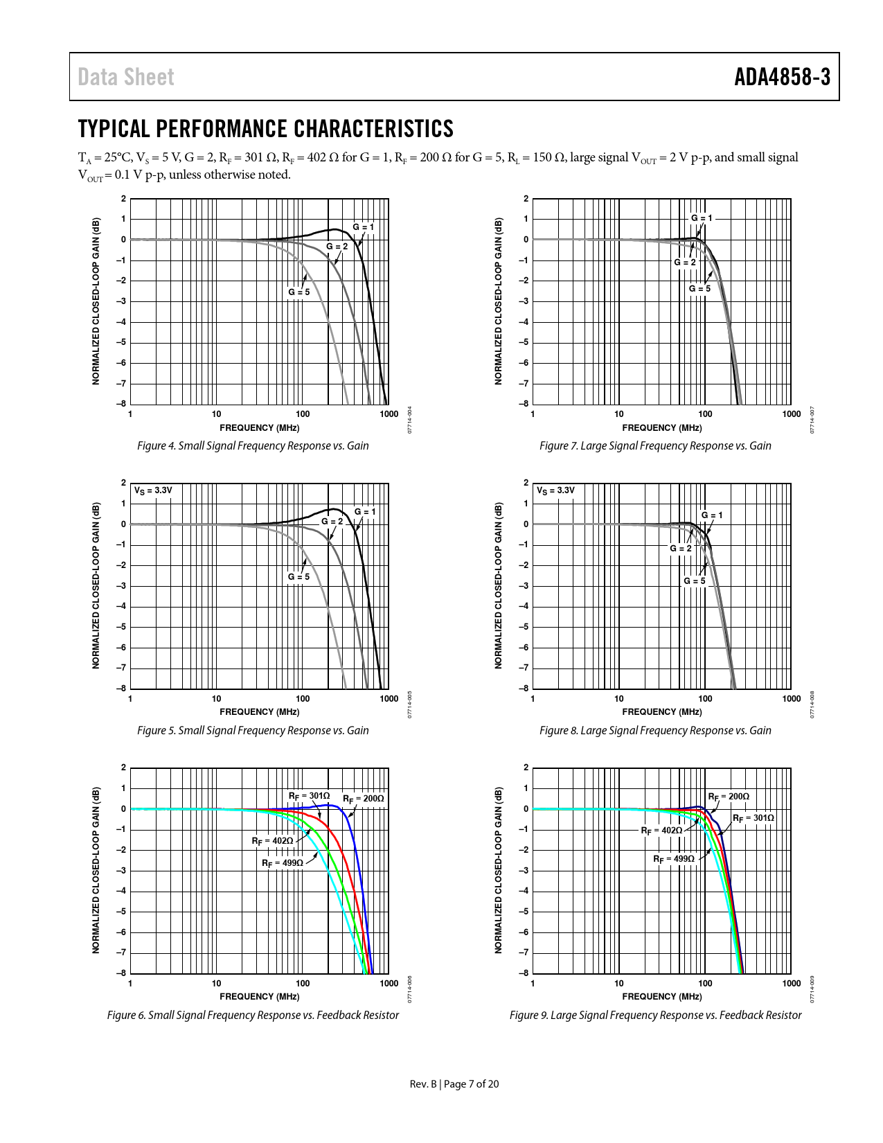

Data Sheet ADA4858-3 TYPICAL PERFORMANCE CHARACTERISTICS
TA = 25°C, VS = 5 V, G = 2, RF = 301 Ω, RF = 402 Ω for G = 1, RF = 200 Ω for G = 5, RL = 150 Ω, large signal VOUT = 2 V p-p, and small signal VOUT = 0.1 V p-p, unless otherwise noted.

07714- 07714- Figure 4. Small Signal Frequency Response vs. Gain Figure 7. Large Signal Frequency Response vs. Gain

07714- 07714- Figure 5. Small Signal Frequency Response vs. Gain Figure 8. Large Signal Frequency Response vs. Gain

07714- 07714- Figure 6. Small Signal Frequency Response vs. Feedback Resistor Figure 9. Large Signal Frequency Response vs. Feedback Resistor Rev. B | Page 7 of 20 Document Outline Features Applications General Description Connection Diagram Table of Contents Revision History Specifications Absolute Maximum Ratings Maximum Power Dissipation ESD Caution Pin Configuration and Function Descriptions Typical Performance Characteristics Theory of Operation Overview Charge Pump Operation Applications Information Gain Configurations DC-Coupled Video Signal Multiple Video Driver DC Restore Function Clamp Amplifier PD (Power-Down) Pin Power Supply Bypassing Layout Outline Dimensions Ordering Guide
